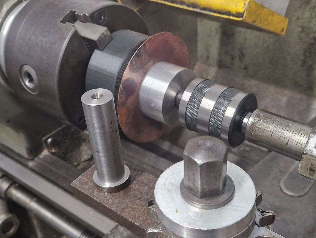

            Following comments from people, I thought I would try spinning, also having been to Weeting rally last weekend I felt the casting was also to large. I 3D printed a former, with 50% infill for strength, but low quality, it still took 9 hours to print. I ordered a few 0.5mm discs, annealed one and had a go at spinning. I bit of a bodge for the tool post, if I was doing more, I would make something better.

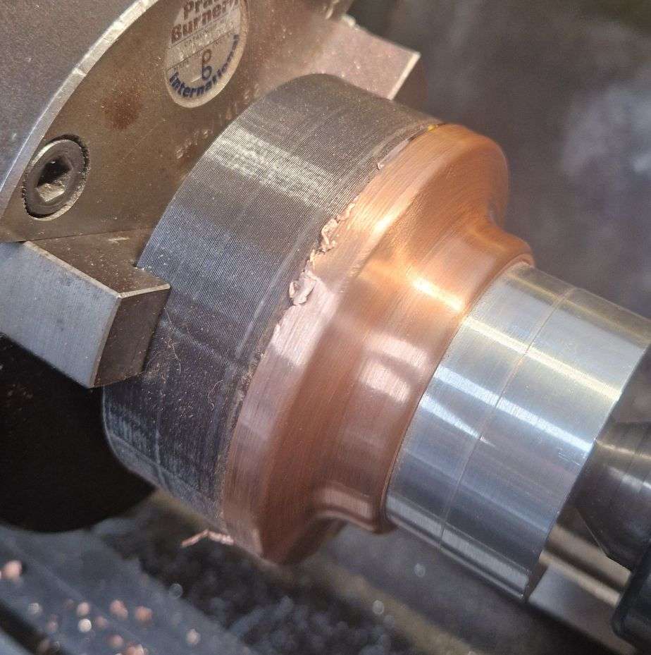

            ChimneyCap1
            For some reason the former didn’t spin true, I should have put it in the 4-jaw, but didn’t, this caused an issue when I trimmed the end where it picket up, but recoverable, with a bit of filing.

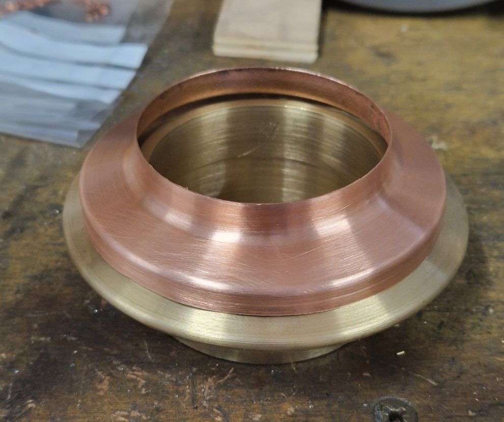

            ChimneyCap2
            After a bit of cleaning up the edge with a file, this is the result of the top half, with enough material to fold over the bottom half. It is sat on the original casting.
            ChimneyCap3
            Once I have done the bottom half, I will decide if I am happy with it, I may remake it in 0.8mm copper if it doesn’t seem solid enough.

              If you did decide to make in two parts, soft solder is unlikely to withstand the plating process.
              (Our plating shop would not consider anything united bt soft solder, only silver soldered or brazed.)
              Even if it did, if any shows, it will look different from the copper body / plate.
              Brazing would be a better way of uniting the two different metals
              Copper Sulphate will be a good electrolyte, from which to electroplate.
