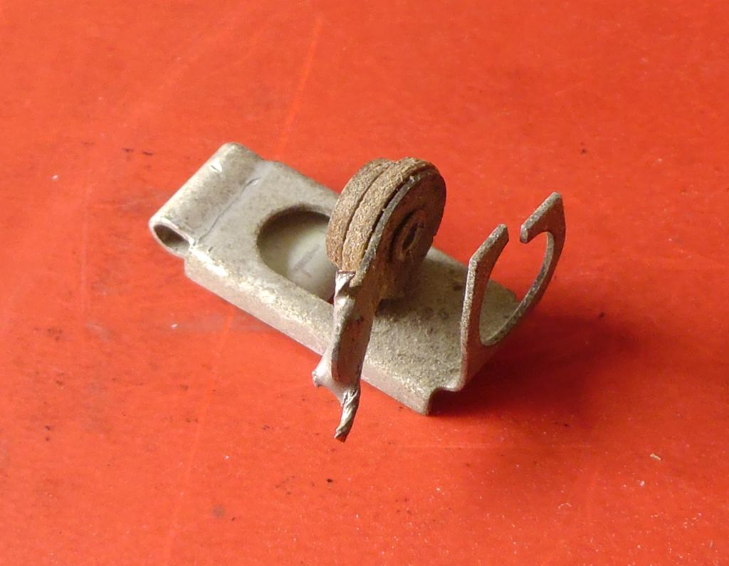

                        I obviously don't know exactly what you're doing or the standard and appearance you want the holders to be, but Edison screw lamp fittings can be very simple and still work very well as an ES10 holder I removed from an old radio shows.
                        #421849
                        Phillip Allen
                          @phillipallen34597
                          Sandgrounder, I see where you are coming from. Drill a hole, light countersink on both sides to remove square edge, file a small notch and put a slight twist on the hole, down on one side of the notch and up on the other. A few experiments and I believe I have a solution. Thanks very much.

                                Thats all it is, very simple and if you do have a go at something similar I've just measured it and the material is 0.6mm thick and a bit springy, so something perhaps like nickel silver sheet would be best but I've never worked with it so can't advise, but it is used a lot in electrical contacts etc or some grade of brass sheet?
