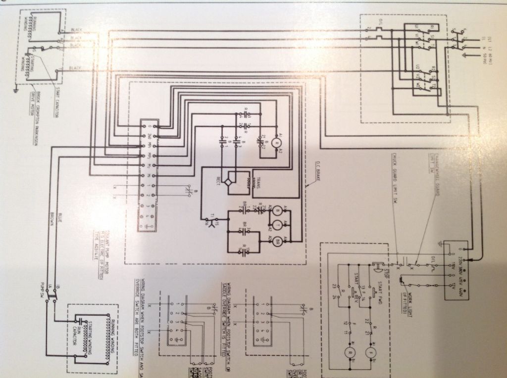

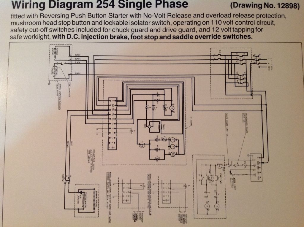

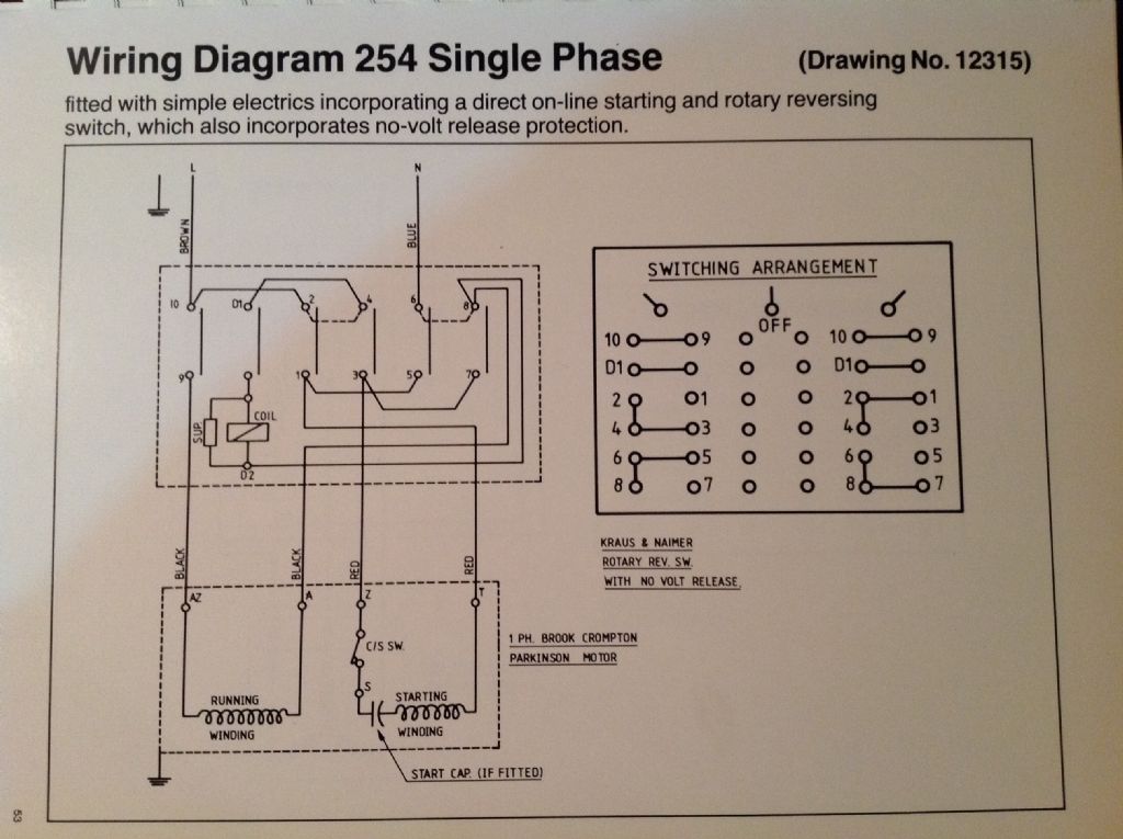

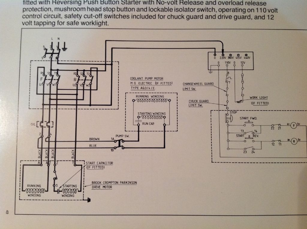

                              #146874
                              Richie M
                                @richiem
                                Myford 254 wiring diagram 3Myford 254 wiring diagram 2Myford 254 wiring diagram 1
                                #146875
                                Richie M
                                  @richiem
                                  Sorry I hope I haven't upset Chris!
                                  Here are the 254 single phase diagrams.
                                  if you need any other info please ask!
                                  Cheers
                                  Richie
                                  #146876
                                  Richie M
                                    @richiem
                                    Drawing 98Another go at drawing 12898, hopefully a little bit clearer.

                                        Hi Richie,
                                        Many thanks for posting the schematics. I have added them to my folder of Myford information.
                                        Chris, If my understanding of the test you have done is correct the I am almost certain there is leakage between the transformer primary winding and earth. I suspect the transformer will be about 100 VA rating. This is a conservative estimate allowing for a 50 watt light on the 12 volt winding and 50 watts for the contactor coils. If there is space it may be cheaper to use a 12 volt lighting transformer for the light and a separate transformer for the 110 volts.
                                        Les.

                                                  #147046
                                                  Chris Barry
                                                    @chrisbarry
                                                    Hi everyone,
                                                    Checked the micro switches and powering it up with the spindle stop pressed and it's come back to life. No idea what I've done to make it so, not tried drying it out and it's significantly damper today than it has been all week.
                                                    Yet again electrics prove to my simple spanner monkey mind that it's all black magic and whitch craft.
                                                    Thanks for all your help, have saved all this thread in case I get problems again.
