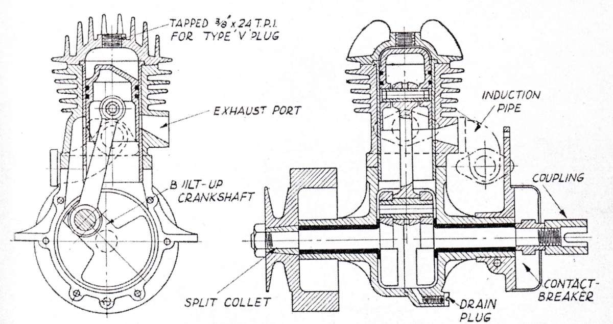

      Twenty five or so years ago I acquired a part finished Phoeinix IC engine by E T Westbury and have been working on it off and on since. It’s almost finished and I have a question for the IC grus. In his description, he states that the driving coupling can be fitted to either end of the crankshaft provided that the engine is arranged for the appropriate direction of rotation, which should always be with the crank pin moving upwards on the transfer port side. My question is why is this?
      The only reason I can think of is for an unimpeded flow of crankcase charge through the transfer port up into the cylinder, as if rotation is the other way the con rod would be moving down through the transfer port as the piston descends pushing the crankcase charge up through the transfer port into the cylinder. Any ideas?

      #722792
        I thought it was so that the coupling is not unscrewed by the crankshaft rotation so engine rotation needs to be arranged so crankshaft is always being screwed into the coupling when under load.
        #722808
        Perko7
          @perko7
          It could be to do with the way the centreline of the cylinder is offset from the crankshaft (the Desaxe Principle) which I understand helps with improved efficiency and operation of 2-stroke engines. To run the engine in the opposite direction without a corresponding alteration to the crankshaft location would negate these benefits.
          #722814
          bernard towers
            @bernardtowers37738
            Exactly, well done Perko you beat me to it!
            #722817
            John Purdy
              @johnpurdy78347
              I just realized I think it is as, Perko says, because the cylinder is offset away from the transfer port. But I think the reason might be more to do with the angularity of the con rod to crank pin being less on the downward power stroke with the crank pin going down opposite the transfer port as opposed to going down on the transfer port side. Thus less stress on the con rod and crank pin.

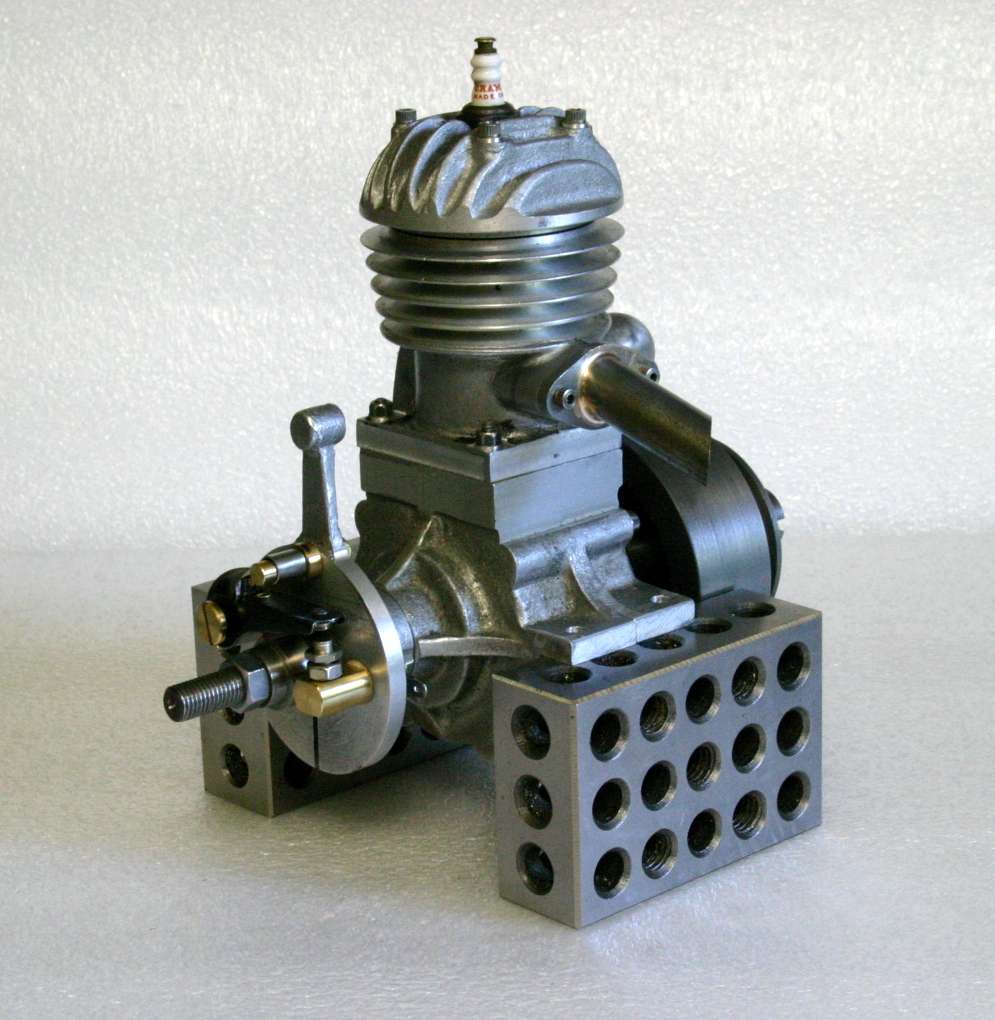

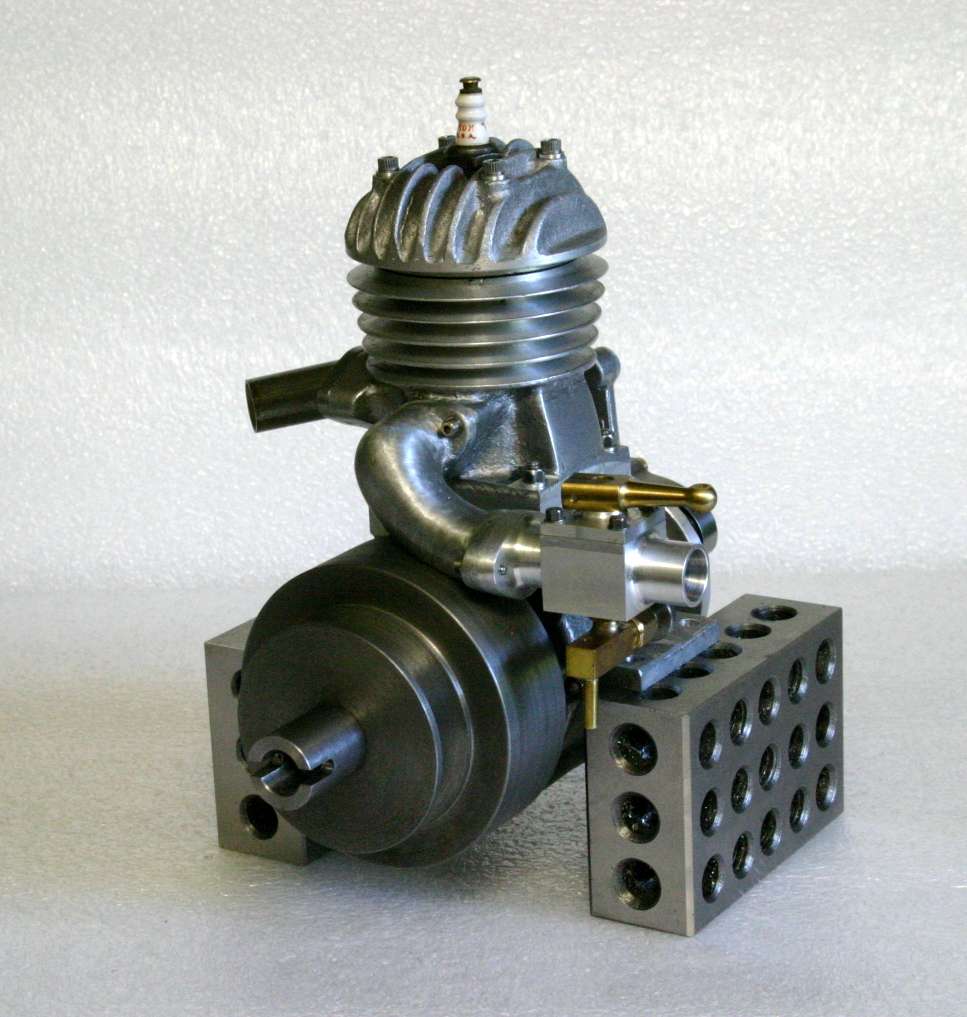

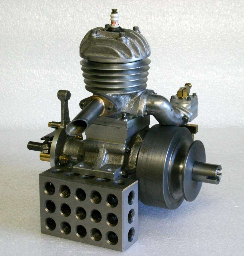

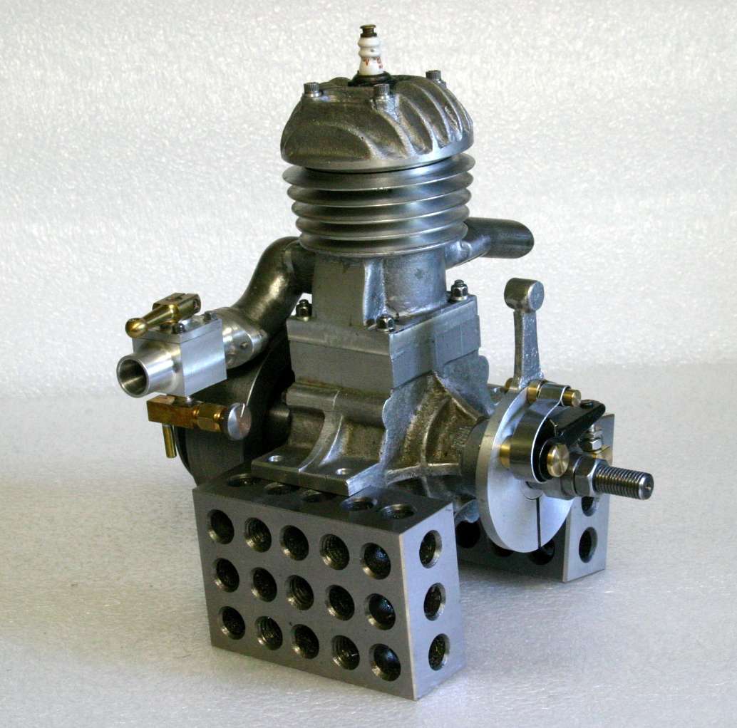

              John Purdy
                @johnpurdy78347
                The Pheonix is finally finished! It might have been started circa 1969 by a Mr. W. Coubrey in Victoria BC (then again, he might have got it part built as I did!). Haven’t tried to run it yet, have to dig out my old “Sparky” model aircraft ignition coil and rig up some sort of test stand.
                Pheonix 4
                Pheonix 5
                Pheonix 6
                Phionix 7
                #734736
                bernard towers
                  @bernardtowers37738
                  Looks good ,you could try glow Plug start with to see if timing etc is close.

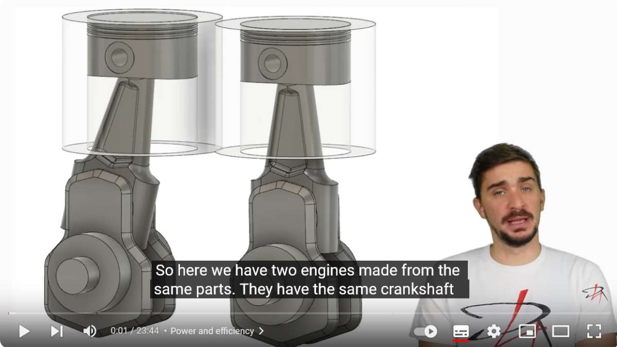

                        Ches Green UK
                          @chesgreenuk
                          As Hopper notes, Offset Cylinders have some very interesting characteristics.
                          By coincidence, I was watching this informative video (24 mins) on the subject the other day … Cylinder Offset Changes Everything – https://www.youtube.com/watch?v=gwtZkHoVMso
