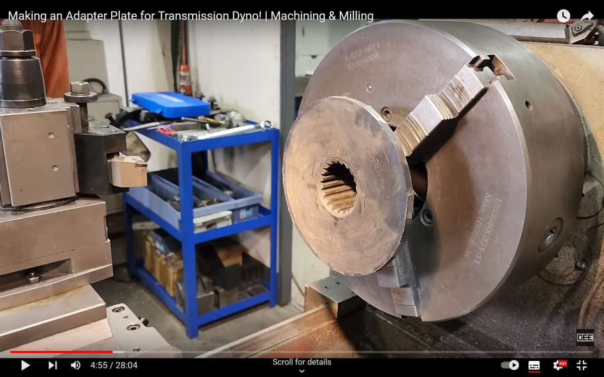

          I wonder if it is a forged part, so perhaps has no sufficiently clockable surfaces?
          flex plate 2
          Also, by the time it is properly seated in to the chuck (3 or 4 jaw) there may be no access to a properly round surface?
          Ches
          #713492
            Just to clarify my thinking, Ches
            The unit had been bought secondhand, with the specific intention of re-using the female splines … presumably saving $$$ in the process.
            I have no idea how commonly these are available, or at what price.
            Also, I do not have his workshop or his accumulated experience !
            Being ‘risk averse’ in such situations … I would have focused my attention on the splines and tried to ensure the best concentricity possible.
            Using a four-jaw; a simple stub-mandrel might have helped … or, as I commented, clocking the splines … but relying on a three-jaw for concentricity was a surprise.
            I suspect that he actually knew significantly more about the unit than is shown in the video [the dismantling looked very easy!],  and had probably pre-checked the concentricity.

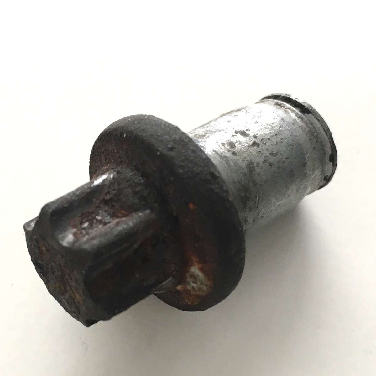

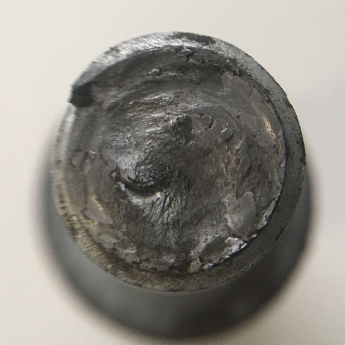

                Returning to the BMW
                Here are a couple of quick snapshots of a sheared bolt:
                IMG_9339.
                IMG_9340
                … That end view probably ‘speaks volumes’ to those fluent in  the language.
                These are nominally M12 bolts and I measured the plain shank as 11.88mm
                All of the locking effect seems attributable to corrosion within and/or beyond the tapped hole.
                ? spoiling the ship for a ha’porth of tar Duralac ?
                Yes, I know … they couldn’t produce mass-market cars with that much attention to detail.

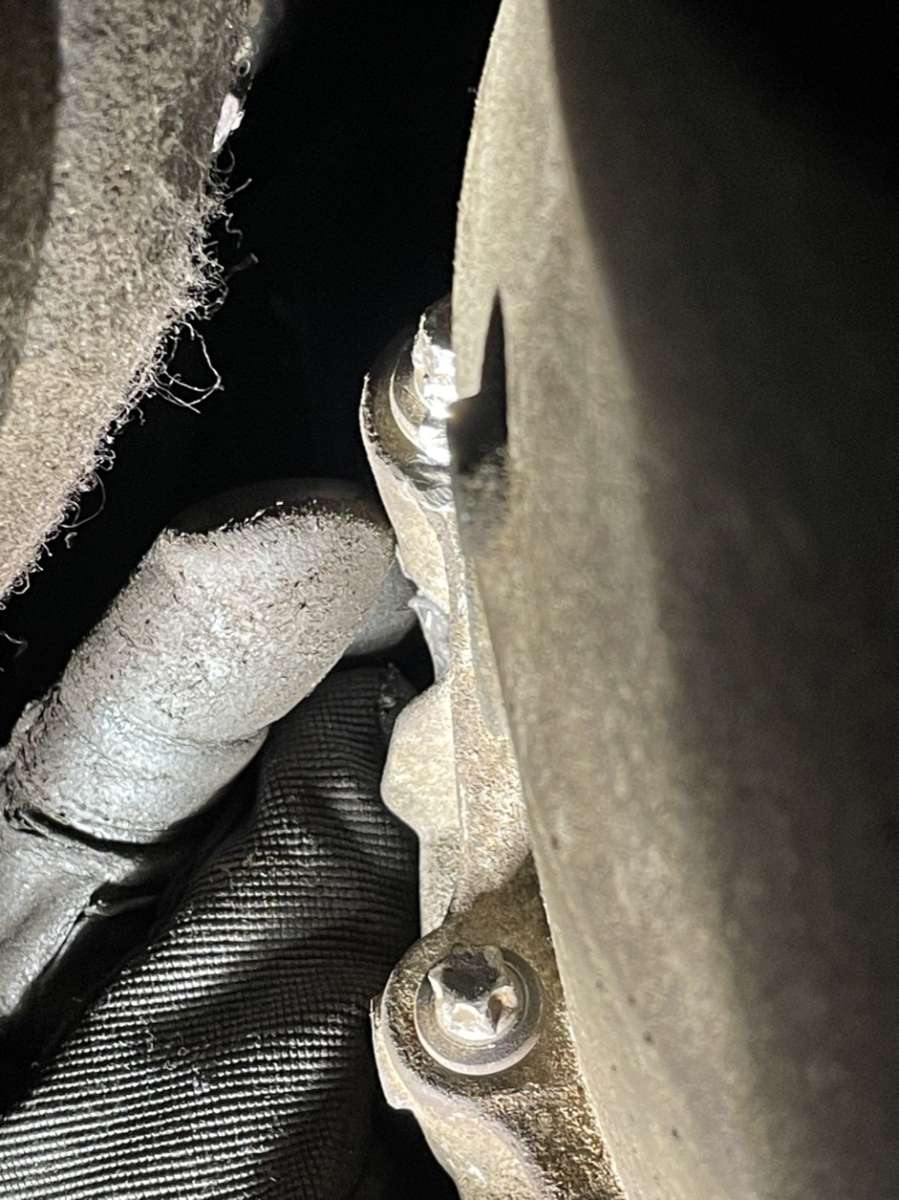

                  #713584
                    This is a little difficult to interpret, but I am posting it anyway:
                    IMG_9342
                    The black ‘tube’ and the striped fabric are the thumb and palm of the mechanic’s left glove
                    The smaller “male torx head” is one of several locating screws
                    Towards the top is one of the heavier M12 fixings … and there is another, higher-up on the bell-housing !!
                    Hence the need to drop the engine by about 6”
                    The hairy stuff to the left of the picture is on the inside of the tunnel
                    I am very glad I didn’t try to do this job on my driveway !
                    #713764
                    Howard Lewis
                      @howardlewis46836
                      Maybe the bolts failed in torsion caused by an overload trying to break koose threads that had corroded?
                        Exactly my thoughts, Howard
