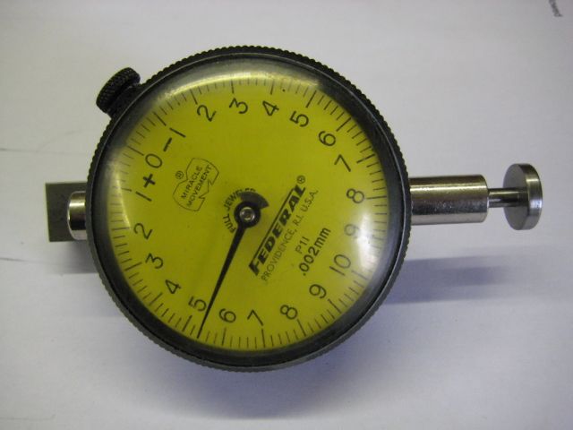

            I made this elephant's foot to enable the accurate tracking of curved or circular items whilst being set-up to run parallel to the axis of the lathe or mill. It has a permanent flat mounting bar to fit a Dixon type tool holder. The diameter of the foot is approx.12mm. As Michael G says it need to be accurately made.
            I turned mine in one setting on my Hobbymat lathe by reducing the end, threading it and finally parting off carefully. The Hobbymat is brilliant at parting off. The business end was then polished by rubbing it on fine wet & dry on a surface plate.

                That looks a neat challenge for a 'coarse engineering' type like me!
                Flatness I can test, but how can you check the 'foot' is at right angles to the axis or do you have to depend on the accuracy of machining?

                  Put the foot very close to the table and attempt to put a feeler gauge under it in different places and read any differences on the dial.

                      I wonder just how important the accuracy of the elephant's foot really is. Its convenience arises AIUI from the fact that it is easier to make it sit on a round bar in the chuck, but once it is sitting there the part of the base in contact with the bar would not change much, if at all. Since the indicator is almost always being used as a zero checker (for runout), would it work any less effectively is it was slightly on the skew? I don't know the answer, I'm just suspicious of some of these frequently quoted "rules" – just like the one about the effect of tool centre height when cutting a taper.

                          Dunno, and it's too late to start doing the maths, but likewise I suspect that it isn't critical. When I made an elephants foot for my DTI I turned the outer diameter, shoulder and spigot for the thread in one go. Thread (6BA) was put on with a die, aiming for a loose fit. Part off and then face off and tap a 6BA hole in a rod in the collet chuck. Without removing the rod, screw the elephant foot into place and face across the bottom. I reckon that should get the bottom face parallel to the top to reasonable accuracy along with a good finish. Worked for me anyway, the Morse taper that I ground using the elephants foot to confirm the taper with a sine bar was a pretty good fit in its socket.
