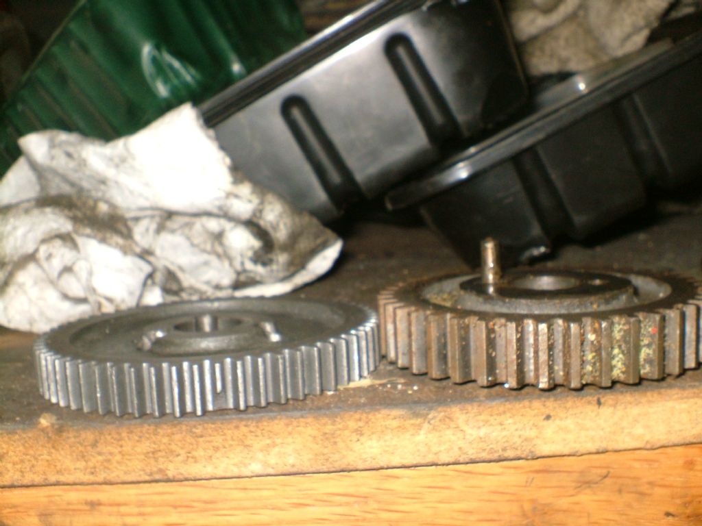

      I've never come across proper Drummond change gears until recently and they are absolutely massive compared to the Myford gears I have been using over the last 10 years
      About 50% thicker than myford ones they look more like the gears out of a gearbox from a car and have a very solid run-all-day industrial look about them

          The small Drummond lathes (apart fron the Roundbed) were military spec industrial lathes . The Myford ML 1,2,3,4, series were all hobby machines built to a price. The Myford M Type being the exception because it was a Drummond design. The M Type is built like a brick s/h compared to an ML7 and the cost of manufacturing the M was what prompted the introduction of the more more versatile but built to a price ML7.

                Drummond gear teeth are that big because if they were any smaller they'd lose teeth. They come from an era before advances in cast iron metallurgy made it as versatile as it is today.
                I'm not saying they couldn't do it for higher-end machines etc but I think that the £5 lathe budget stretched to more iron but not more technology. It's common to see busted teeth on lathes of this era, these days not so much.

                    Are they not different pressure angles ? I thought Drummond was 14.5 degrees and Myford 20.

                        Indeed – be careful not to mix Drummond and Myford change-wheels. Basically, they won't!
                        I don't pretend to unsertdnad the trigonometry of gear design but do know from various reputable sources as well as simple logic that even if the DPs match, gears of different pressure-angles will not mesh properly.

                            According to the myford Ltd website all their lathes are 14.5 degrees Pa.

                                I believe that the Drummond gears are 14DP whereas the Myford 7 series ones are 20DP.
                                As Lee stated above you can compound gears of different DP on the same shafts and indeed take advantage of the reduced diameter of higher DP gears if the banjo is of limited size.

                                  Myford say that they are all 14.5 degree across their range.  Would make sense for stockholding, plus it locks their customers into Myford spares when most commercial gears are made to 20 degrees.  Helps to explain why their accessories are so ridiculously expensive.

                                    I would think that most machines made in the ‘40/‘50s (and likely all machines pre-WWII?) would have used 14 1/2 PA. Little point in Myford having a mix of otherwise interchangeable gears on their inventory/spares list. One could imagine the mixtures of gears fitted by the un-knowing hobbyists.
                                    My lathe make, that was produced in three guises from the 1940s, are all 14 1/2 degree PA, even though the DP was changed during the times of production (until the early ‘70s).
