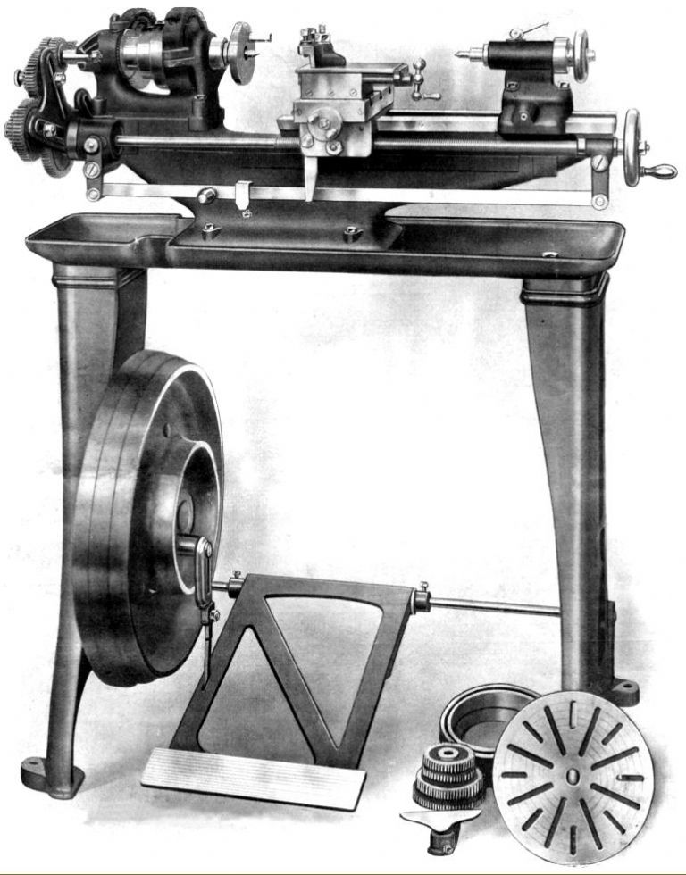

      Can anyone help me with fitting a loop type pitman to a Drummond treadle please? I have asked on the Drummond forum and got no reply.
      This is a picture of the treadle on an M type, taken from Tony Griffith's site,

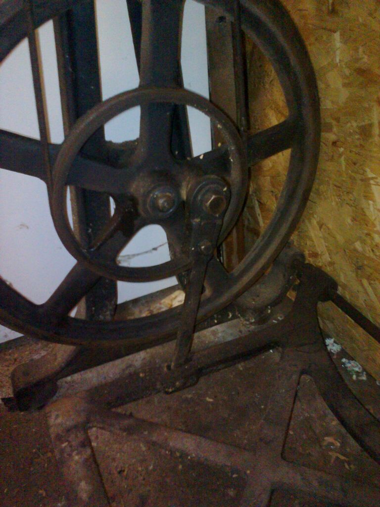

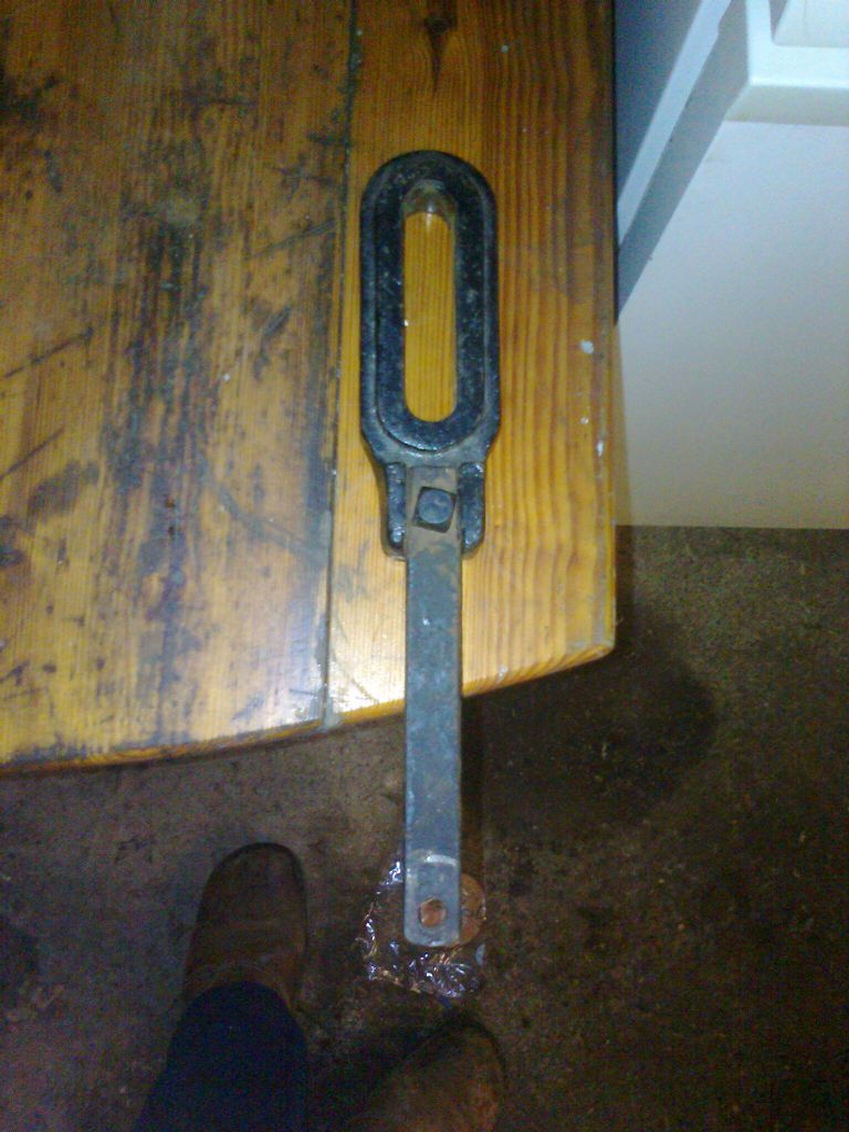

      This is the pitman that I have got:
      If I bolt this on tight to the flywheel then it locks up, if loose then it will flop from end to end.

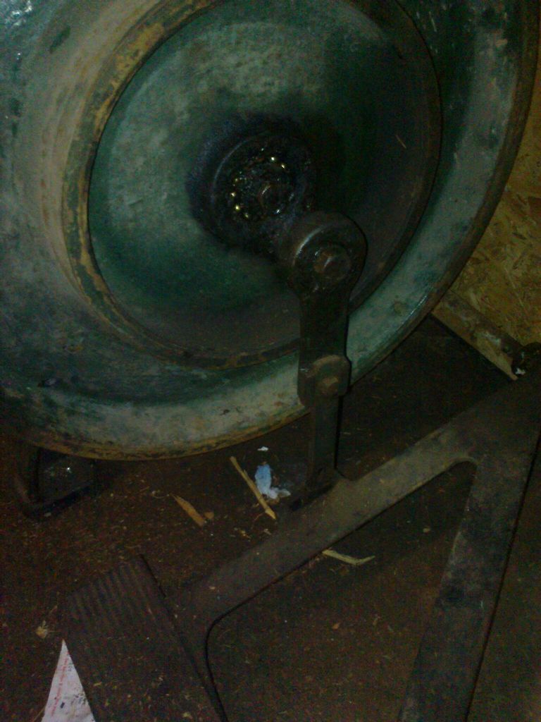

      My question is; how do I fit it on please? My scroll bed and M Type pitmans are round topped so have a bush and a bearing respectively which just fit on over the flywheel pin:
      Many thanks in anticipation.

          An early example of HSE. If your foot gets under the treadle while it is still spinning you don't get crushed toes. I expect it is supposed to bolt through a 'top hat' sleeve to maintain the free movement. Mine is dissassembled in boxes underneath stuff etc at the moment so can't be more helpful.

            Thank you for the swift response. The problem with the top hat idea is that the flywheel pin is nearly the same diameter as the hole…on all three treadles and that spans 1908 to 1927. It could be very thin I suppose…

              Very long time since I looked at anything like that but my recollection is that the pin was a nice sliding fit in and just a touch longer than the thickness of the pitman link. Large washer under the head of the bolt stopped things falling off but the difference between pin length and pitman thickness presumably stopped things binding up. So far as I know it all worked but my involvement was simply rooting through stores to find a suitable bolt and washer to replace the originals which had gone AWOL.
              To save trying to thin the pitman down I guess a stepped, double diameter, washer could be made with the inner part a bit under pin diameter and deep enough to create clearance between the larger, retaining, part and the link. That would not to interfere with sliding.

                              The way to fit the Pitman would be the loose way that you mention, this way means thatas you peddle the power is on the down stroke, and if you stop peddling the treadle can stop while the flywheel still rotates, its a simple freewheel system. The woodn pitman on the Daisy Reaper, and other horse drawn mowers was/ is the best choise, because if you use the steel one there's no end of damage that will happen further down the mechanisim. Go round a lot of farm sheds near here in Canterbury, and you will find spares hanging on nails, and the odd broken one too, even though the mower has long gone, although a good number have been restored. Ian S C

                                  Your idea sounds good Ian, I will just have to follow Nobby's example and turn the flywheel by hand to get to the forward stroke.
                                  It has been too cold, and I have been too short of time to experiment, but I will let you know at the weekend how it all pans out. I am a bit nervous of the possibility of the continuous clonking that might happen.

                                    The one in your second picture appears to be pivoted in the middle, presumably to give the same 'safety' effect. I can't see why they couldn't just use a bit of rope
                                    Anyone here remember treadle sewing machines? My Dad got my Mum an electric one to replace her treadle one, and she made him get her a manual conversion kit – a geared handle that engaged the flywheel!
                                    #115294
                                    AndyB
                                      @andyb47186
                                      Hi Neil,
                                      They are all rigid in the same way that the loop one is; a steel strap bolted to an iron casting. But thanks for the thought.
