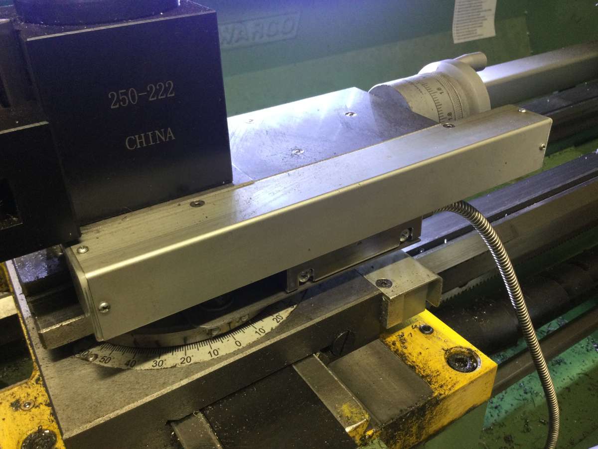

                          The main issue is the cross slide, fit it to the right hand side and you loose access to teh cariage lock and the tailstock can’t get as close so excessive overhangs. Put it on the left and it means more tool stick out when machining large diametes, right wher all the muck is etc This applies to glass and to a slightly lesser degree magnetic once the covers are on.
                          There is not too much modification needed to fit a magnetic strip under the cross slide and a small rear extension can take a mini read head. There is a thread on the subject here somewhere and that is the way I would go to avoid all the problems mentioned above.
                          May also put a third one on the topslide and have a consol that does summing so whether you move the carriage or the topslide when set parallel the single line on teh consol gives tool position.

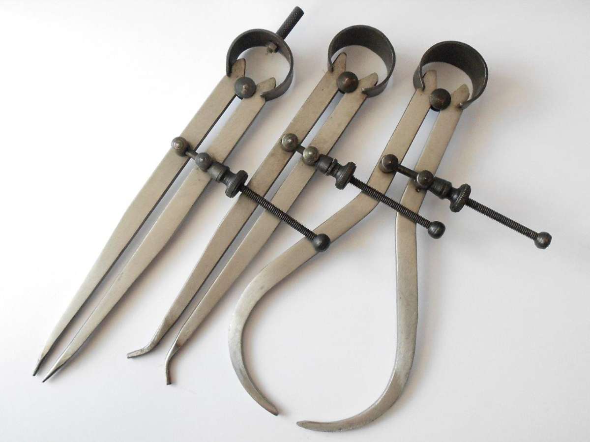

                            Is a DRO necessary for accuracy at all?  Or is extreme accuracy itself necessary? Rarely in my workshop.
                            Whilst DROs and Digital Calipers are a huge convenience and time-saver, I mostly work by fitting.  I do not bore a hole ⌀20mm ±0.02  and then turn a shaft ⌀19.90mm ±0.01 so the two will go together without further ado!  More likely I will bore the hole to about ⌀20mm, and then turn the shaft to a little over that.   Then, using the hole as a gauge, I shave down the shaft step-by-step until it achieves the required fit.    There is no need to measure anything accurately.  Usually shave down with a single point tool and then finish with emery paper.  Emery paper removes tiny amounts of metal, allowing even crude machine tools to achieve high-accuracy / close fits when needed.
                            Experimenting with old-school techniques is interesting if there’s nothing urgent on hand.  Although it takes longer, and the resulting parts aren’t interchangeable, fitting with nothing more than a plain spring caliper works surprisingly well without measuring. Better made versions available:
                            SpringCaliperSetsmall
                            I’ve found answers to Dalboy’s topic most useful.  Things have moved on since I fitted a DRO 10 years ago, in particular magnetic scales are now an affordable option.   As we have the same lathe, if Dalboy reports what he installs, I might well copy him!

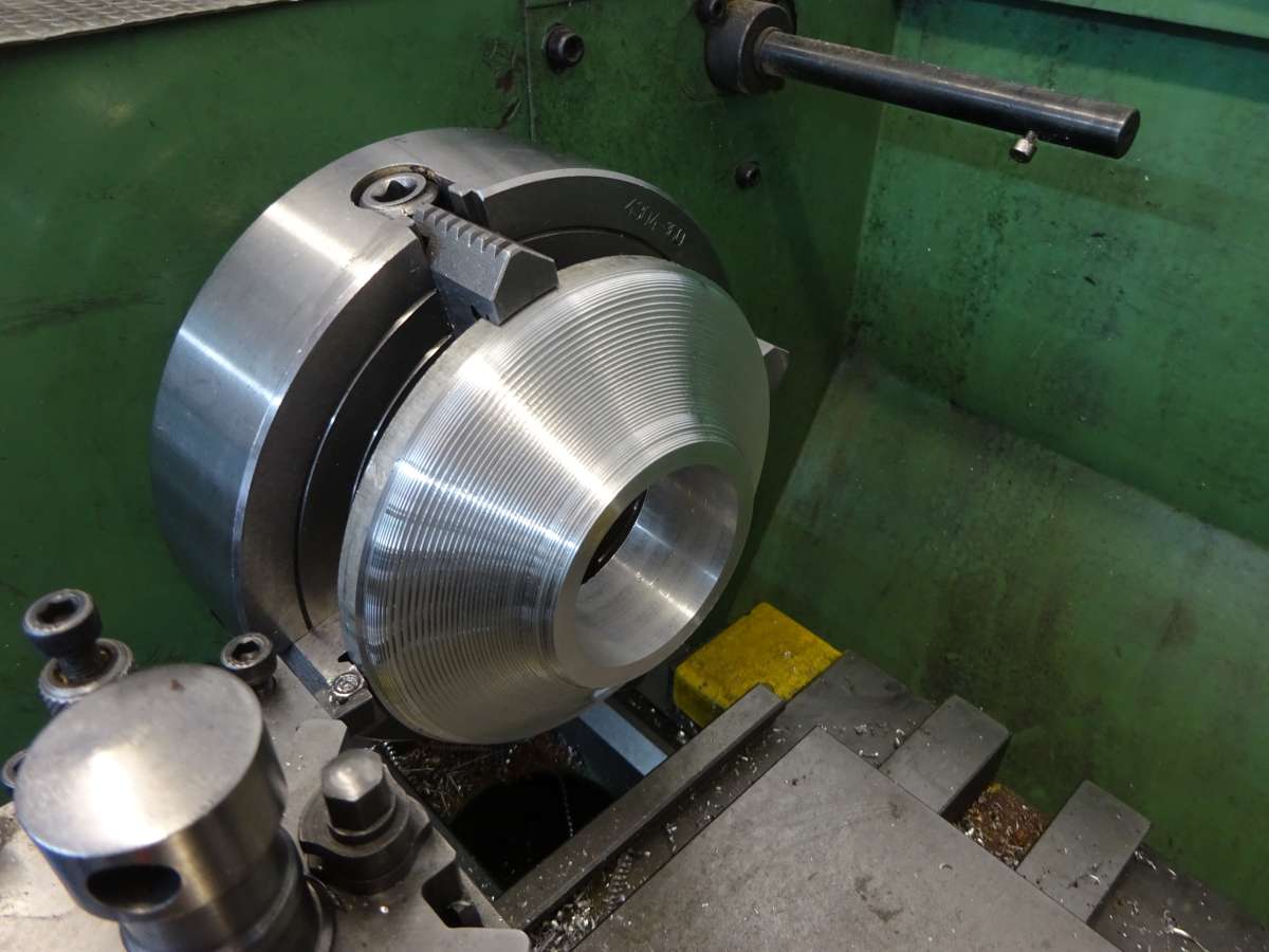

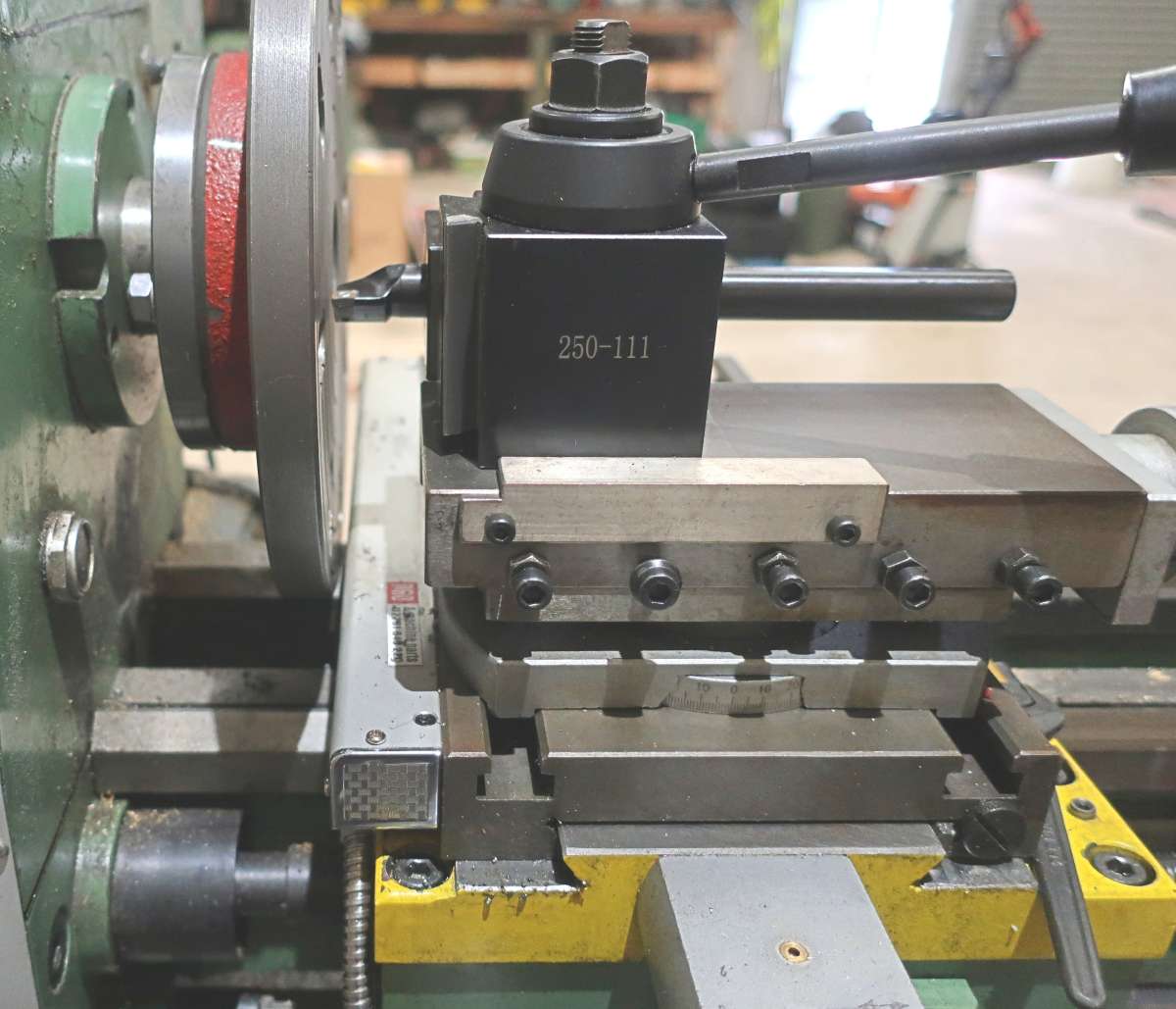

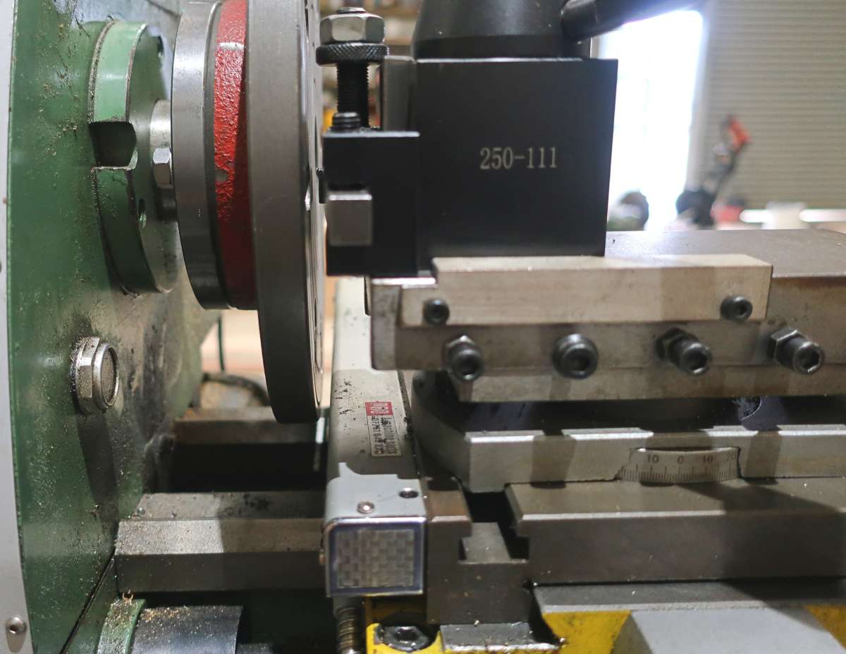

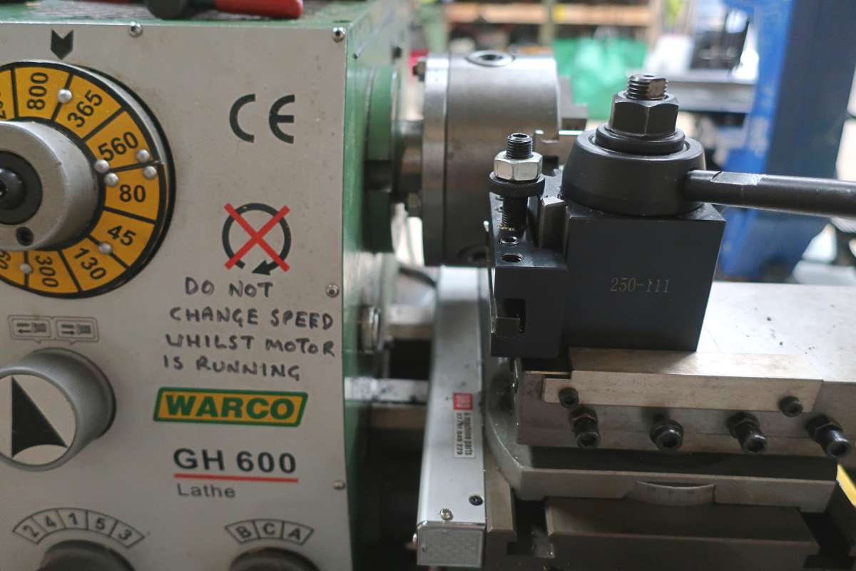

                                If you want ‘full functionality’/all the features, then it’s ‘what Jason said’.. ..3-axis..
                                If you just want to know where the toolpoint is in X & Z, a two axis will be okay, you might get some ‘extra’ features( i.e. taper/radius), but certainly on the cheaper units they might be clunky and hard to figure/use.
                                I have a glass scale on the ‘chuck-side’ – you can’t get too close to the faceplate, but ‘reach’ issues aren’t as bad as you might think – not bad enough to compromise use of the tailstock, for my preference. Pic below with normal tool, second pic with boring bar.
                                Machine is a 280-swing GH600.
                                The three-jaw passes over the scale with he jaws hanging (right) out.
                                I don’t have problem reaching the ‘backplate collet chuck’ I use.
                                Faceplate Left station
                                Faceplate boring bar
                                Chuck DRO

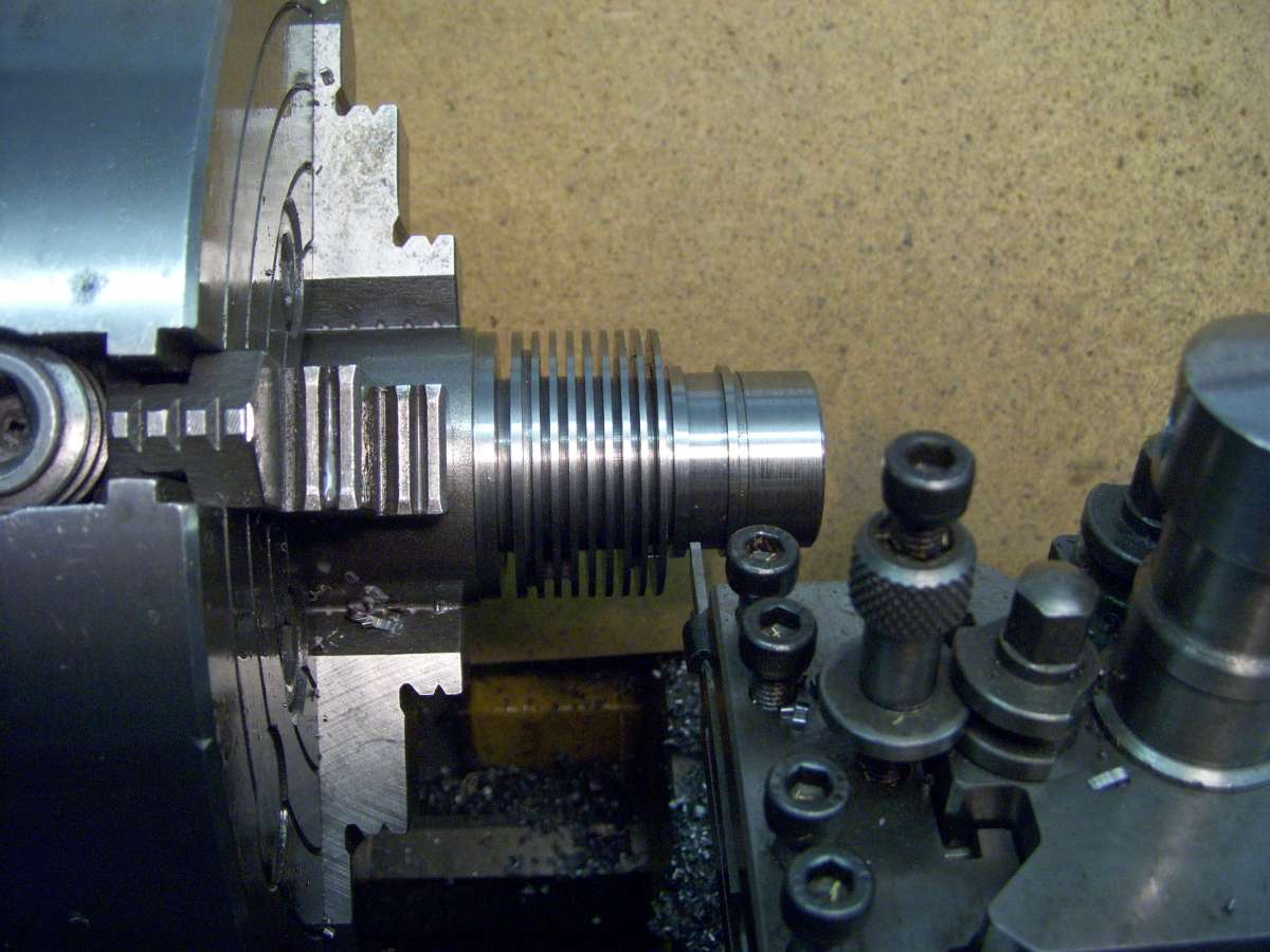

                                              I wa sinterested in Dave’s comment that a DRO has little value to him as he “mostly turns short distances”
                                              If I were to fit a DRO to my lathe that is one of teh reasons I would want it to keep track of short distances. Things like cutting a series of fins in a cylinder or using co-ordinates to rough out a curved shape. Lots of small lengths that add up and if you are not careful errors can creap in or you can simply loose count of teh handwheel.
                                              This sort of work

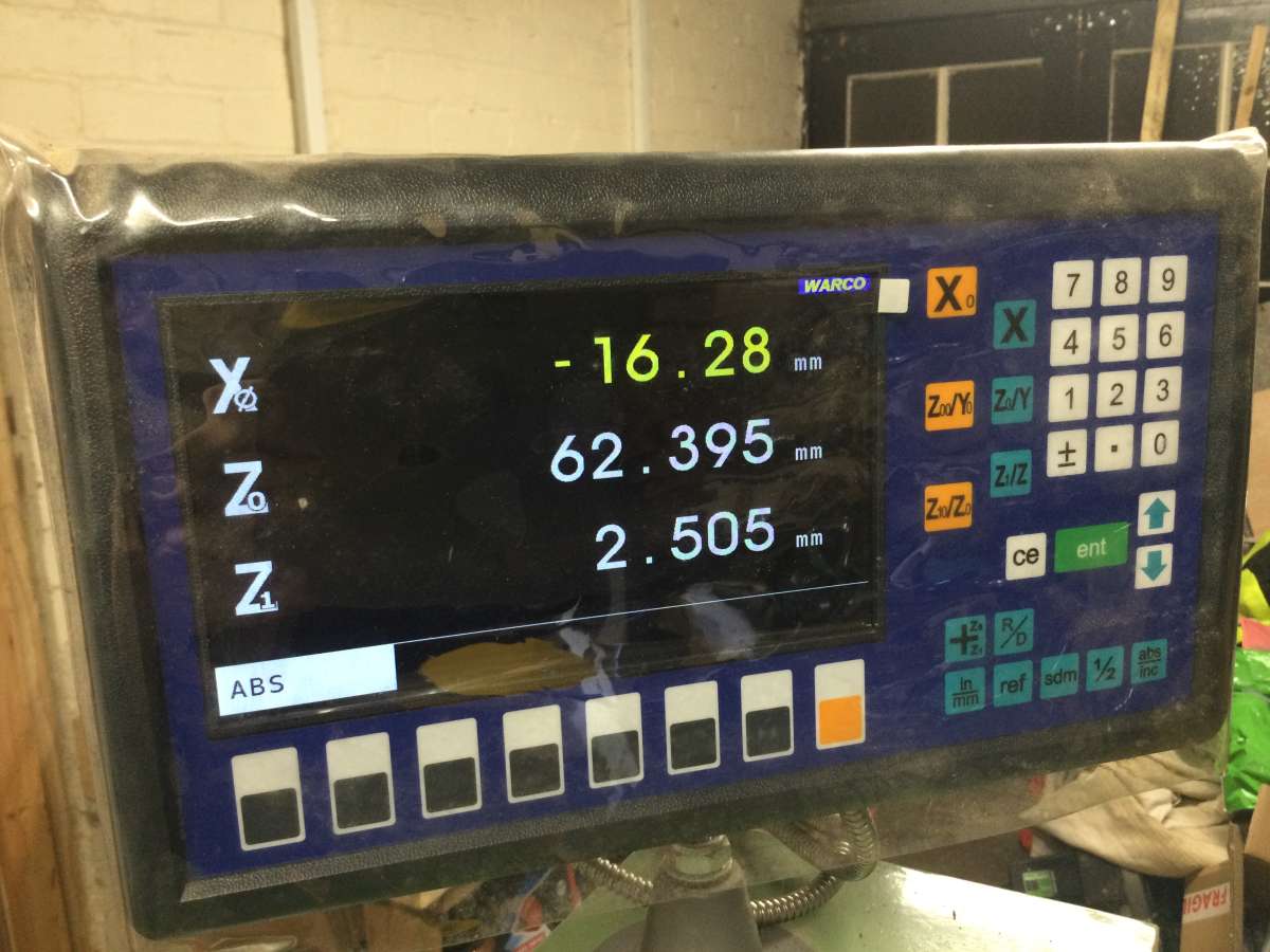

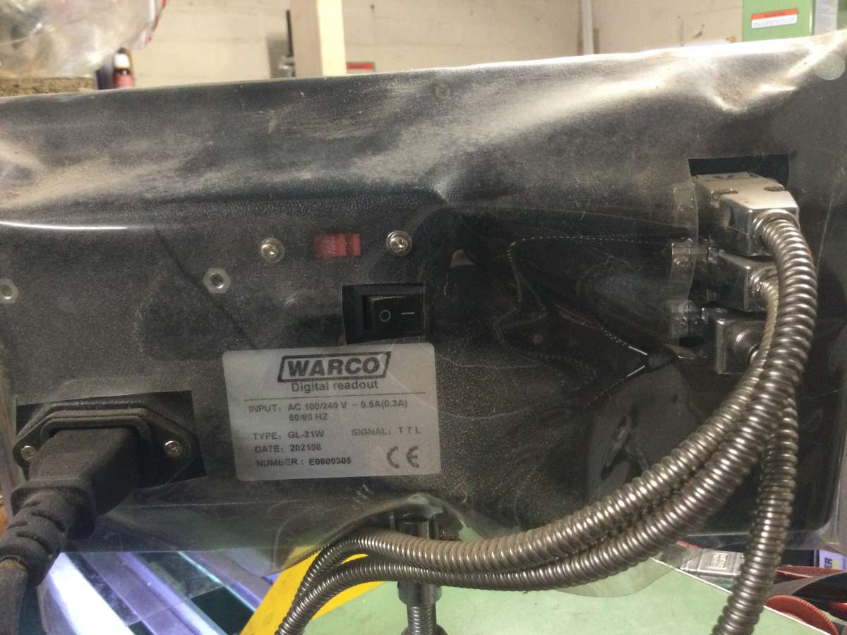

                                                My Warco WM290 came with a DRO fitted. The screen has 3 inputs but only 2 scales were fitted. I fitted a 3rd scale to the top slide. As Jason said earlier, if you do this you can get the display to sum the 2 readings together. I find it useful. Some photos attached.D5C79622-03DB-43CA-847B-0AC2F5B02F66FC9742B3-0F8C-4034-9CEA-38B02CF3ECF62DC87D08-29CE-4355-93A2-02CB7F938C0D

                                                    Good point!  I rarely cut fins or curves.   I would have to take extreme care making something like Jason’s cylinder head especially if the part had to look good when finished.   No doubt a DRO is helpful for complicated objects,  but my requirements are straightforward.   For example, I don’t think a DRO would speed up the machining needed to make a PottyMill?
