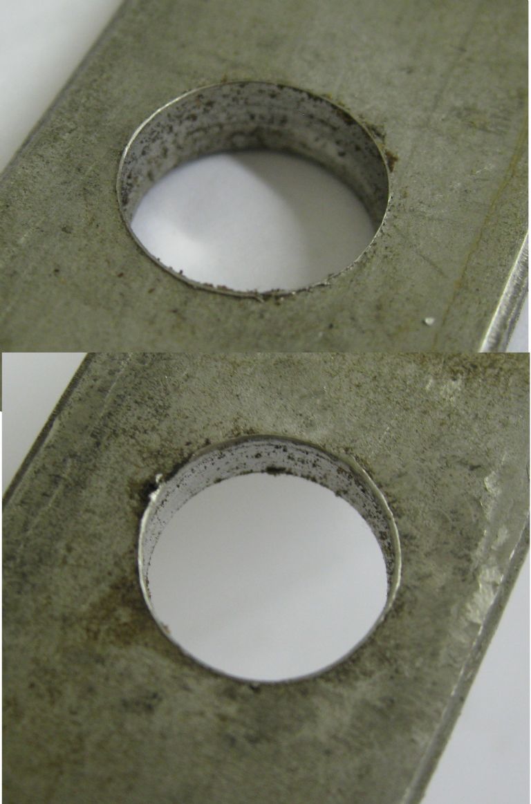

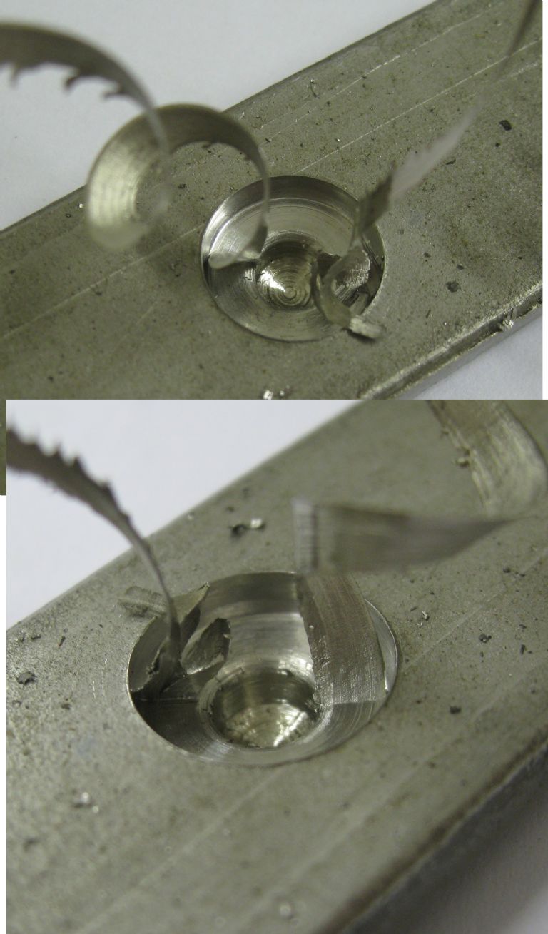

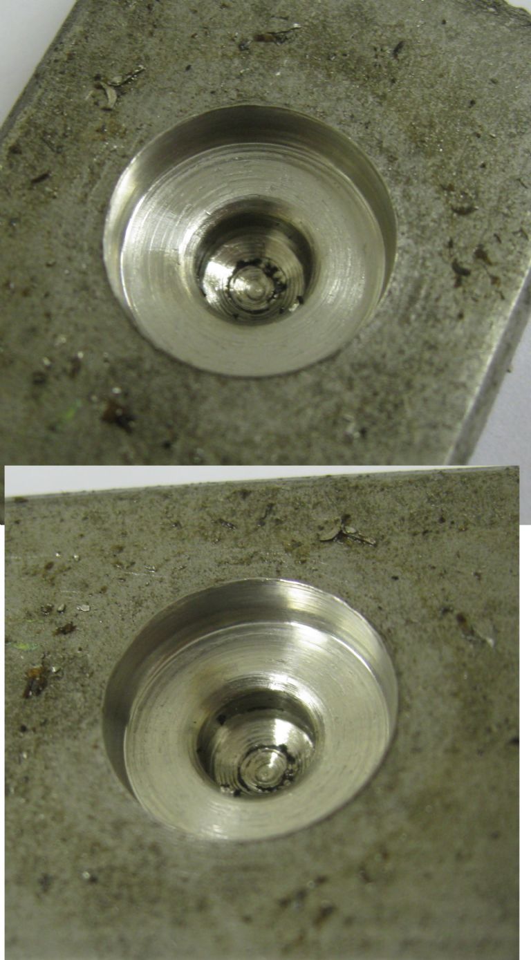

      During the installation of a Solar PV system on the house roof, I had to drill many 12mm holes( 350 holes..) in 6mm Stainless steel sections ( 316 grade).
      A Cobalt drill did approx 50 holes at which point the exit burr extended 2 to 3mm.
      I used 3 Cobalt drills ( conventional conical point) for approx 150 holes and ran out of drills in the town…
      The only drill I could find then was a RUWAG bit – RUWAG always struck me as a Weekend DIY store supplier, and I had no faith in the product 'quality' – based on no experience whatsoever. Anyway, purchased 4 of these drill bits:
      https://ruwag.co.za/products/turbo-metal-drill-bit?variant=12690802606174
      Even that name put me off!
      The result after 74 holes, with the SAME drill bit!!
      Coolant was used, – a squirt bottle with soluble oil/water mix, one liberal squirt at the start of drilling ( the conical bit required a second squirt halfway thru the hole..)
      Slight crumbling of the corner edges
      Nice cuttings..
      Part drilled hole
      74th Hole entry (top) and exit (bottom) burr
      Who would have thought!

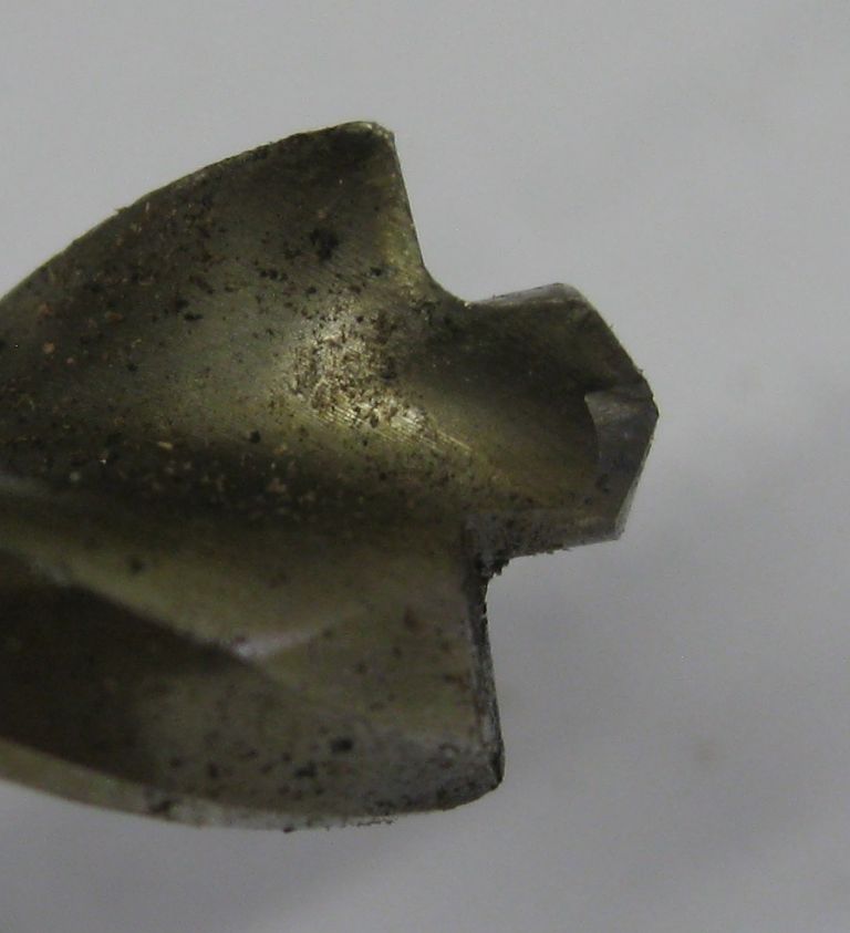

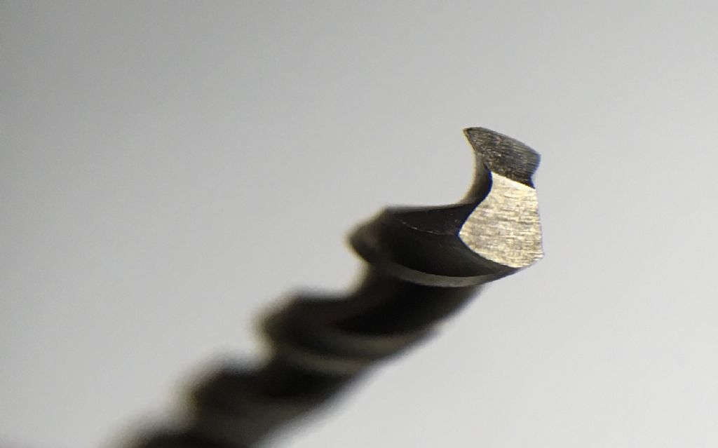

                        Well …The drills arrived safely today
                        My main reason for purchasing them was to see how well the ‘2-stage’ shape would be ground at small diameters [see Joe’s photos for the advertised shape]
                        First inspection was a little disappointing:
                        This is the tip of 3mm drill from the same series:
                        The tip looks ‘slightly thinned’ but is not recognisable as the advertised shape dont know
                        #635385
                        Tony Pratt 1
                          @tonypratt1
                          That drill is not correctly ground for any useful purpose.

                            That's a shame, Michael. It's not at all what was advertised. It's a standard profile drill, from the look of it, but with a very thick web.

                                @francesiom58905
                                I suspect the 2mm + 3mm sizes are too small to use the “pilot point” – rather like several good suppliers of Cobalt drills state that 4 facet drills are those above 3mm.
                                #635396
                                  Posted by Frances IoM on 28/02/2023 18:48:59:
                                  I suspect the 2mm + 3mm sizes are too small to use the "pilot point" – rather like several good suppliers of Cobalt drills state that 4 facet drills are those above 3mm.
                                  Probably true, Frances … investigating that was my primary motivation
                                  But the fact remains that they come in packets displaying that ‘pilot point’ as a feature
                                  Edited By Michael Gilligan on 28/02/2023 19:03:12

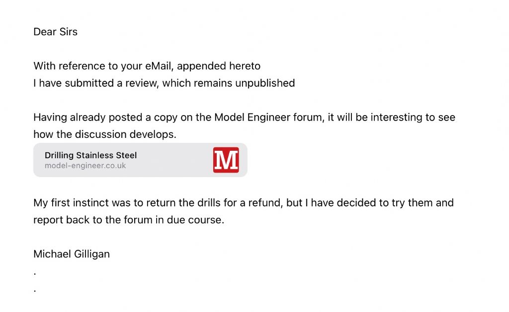

                                      I have just submitted the following, as a review on the RUWAG web-site:
                                      [quote]
                                      I have not yet tried the drills [which arrived promptly and safely, thank you] but my initial reaction was disappointment … The 2mm and 3mm drills do not feature the ‘2 Stage Drilling’ grind which is advertised.
                                      I realise that this would be difficult to execute, but that is exactly why I ordered them … I wanted to see how well it was done !
                                      My comments, with photographs, can be seen on the Model Engineer forum, at
                                      https://www.model-engineer.co.uk/forums/postings.asp?th=185942&p=1
                                      If the drills prove to be as capable as they are described, then I will happily update that thread.
                                      [/quote]
