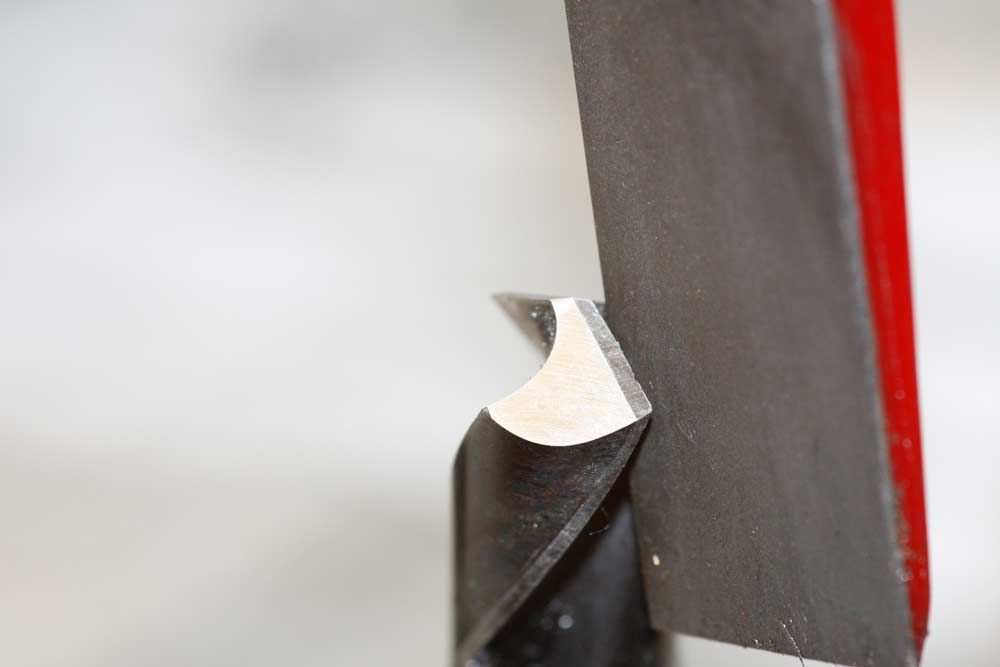

                                      #44615
                                      AlasdairM
                                        @alasdairm
                                        Posted by chris stephens on 22/10/2009 19:23:38:
                                        … but I am sure some one will … point you to a web page somewhere with pictures…
                                        I would love it if someone could post a link to some pictures, as whilst I “think” I understand what to do with my drill bits and oilstone (to enable me to drill brass without grabbing), I would hate to get it wrong!!
                                        Regards, A
                                        #44621
                                        mgj
                                          @mgj
                                          Herewith.
                                          One 4 facet sharpened drill with a little diamond lap about to “blunt” the cutting edge -AKA  zero rake. don’t go mad- a couple of strokes is plenty, one is usually fine.
                                          Actually it needs resharpening, but since it still cuts better than a new drill it can wait!!!

                                          #44623
                                          AlasdairM
                                            @alasdairm
                                            Meyrick – many thanks for the picture and explanation – I will now go ahead with confidence!!
