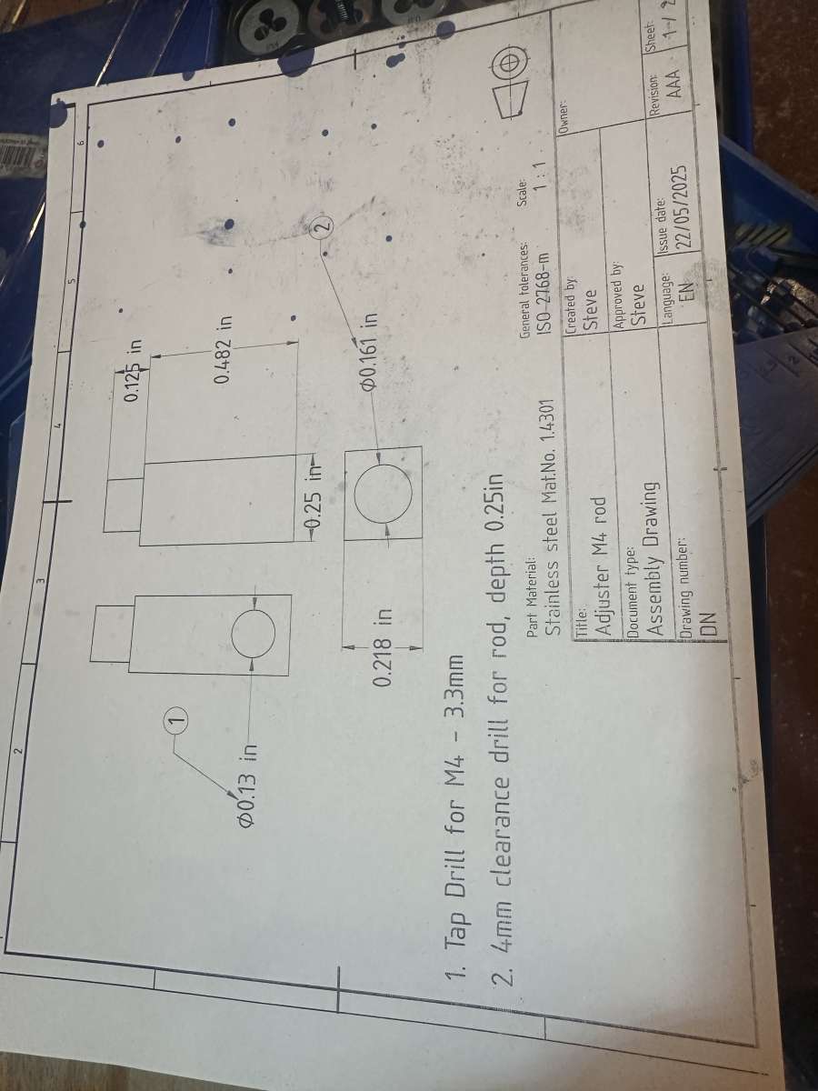

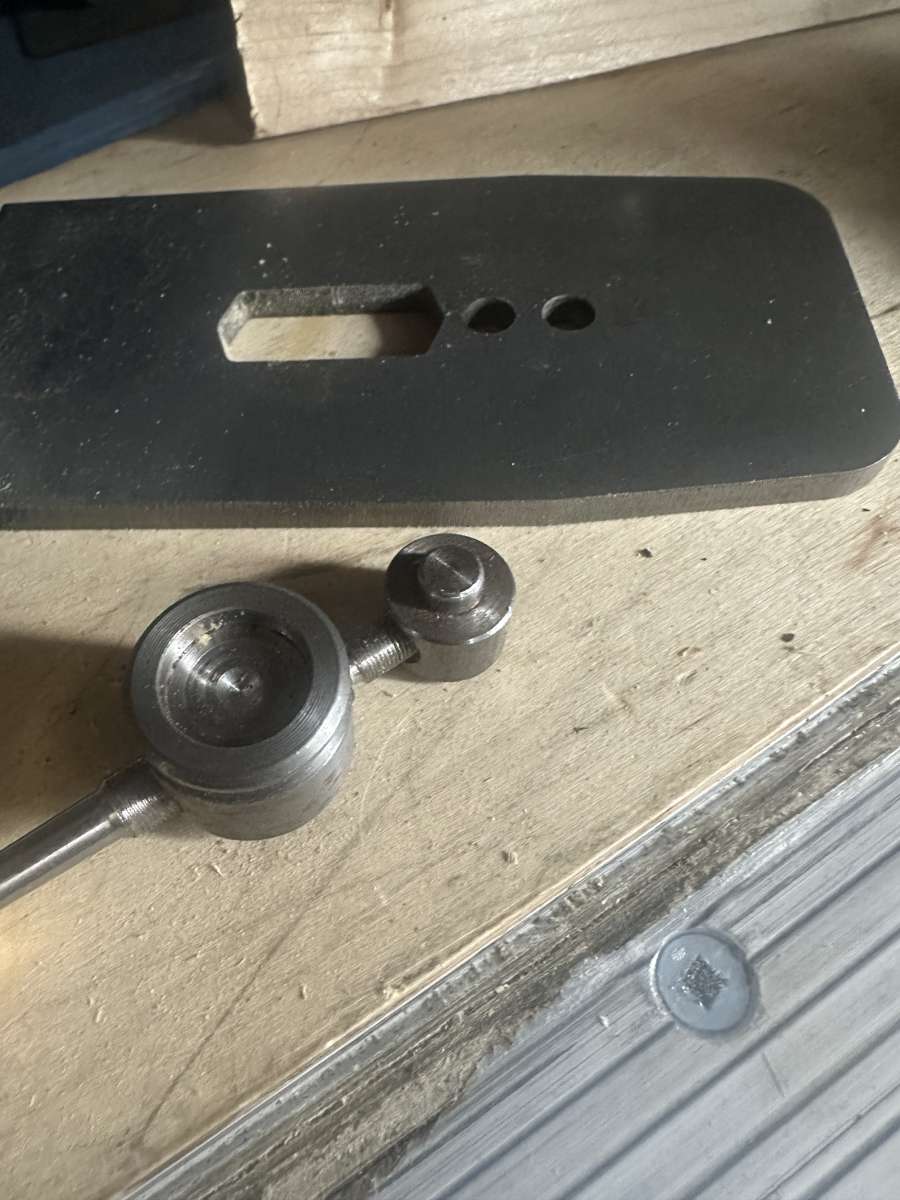

      Perhaps this should be in the beginners section, but I made such a hash of this I thought I’d reach out for advice. I have a fiddly little part that I need for one of my projects. It’s a wood plane blade adjuster, a little bottle-shaped thing. Being part of a tool, and potentially under stress, I thought I’d make it from O1 and harden it before installing it the device.
      It’s basically a piece of 0.25” x 0.218” x 0.482” tool steel that needs to be drilled and tapped twice for M4 (despite what the drawing says I ended up tapping it in both holes).
      I cut rough blanks and dimensioned them using the surface grinder. Lucky I have that.
      I made a pretty decent job of punching the hole locations accurately.
      Thats when the fun started. I broke several bits and a tap. The problem seems to be work hardening. I dialled back the drill speed to 200rpm, and tried annealing the work in sand to keep it malleable. I did it in the end, but on the 4th try.
      I used plenty of cutting oil but I don’t have a coolant system.
      Does anyone have any tips for drilling small fiddly holes in O1? I’d really like to be able to do this quickly with minimal fuss.
      Thanks
      Steve

                  Edit. I have been looking at the drawing and I now think the drawing is suggesting putting a pin into a clearance hole and that the drawing is unclear on this point.

                        The drawing does suggest putting a 4mm pin in a clearance hole (planning to use loctite). However, this hole failed initially (drilling) and I realised that a 3.3mm tap hole, being smaller than 4mm, would be easier to drill on the tiny area on the top of the workpiece – and so it was.
                        The drawing erroneously says stainless – that’s just the drawing template.

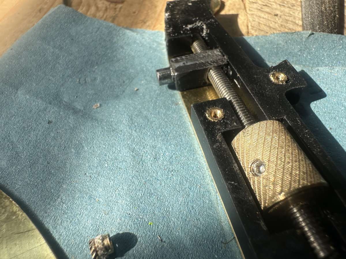

                        When I look at a part of a Veritas hand plane that has a similar purpose(see below), it’s clearly extremely robust and made of some sort of tool steel. That’s why I chose O1. I’m not sure my design is right but I’ll refine it once I have a prototype working (or not!). Brass would be easier!
                        Originally my drill was running about 900 rpm. Which ironically sounds like it was about right. Trying to reduce the RPM to reduce the heat wasn’t the right move and I can see why now.
                        Funnily enough I’ve done quite a bit with O1 in the past, and I’m always amazed by how soft it is in its annealed state.
                        I think in fact my drill bits may be poor. I need to order some probably 3.4mm good quality bits.
                        In fact, having considered the suggestions, and looking at the Veritas design I think I may be better off turning the thing out of “hard brass” as someone suggested, or bronze. Then there’s only one hole to drill…..
