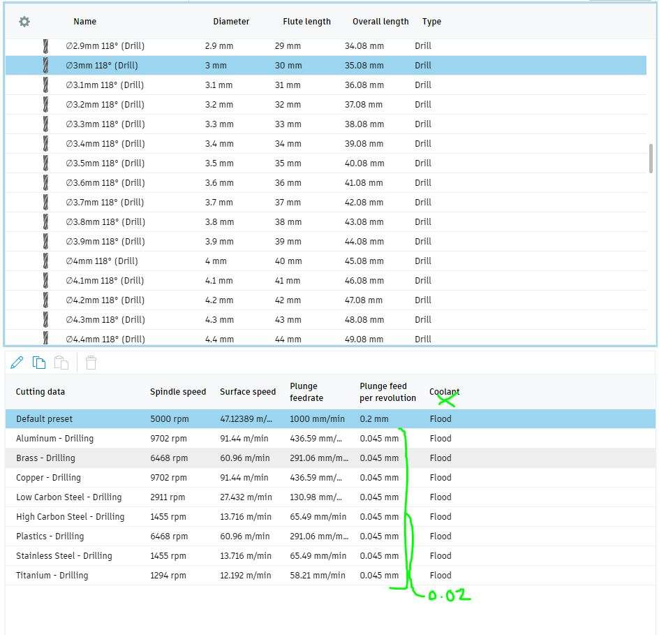

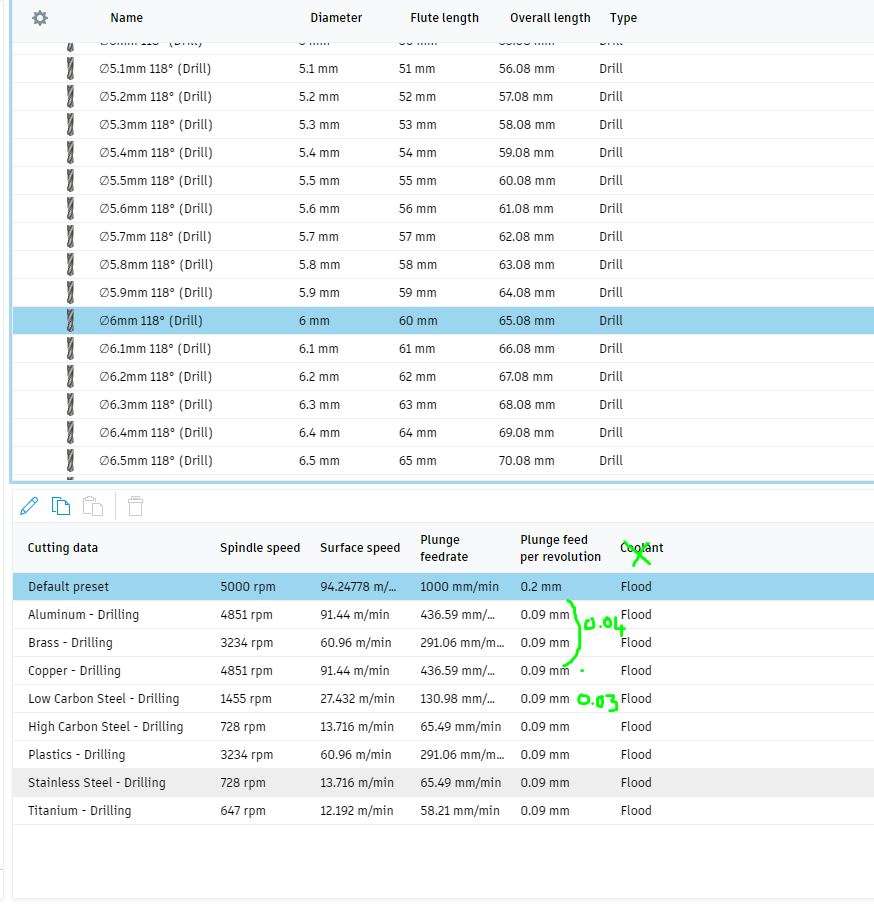

        As I use F360 for my CAM I tend to take their speeds ( subject to 5000rpm max) but use around 40% of the feed rate per rev. The feed rates per rev are fairly constant for all the materials they list and only change when you look at them as mm/min when the speed comes into play
        So a 3mm drill will typically feed at 0.02mm/rev and a 6mm drill feed at 0.03 to 0.04. I don’t have flood cooling so that is one reason to reduce it and once more than about 1 x diameter deep will use “full retract” which is what they call peck drilling to reduce risk of swarf buildup in the hole and allow brush or fogbuster to get some cutting fluid on the drill.
        Not cooked any drills yet. Tend to use Dormer A022 Stub length most of the time
        Typical F360 chart and what I run
        3mm drill
        6mm drill

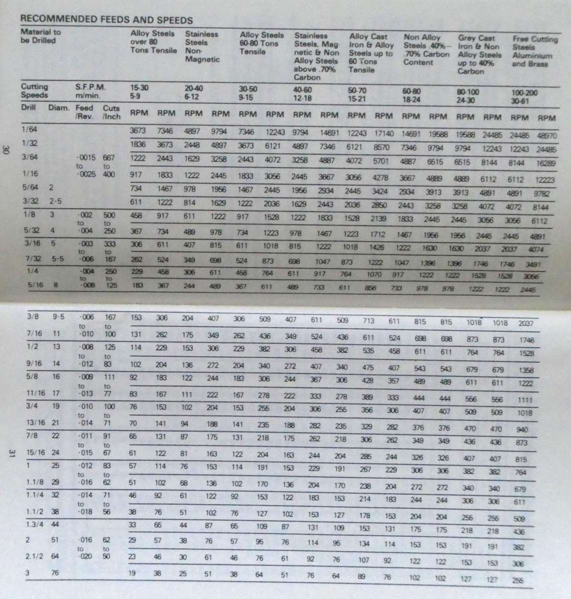

          This is from a small handbook supplied by a well known drill manufacturer. Note you can reduce the rpm but should not change the feed per rev. The calculation for vertical feed is simply the rpm x feed per rev and will be in mm/min or inches/min depending on which units you use.
          P1010125
          Martin C

            Out of idle curiosity I looked up some of my old CNC drilling cycles. My feeds per rev are roughly double those mentioned by Jason, more in the ranges given in the chart by Martin. So for a 3mm drill I’d be at 0.06mm/rev and for a 6mm drill I’d be at 0.15mm/rev. Like Jason my go to drills for small sizes (1mm to 10mm) are Dormer A002.
            I tend to use G73 for peck drilling as it doesn’t completely extract the drill, just breaks the chip and is faster than G83.
            As an aside I am a bit more aggressive than Martin’s chart when it comes to larger drills (>3/4″) on the lathe. The tailstock is wound as fast as I can go, often resulting in feeds of 0.5mm/rev or more. A drill is very efficient at removing metal at a high rate.

              The low end of Martin’s chart is actually very similar to the F360 suggested rates if you compare say 1/8″ to 3mm and 1/4 to 6mm . It is just that I choose to reduce them. Your flood coolant may help, I don’t want to weld aluminium swarf to a drill bit!
              F360 also has a “chip breaker” option which is like G73

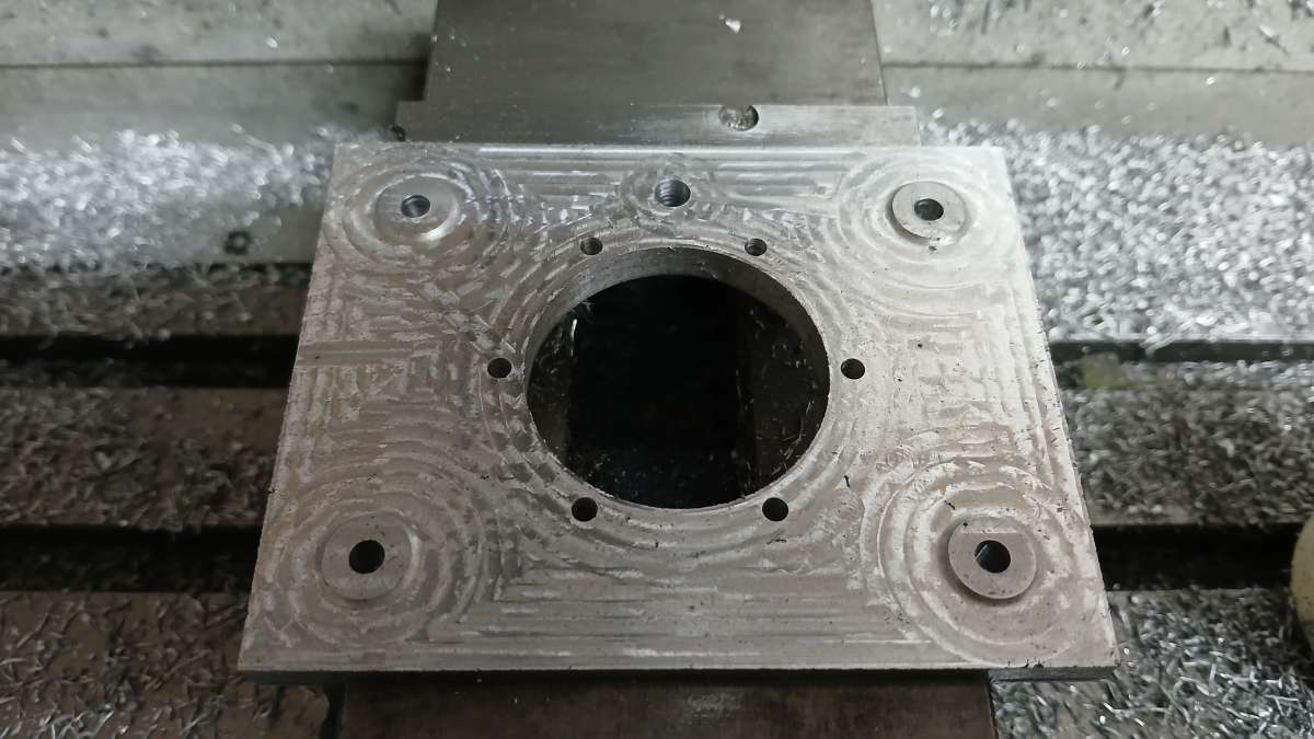

                  It would depend on the size of holes and the usual size of milling cutters you use.
                  I would say the majority of what I drill on the CNC is a mix of clearance and tapping holes for M2.5 and M3 for whch I use a drill as my usual milling cutter is 6mm dia or 4mm if it is a small part with internal corners.
                  Bigger holes >10mm I will often do with the milling cutter but again may drop the feed slightly particularly if they are deep to allow the chips a chance to get out. This also avoids the problem of the actual cutting edge of the tool feeding a lot faster than it’s feed rate as the rate is set to it’s ctr line.
                  This recent one all the small 3, 4 and 5mm holes were drilled and the big one done by milling.

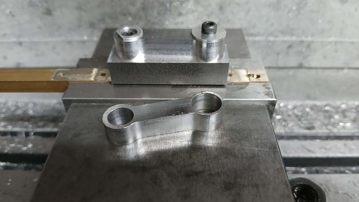

                  Yesterdays items were drilled with drills and reamed 8 & 10mm on the manual mill then the holes used to hold the oversize in X and Y stock to profile the outside on the CNC. M3 holes in the metal in the vice were done with a drill bit, straight in as the split point stubbies start OK and I only use a spotting drill on more critical jobs.
                  20250208_114045
