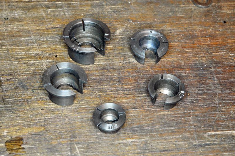

                                    Roderick Jenkins
                                      @roderickjenkins93242
                                      Found 'em smiley
                                      The slot in the side of most of them was to allow for the arm of a ball handle. The small one at the front was for drilling the ball to go on the end.
                                      Rod

                                        #260256
                                        Roderick Jenkins
                                          Guilty m'lud:
                                          I sold it -awkward cantankerous thing. This is the only record I have of it.
                                          Rod
