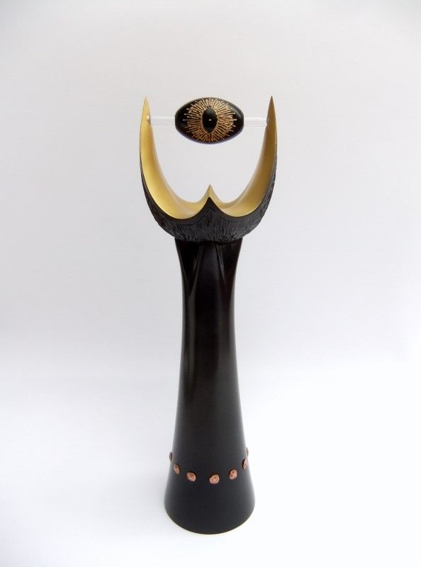

        I want to source a largish ball from a ball bearing and then drill into it without having to heat it up and loose the nice shine that they have.
        My question is can it be done without heating it up. What I want to end up with is a ball about 1" diameter which is very shiny to add to a sculpture that I want to create from wood the hole will be to glue in a clear rod so it appears to float withing the piece.
        My other thought to achieve this was to use magnets, but to insert them in the wood without leaving a tell tale ring of wood is the problem as the magnets need to be large enough and strong enough to float the ball.

                      Thank you all for the different suggestions. I will take a look at some of the option that have been suggested.
                      I am trying to do something similar to this one but with a single support from the bottom
                      The Tower

                            For the shown application, could you just machine the end of the clear rod concave and glue it to the ball with no hole drilled? Might even be less obviously visible than the drilled hole seen through the clear rod?

                                Again thank you all, looks like I will be looking at some stainless balls instead of going for the bearing ball type. They also seem to be more readily available as well as being easier to drill. Making a holder will be no problem
                                Posted by Hopper on 26/03/2019 08:49:44:
                                Where it is to be drilled will not be obvious but still a good idea for future pieces thank you.
