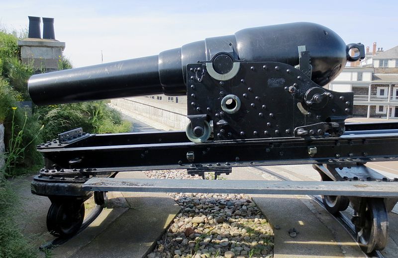

          Buffer
            @buffer
            Hi
            First of all thanks for all your advice. I will look for a piece of cored bar as Hopper suggests and then use the drill extension that Rod and the others have mentioned.
            It is a through hole and it is for a cannon barrel. I am probably going to have a go at the type shown below.
            It needs a through hole so I can put riffling in it, the breech end will then be blocked up with a screwed on cascabel. The real ones had the cascabel screwed into place also.
            Thanks again.
            Rich
            rml_7-inch_7.1n7-ton_gun_mk_i,_(serial_no._15),_halifax_citadel,_halifax,_nova_scotia.jpg

              Whether rifled or not, best not drill a touchhole through to the bore unless you're putting the finished cannon onto a Firearm Certificate. Near where I used to live in Redditch, someone had a model cannon destroyed by the police and I don't know whether they escaped prosecution.
              How are you proposing to rifle it? That seems to me the most difficult process to do at home.

                                          Yes, perhaps so – but looking up the RML it was used in revealed an additional complication – gain twist rifling… surprise
                                          If it was me, I think I'd try and duck that particular one…

                                            A naive question, if I may:
                                            Are the groups of 3 discs on that 12.5" round intended to engage with the rifling in the bore ?
                                            … I don't think I have ever seen that before.

                                              Posted by Michael Gilligan on 11/05/2018 17:27:04:
                                              Yes. Copper alloy 'gas-check' base sealing discs were added later to reduce blow-by and substantially increase velocity, and eventually 'automatic gas checks' superseded the need for studs altogether, but by that time breech loading was being (re-)introduced.
