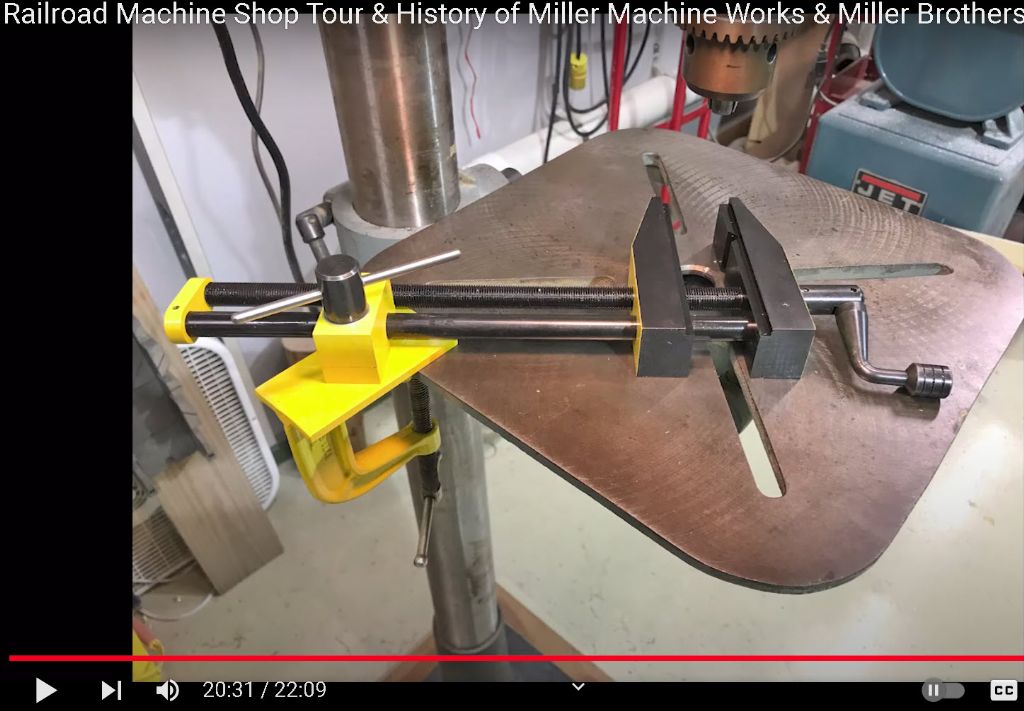

      Hi All
      I have seen this design before but this is a great image as a working start for anyone who would like to build one.
      The video also has some wise words at 21 minutes. and a good family history of 3 generations of a metalworking family.
      **LINK**

                Have a look on the "Blondihacks" (Quinn Dunki) website where she makes one of these "float lock" vices. Several instalments if I remember correctly.
                #603046
                Craig Brown
                  @craigbrown60096
                  Mr Pete also did a series on building one. Always thought it looked a useful addition to a drill press

                    Blondihacks' links to drawings are behind a Patron paywall. The drawings Mr Pete used are available here:
                    **LINK**
                    Rod

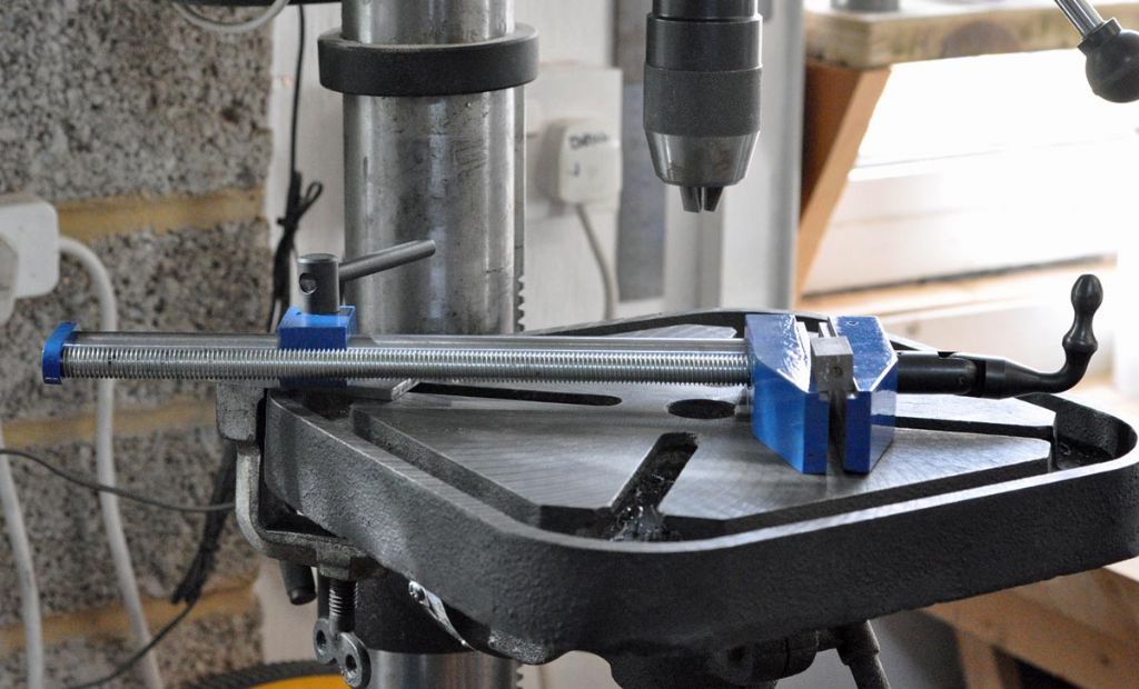

                                  Anyway, I was so impressed by her efforts that I have spent a couple of days making my own from odds and ends in the workshop:
                                  The clamp is adapted from a strange thing that I bought from a stand at a vintage fair for a couple of quid and the screw is M12 studding left over from a previous project. The jaws do lie flat but there is some rather over enthusiastic de-burring on the bottom edges blush. It is a very functional device and I am impressed by the design. Although it looks a bit rickety it really does lock in place.
                                  Rod
