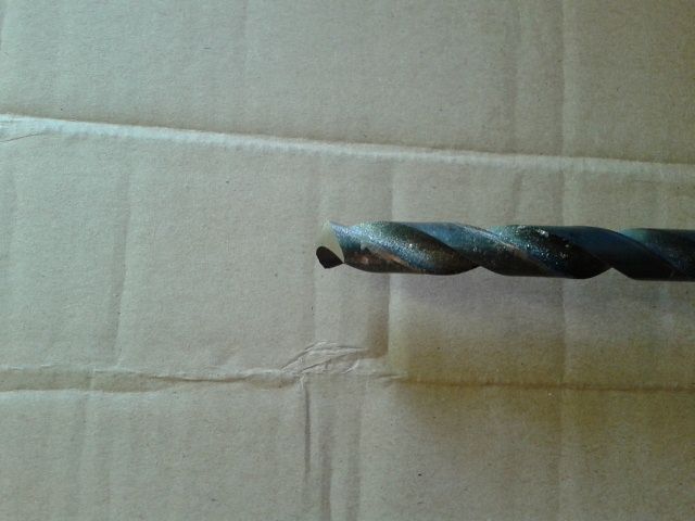

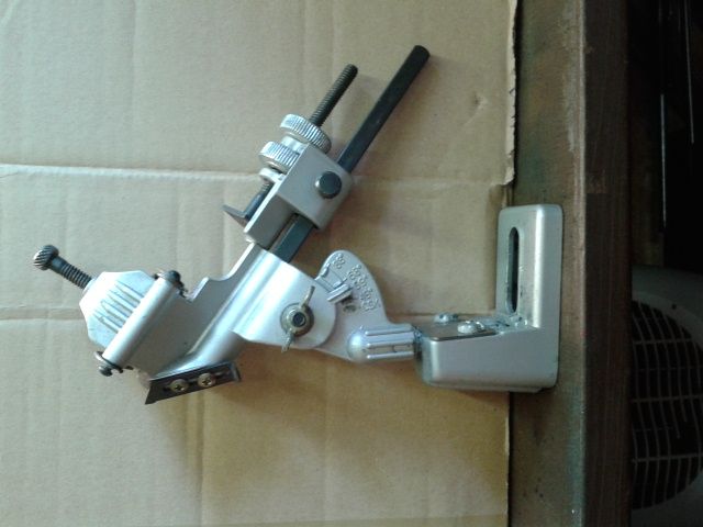

        Hi burried in one of the boxes that came with my super 7 was this drill sharpening attachment
        so after giving it a try on the 59 deg it sharpened ok but the profile (if thats the term) did not look like a normal drill it sloped down a lot on the left hand side !
        There were no instruction with it and I set it as best I could, the plate on the front end just above the edge of drill and half drill dia sticking out, so my questions is this finish ok, how should it be set up etc
        Hope someone as one or something like it and can advise me.
        Thanks H

          Have a look here Harry **LINK**
          Harold
          #126393
          Harry Wilkes
            @harrywilkes58467
            Thanks Harold great link just the info I was looking for
            H
            #126398
            Russell Eberhardt
              @russelleberhardt48058
              I can confirm that Harold's instructions work well. I bought one of these, followed the instructions, found it didn't work and threw it in a drawer where it stayed for 10 years. After seeing Harolds write-up in his book I dug it out and found that it worked beutifully!

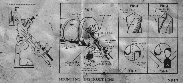

                This is all I seem to have of the instructions for the sharpening jig that I have. It does not get that much use, but does a good job when needed. Ian S Cdiag drill sharpening (640x292).jpg
