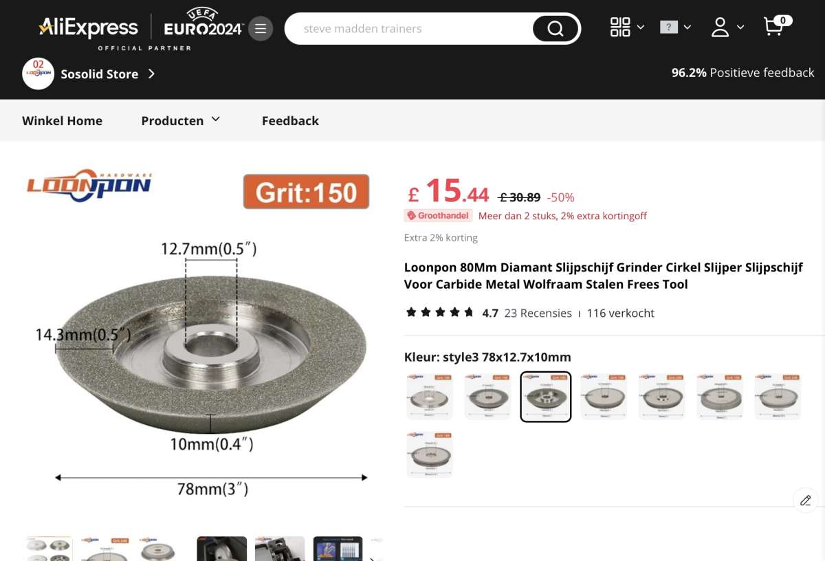

                      Vic
                        @vic
                        I found the disc he’s using. I’d prefer something a bit finer though.
                        IMG_0422
