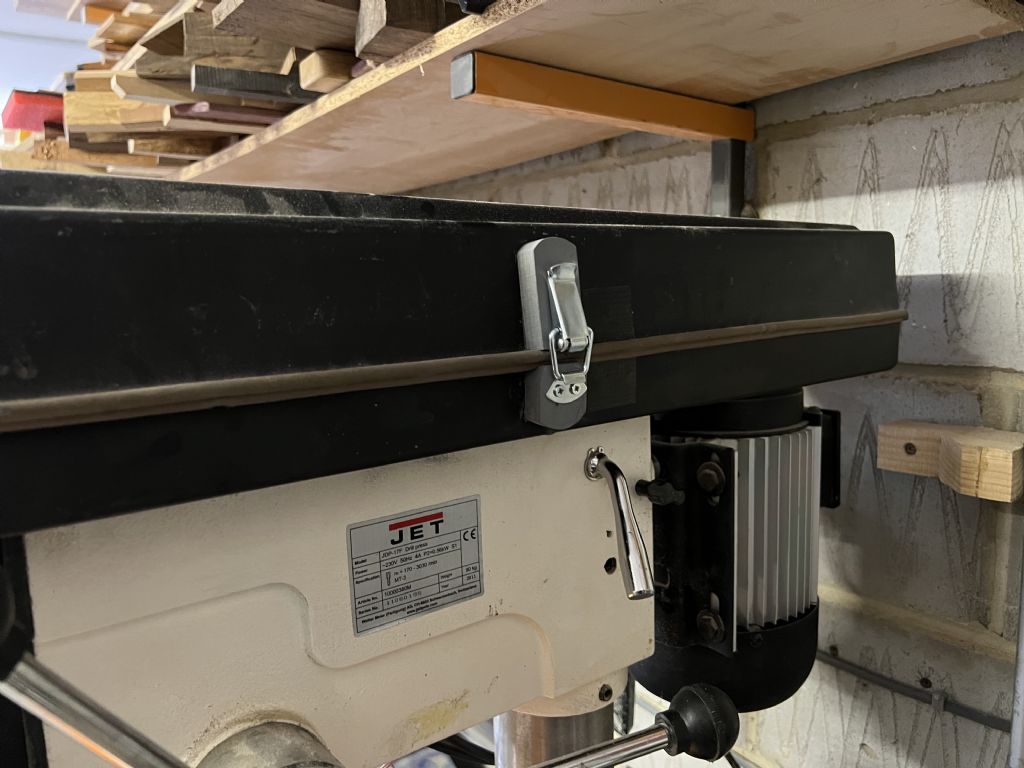

      1. Instead of a screw, a toggle latch for the top pulley covers. Much easy to access the pulleys instead of unscrewing and screwing the cover .

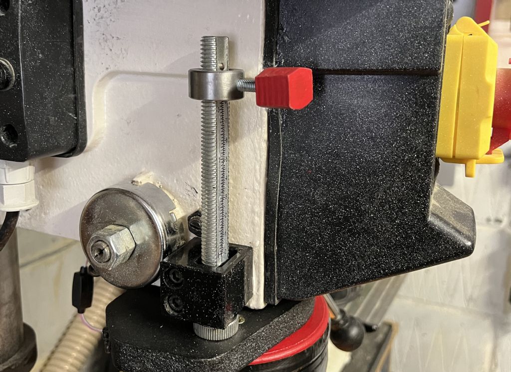

      2. A collar with thumb screw for depth stop instead of a two nut system that most of the time gets very annoying (at least for me)

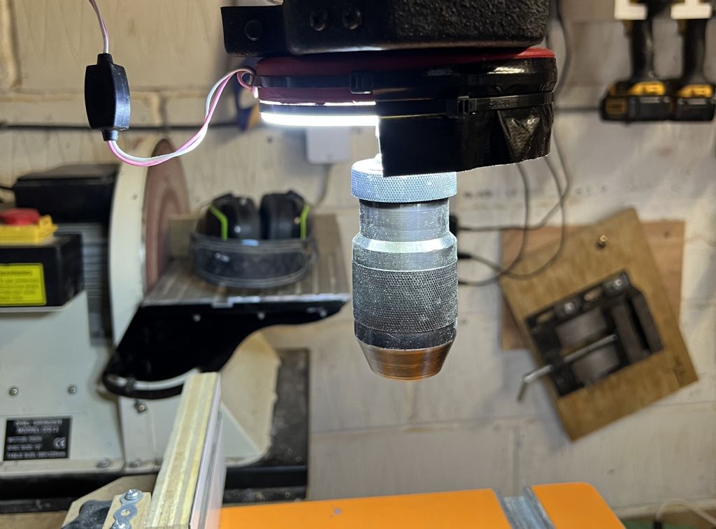

      3. A ring light that greatly improves visibility- best addendum so far!

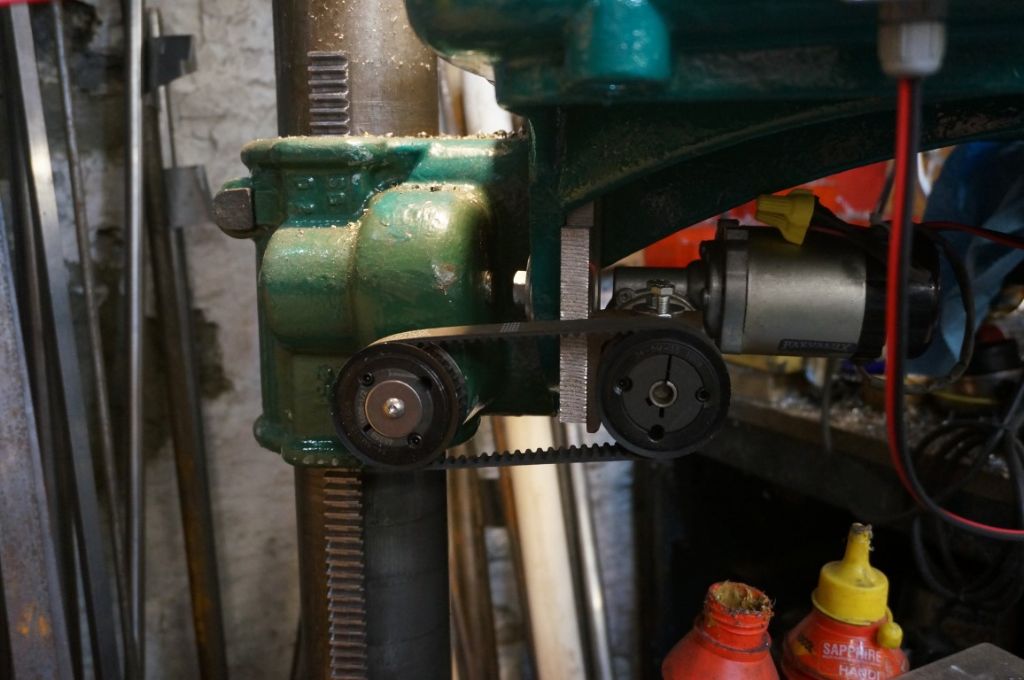

              My best ones are fit a 3 phase motor and vfd..much less belt changing needed
              and electrical table lift and fall

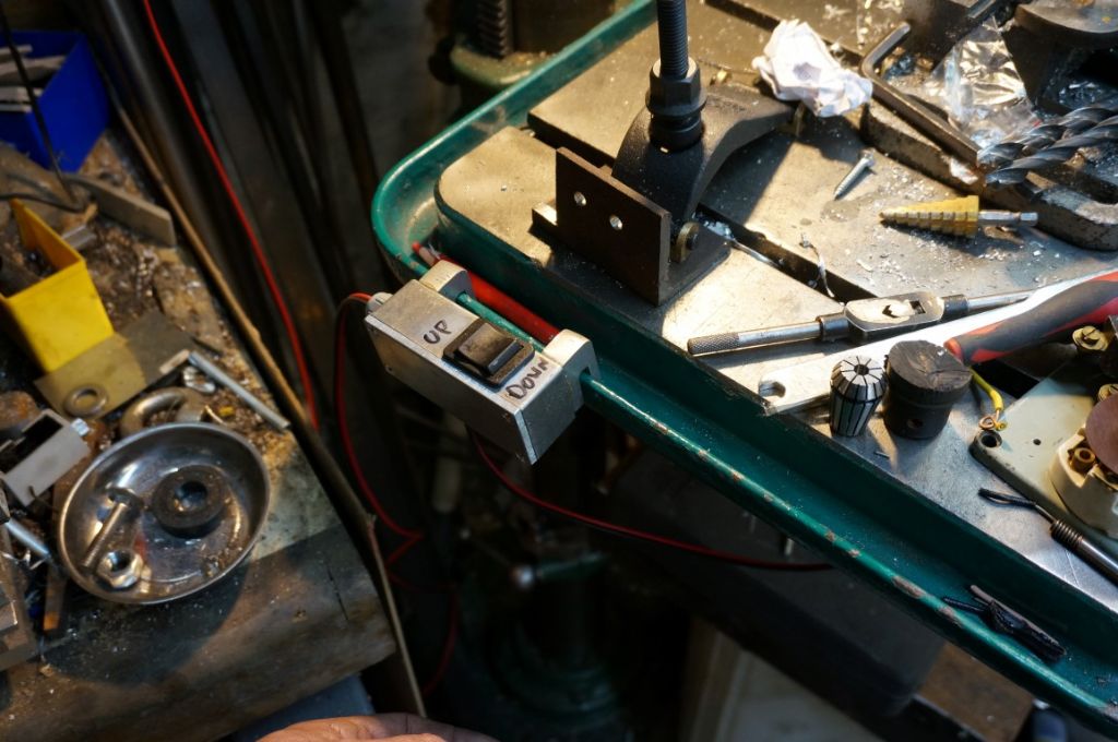

                  Andrew
                  thats just a 24v dc parvalux geared motor driving the shaft which lifts and drops the table and a switch mounted on a flying lead so that can mount on the table where i can get to it
                  ian

                          My smaller, Meddings, bench-drill, has an original depth-stop similar to your thumbscrew, and it does make life simpler than the knurled ring-nuts on the Progress. Especially as years of grubby fingers have worn the knurling nearly away!

                              I quiet like the idea of adjusting the table height with a geared motor. As Nigel points out, i think the table needs to be still locked. Another reason i can think of is the adjusting rod is connected to the motor with a belt , not the motor is directly mounted on the handle. The belt can slip under load. My thoughts. I may be wrong here. Ian can correct it.
                              Some day i may add that geared motor. Now the priority is to add a VFD and change to a 3 phase motor,

                                The table does hold as it would with a handle but when i want to lock the table i have a hydraulic cylinder and pump (hand op) that does the job.
                                it may seem overkill but this is a drill in a very tightly packed workshop so its not easy reaching round for a handle and the locking screw

                                    Does the belt guard actually need a catch (or a screw)? Mine has functioned perfectly safely for decades without either.

                                      Without some sort of catch, the belt guard on some machines can rattle annoyingly even if not strictly needing a positive hold-down. It does on my milling-machine even though a hefty aluminium casting if I forget to close the clips; and worse, if not clipped down it seems able to vibrate against the nearest pulley.
                                      The belt guard on both my Elliot 'Progress 2G' and the Meddings drills is a central, sprung bayonet-fitting on a vertical stud, of similar convenience to the spring catch on the side.

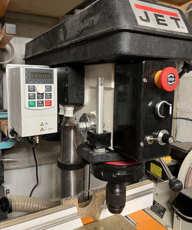

                                            A new 3 phase motor and a VFD fitted. Controlling speed is a breeze now. The whole project was very straight forward .
                                            VFD
