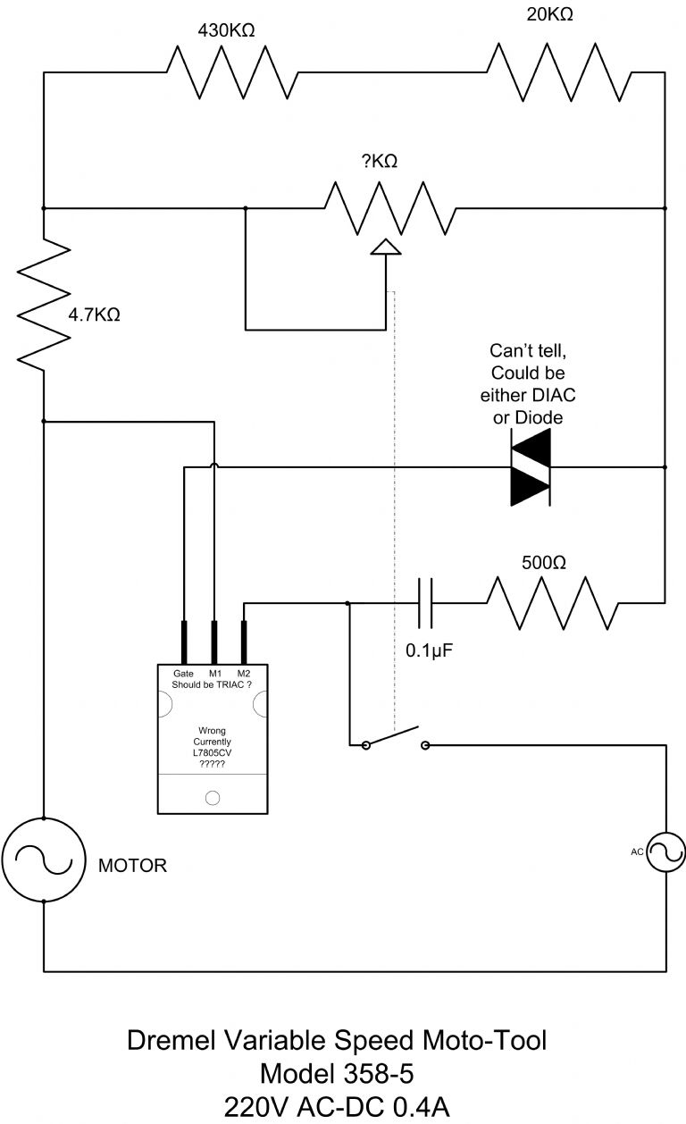

      Hello, Does anyone have an older Dremel Moto-Tool Model 358-5 variable speed, and who is able to have a look inside to confirm a component number please .
      I do but the variable speed no longer works, just the Off/On on the pot, so it is still usable.
      I just had a look inside and the only semiconductor is labelled as a voltage regulator L7805CV
      My own experience of this device is as a low voltage regulator, so I don't know if it has previously been replaced with the wrong item.
      I have tried swapping it for a direct number replacement, but still no vari speed.
      Cheers
      Bill

            Many thanks, but it looks to work a different way.
            Mine has a rotary pot on the opposite end to the chuck, which incorporates a 240V off-on switch.
            I've not mapped the circuit out, but some sort of voltage divider and a 3 pin IC of some kind.
            I know what's fitted, (and labelled as an L7805CV) but not convinced it's correct.

              Yep, probably no use at all, but I took it apart anyway so I could brush the dust out. There is something in there marked BT134W, with three legs and a heatsink/mounting tab. Surface mounted device, Googled it and it's a triac.
              Surprisingly it still works after re-assembly
              Rob
              Edit – Maybe in a circuit similar to this?

                I was expecting to find a triac in mine, which is why I suspect the device in there when I bought it second hand has previously been replaced with the wrong item.
                Thanks for looking.
                I might just try bunging a diac and triac in there and see what happens.
                I'll have to draw out the existing circuit first though
                Bill

                    A l7805 is a 5V DC regulator. Most certainly the wrong device for a 240V universal motor.
                    Problem is you have no idea what the previous bodger did. A triac is much more likely. Have you tried contacting Dremel? you never know till you try.
                    Can you post a photo of what is there already?
                    Another option would be to use a basic light dimmer in series with the tool. (Use an earthed metal back box, proper strain relief on cables).
                    Robert G8RPI.

                          I'm pretty sure that the incorrect device should be a Triac, though I'm not sure if the addition of the L7805CV, by a previous owner, has killed the other semiconductor, which I can't read.
                          I'll probably order a couple of BT136 Triacs and a couple of DB3 Diacs just in case.
                          Circuit diagram as far as I can tell is as below;

                            Final update folks, Semiconductors now replaced with Diac and Triac and I now have a vari-speed Dremel again.
