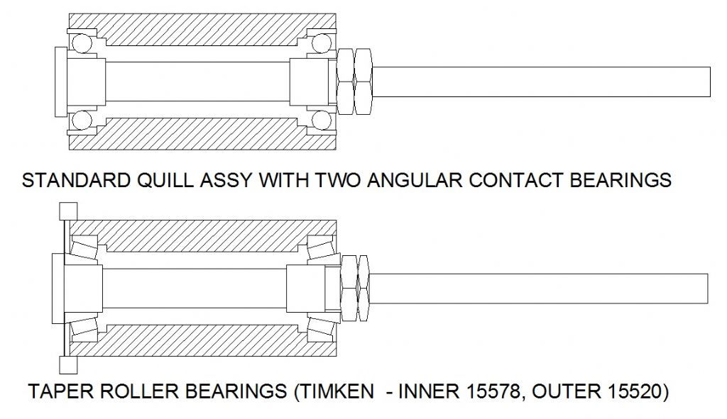

                                                    #246595
                                                    Glyn Davies
                                                      @glyndavies49417
                                                      I replaced the angular contact spindle bearings on my Mk1 machine with taper rollers. It's a straight swap apart from the need to thin one of the lock nuts and make a new swarf shield from an old slitting saw:
                                                      Edited By Otley on 14/07/2016 11:38:53
