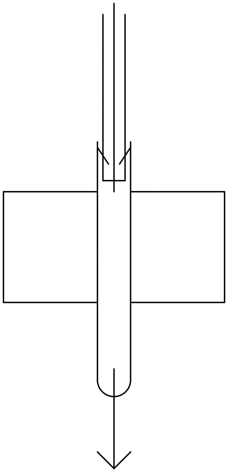

                              It depends a lot on other details. If the hole can go right through at 7mm, consider making thin barbed semi circular (or less) splints that grip the insulation. Feed these through the hole and pull. You need to put the insulation in stretch mode. This supposes it is rubber like, not semi-rigid. The splints should act to compress the insulation, forced down by the sides of the hole. You need to go too far to release the splints, then draw back wire to final position and bung hole.
                              I have had poor success pushing wire into tight holes, the insulation merely expands to block progress.

                                  If you are trying to push it in I doubt you will succeed unless the hole is oversize, if you want it a tight fit I would drill all the way through the delrin then plug after.
                                  Pull the HT leads through (taper the end as a lead in), if you have some braided sleeving slip it over the end (lubricate with silicone) and use that to pull it. Cut the end off and then pull it back to allow plug fitment.
