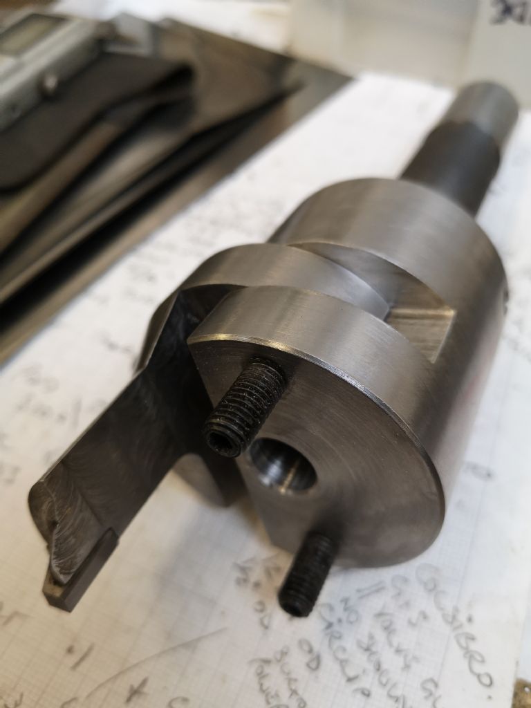

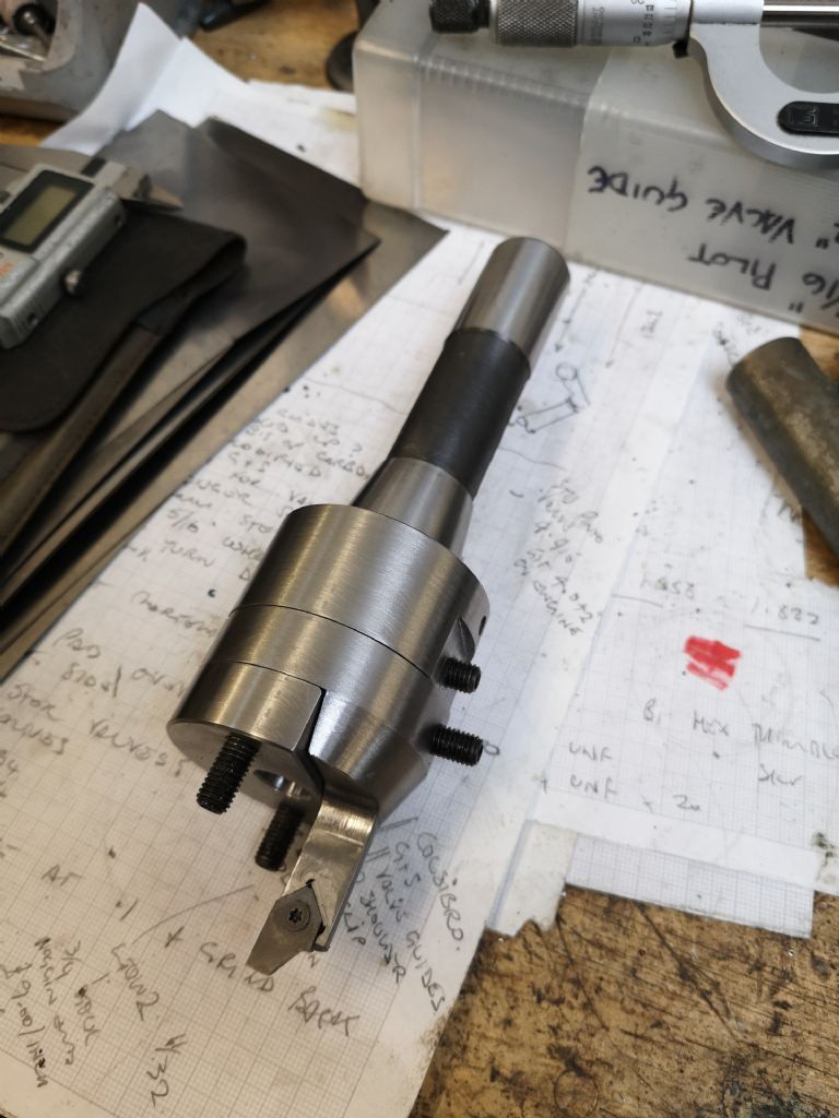

                        img_20220128_114414.jpgHere is the tool holder finished (probably). It is a bit like a boring head but cruder in that it is set to a gauge rather than having a micrometer screw, also it needs to show a concentric bore on the bottom at all times to allow a pilot to be mounted which locates in the valve guide, hence the horseshoe shape.
                        The pocket for the insert was machined on the CNC machine. I glued the insert in as suggested, then clocked up the hole in the tool. I moved 3 thou toward the back of the tool holder, and drilled and tapped M3. The result was terrible for some reason and I ended up soft soldering some shims in the pocket to sort it out. Not sure why it went wrong, I suspect the tapping size hole drilling was not stiff enough somehow….. I will try harder next time.
                        Ian
