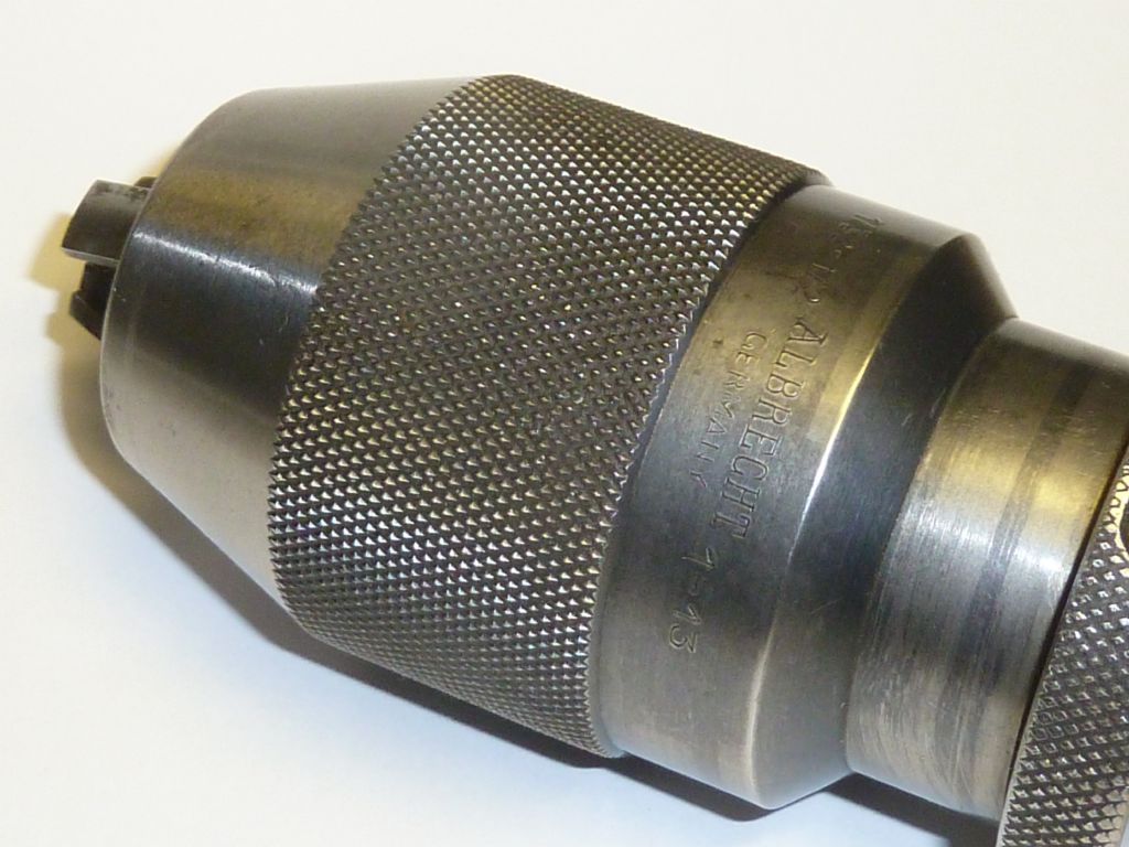

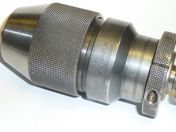

                  Like Albrecht chucks, the main outer section is in two halves, threaded together (see the link from MichaelG). It seems a point of honour for the join to be made almost totally invisible. The two halves can be unscrewed, but are very firmly tightened. If you do not wish to mangle the diameters, you need to make well fitting tooling to grip the each section. One way is to make closely sized aluminium blocks which fit round after being sawed into halves, used to clamp one section in a vice, and the other section with say vice grips. If you have curved jaw vicegrips then first wrapping a piece of aluminium sheet may allow them to grip without damage.
                  But the classic tradesman`s way is a Stilson and cold chisels.
                  PS Rohm chucks tend to start of very tight, but after several months use become smooth operating. In my experience they are considerably better than the limits Rohm specify for concentricity.
                  Edited By Macolm on 13/04/2023 11:37:12

                      Agreed a single slit togetther with a precise diameter works very well to grip a similarly accurate diameter. The problem with keyless chucks is you need to clamp either on the knurled diameter, or to assemble the grip on a smaller diameter past the maximum one. In both cases, two halves also allow best distribution of the clamping force, eg when clamped in a vice.
                      Another option is a chain wrench such as the Visegrip type, but this still needs something intermediate such as aluminium sheet to avoid marking the chuck.
                      You can see how well the join is disguised!
                      Edited By Macolm on 13/04/2023 15:23:41

                                The normal Albrecht chuck can be completely dismantled after unscrewing the hood piece and removing the collar. You are well advised to do this over a tray to catch the loose balls. As far as can be deduced, the Rohm chucks indeed have balls introduced via a fill hole which is plugged. That being the case, removing them all to get the parts separated might be difficult.
                                Anyway, I think it is quite possible that the plain bearing surfaces between the shell and body might have tight spots when new. Once "run in", there is no appreciable slack,so it must be a very close fit.
                                Incidentally, by dismantling either make far enough to unscrew the spindle, you get enough access to press out a taper mounted arbor.
