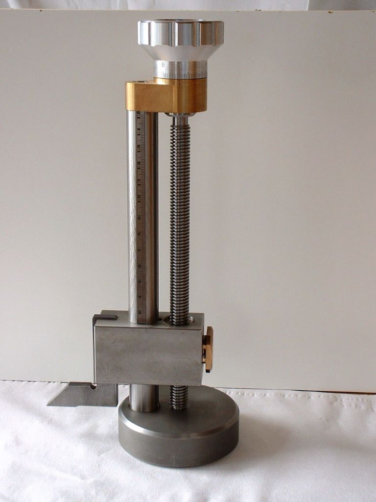

                              I used to have a digital Height gauge, but going into the workshop at this time of the year the numerals were as difficult to see as the lines on my old Vernier version.
                              I decided to make my own, and in a size which better suits my needs. This is easily as accurate as my other two units and much easier to read.
                              The cost was one needle roller race and a scale from a cheap depth gauge. The rest came for the scrap box or from materials in-stock.

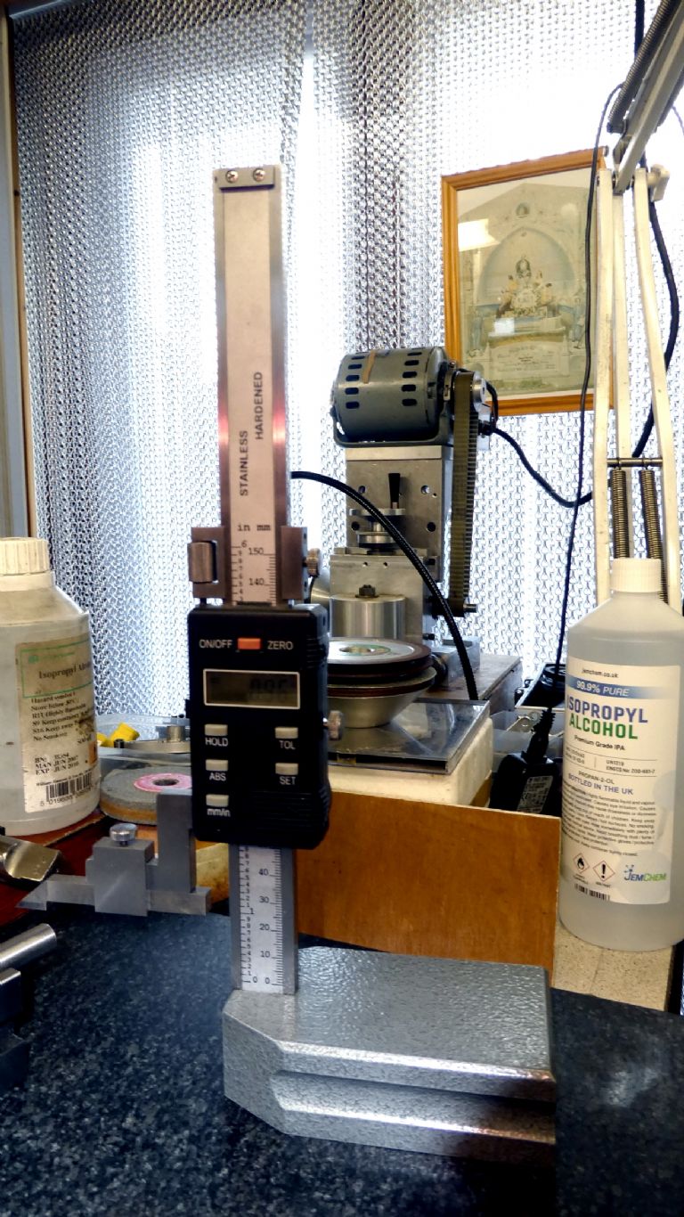

                                        I bought this 150mm digital unbranded version new and cased from a bloke standing behind a pasting table in the middle of a field one gloriously hot Sunday afternoon some years ago – £30 if I remember correctly. It is smooth, accurate, very reliable and a pleasure to use. It lives and works for most of the time on top of a 12" square granite inspection plate (another car boot acquisition) where used in conjunction with a box of older Matrix imperial slips I can – for instance – mark out in confidence without having to rely on my ropey old eyes.
                                        I would recommend one with a carbide scribing jaw for obvious reasons and try and remember to turn the power of after use, that way the battery will last "forever".

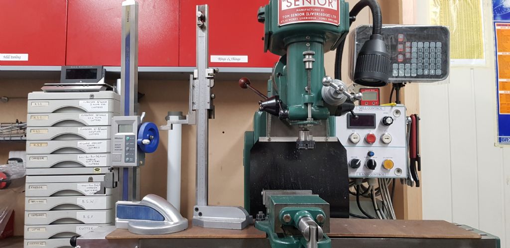

                                                  These are 2 Mitutoyo 500mm 20" that i picked up cheap. One of each. But i could not say which i would choose if buying new. Although the left one would cost an arm & leg.
                                                  Steve.

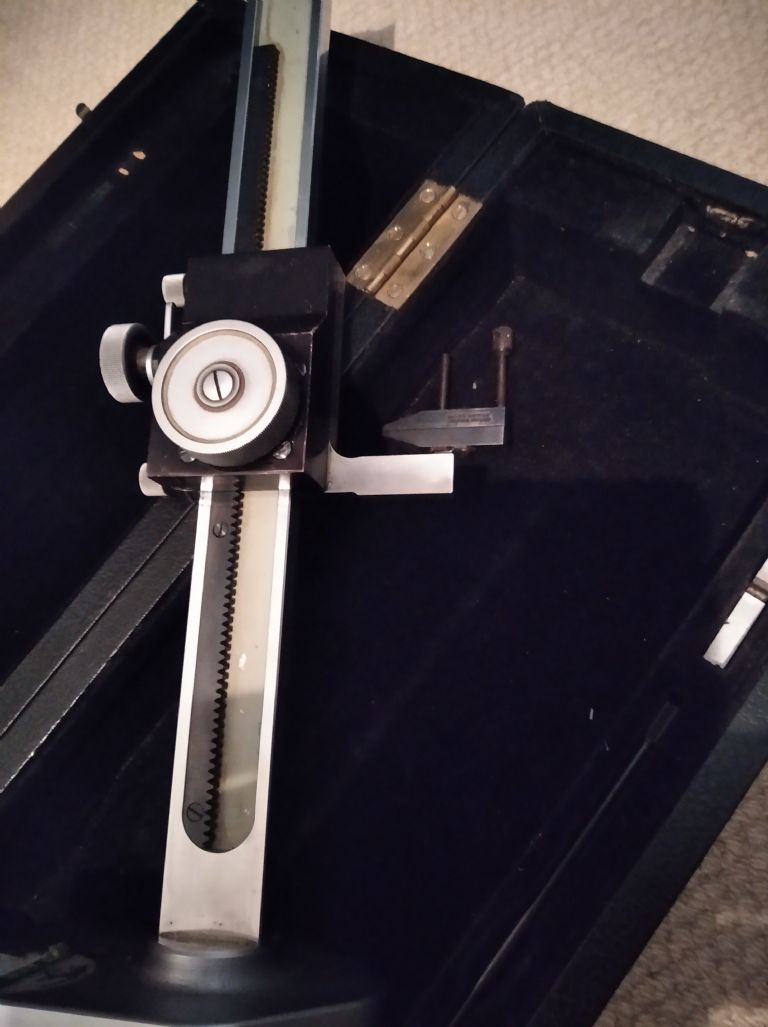

                                                    I was given a vernier hight guage some years ago when our workshop went digital. At 18" it's a little large for my surface plate but I would not change it for a digital just to acquire the ability to zero set. I does take a little longer to set by vernier than glancing at a readout but then it's not called on for use that often so what the heck.
