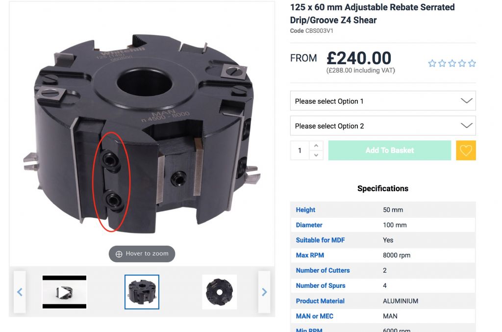

                        Mark Easingwood
                          @markeasingwood33578
                          I don't know about their use in engineering tooling, but, the ones in your first picture are used in spindle moulder tooling, (wood machining), along with an olive, (cone shaped nut), to hold the wedge, which locks the knives into the block.
                          It is not very obvious how they are used from the links below, I can takeyou a picture on Monday if you want.
                          Screw
                          Olive
                          Mark.
                          #619062
                          Mark Easingwood
                            #619068
                            David Davies 8
                              @daviddavies8
                              Good morning.
                              We use them at work to hold a carbide insert into the toolpost of a scarfing machine on a continuous ERW tube mill.
                              I recently bought some spare ones for the machine and Sandvik do indeed list them under the name 'differential screw'
                              I assume that this is the literal translation to English from the makers mother tongue.
                              Cheers
