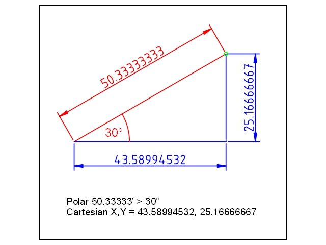

            Oh dear, I'm going to disagree with Michael and Andrew. I believe cartesian and polar coordinates are completely interchangeable. This could end in tears!
            Consider this example where the centre of the green circle is defined in both polar and cartesian terms. The Polar definition in Red, Cartesian in Blue.
            Now, although 30 degrees happens to be an integer, the distance to the green circle isn't. It's 50.3333 units recurring, which as drawn by QCAD can only be expressed to 8 places of decimals. At the same accuracy, the triangle defines the X coordinate as 43.58994532 and Y as 25.16666667 There's no particular reason why the distance in a polar coordinate need be a round number. Both cartesian and polar dimensions have the same limitation.
            Consider also how 30 degrees in defined. As a convenience we think of it as a segment of a circle divided into 12 equal parts. In practice, dividing a circle isn't an accurate operation, in fact the best way to do it is to calculate the tangent to as many places of decimals as needed, and then to lay out the angle over a large baseline. Dividing Y by X is the tangent of the angle, and tangents can be calculated to as many places of decimals as reqiired.
            I suggest the accuracy of both coordinate systems is decided by the limitations of the calculator, human or machine, not by the nature of coordinate systems themselves. The limits can be large or small – when calculations were done manually, Four Figure Tables would limit the accuracy of tan(30) to 0.5774. Now the bog standard MS-Windows calculator makes 0.57735026918962576450914878050196‬ available, and – if needed – far more accuracy can be delivered by an arbitary precision package like mpmath.
            Given enough number crunching Polar and Cartesian coordinates can be interchangably expressed as the other. Which one gets is used is surely a matter of convenience. Navigating a ship using Cartesian coordinates is unnatural, whilst laying out a job on a milling table with polar coordinates is clumsy.
            If the number system happens to to fall nicely on round numbers for a particular position one might look better than the other, but given enough positions don't both systems fail to be spot on with equal frequency?

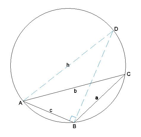

                                  Gary Wooding
                                    @garywooding25363
                                    Just to dot all the 'I's, here is my 'proof' of Nick's solution.
                                    It depends on two properties of chords in circles, and the Sine rule of trigonometry.
                                    1. All angles subtended on one side by a chord to any point on the circumference are equal, so in the diagram, angle C equals angle D.
                                    2. If the chord is a diameter, the angle is 90°, and conversely, if the angle subtended by a chord is 90° then the chord is a diameter.
                                    3. The Sine rule states that, for any triangle, Sin A/a = Sin B/b = Sin C/c
                                    In the diagram, A, B, and C, are the three random points, and the circle is their PCD. You want to calculate the length of its diameter.
                                    Choose any side of the triangle ABC (side AB in the diagram) and draw a perpendicular line from one end to to meet the circle. This is the dashed line BD.
                                    Because they both come from chord AB, angles C and D are equal, so SinC = SinD.
                                    But SinD = c/h, so h = c/SinD = c/SinC
                                    But angle ABD is a right angle, so h = the diameter of the circle.

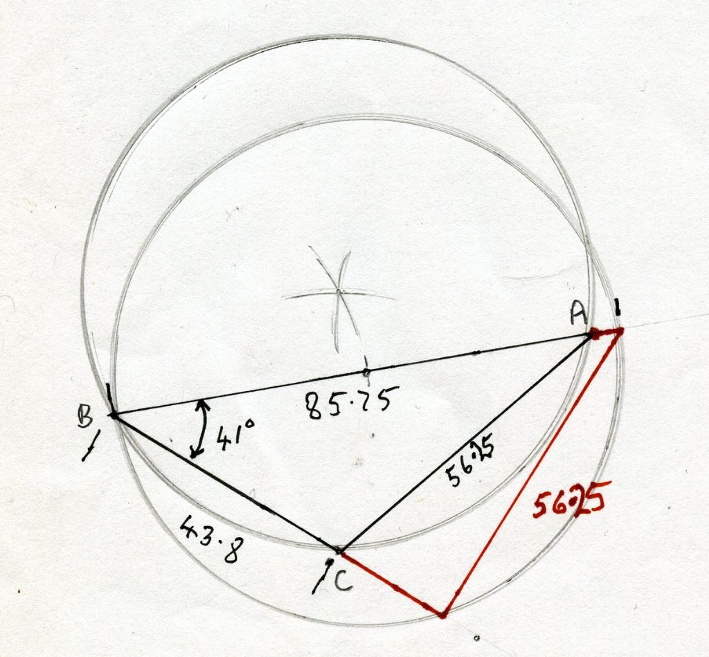

                                    #433132
                                    Nicholas Farr
                                      @nicholasfarr14254
                                      Hi Gary, a better way of proving the Sine rule works for the example 26 diagram is shown below. This is a half size one but the relationship between the angle and the length of the two sides shown are the same. This shows the integrity of the 41 degree angle and the lengths of the original sides and should help show those who don't quite understand how it works. The extended line B-A becomes the diameter of the PCD for A, B and C and a new PCD drawn on the centre of this line will show the Right Angle Triangle with the red line at a right angle to line B and C and it will be noticed that the new PCD will pick up both ends of the red line and point B.
                                      Excuse the makeshift real world drawing, all the dimensions are close to those actually calculated.
                                      Regards Nick.
                                      Edited By Nicholas Farr on 13/10/2019 18:18:25

                                              Posted by Nicholas Farr on 13/10/2019 18:14:19:
                                              Regards Nick.
                                              That's excellent & elegant.
                                              #433190
                                              Nicholas Farr
                                                @nicholasfarr14254
                                                Hi Neil, thanks for your comment. The drawing is a bit rough and ready, but the 41 degree angle and the three points were set quite accurately and I think it shows what might seem to be an obscure triangle.
                                                Regards Nick.
                                                #433204
                                                duncan webster 1
                                                  @duncanwebster1
                                                  Posted by Gary Wooding on 13/10/2019 10:38:21:
                                                  That's really elegant, but just to be pedantic, don't you need to use the cosine rule to find angle C to start the whole thing off rather than sin rule
