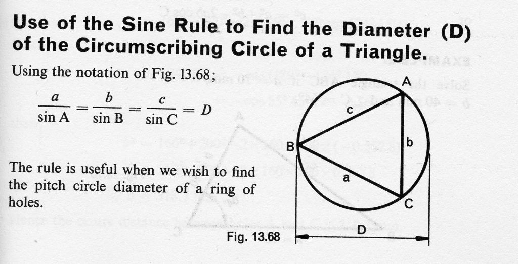

      Dave (S.O.D), look up 'sine formula'. Not all trig needs right-angled triangles…
      Good clue: Wikipedia gives an explanation of the Law of Sines and this diagram (credit) shows where the diameter comes from:
      Although I understand it now I shall have forgotten everything by bedtime. Sad isn't it.

        Posted by SillyOldDuffer on 11/10/2019 11:26:56:
        I can do trigonometry on right angled triangles, but ABC isn't right angled.
        Draw a right angled triangle with AC as its base, and the other vertex, E on the circumference and A as the right angle.
        The line CE is now a diameter, as the hypotenuse of a right angled triangle in a circle is always the diameter.
        So from trig AC / CE is sin e
        As CE = D and AC =B then, if the formula is correct, sin e = sin b.
        Who can do the geometry that proves e= b ?

                Hi S.O.D., I guess I should have filled you in with the proceeding piece of text to example 26 above, which is;
                Of course you need to understand the Sine rule, which I'm a bit rusty on now having not used it for a long time. Apologies if I've confused you and others of course. This rule though, would have solved Paul's question also, but the other diagram was already in my album.
                Regards Nick.

                    Posted by Nicholas Farr on 11/10/2019 13:43:53:
                    Hi S.O.D., I guess I should have filled you in with the proceeding piece of text to example 26 above…
                    This rule though, would have solved Paul's question also…

                          Being simple, I drew a circle with three chords 65 mm long. Then a 30/60/90 degree triangle, with one side being half the chord = 32.5 and used Sine or Cosine to calculate the Hypotenuse. Then doubled the answer to get the diameter, which my calculator said was 75.055535, if you want be frightfully accurate. Me? I'd settle for 75 as being about as good as i could get, although I might set the machine to 75.06 mm or 2.955 inches in old money.
                          That is about as complicated as my puny brain can tolerate.

                              I just looked in the Zeus book and took the figure for the distance between two holes in a three hole pattern and with a bit of simple maths got
                              1/0.86603 x 65 = 75.055
