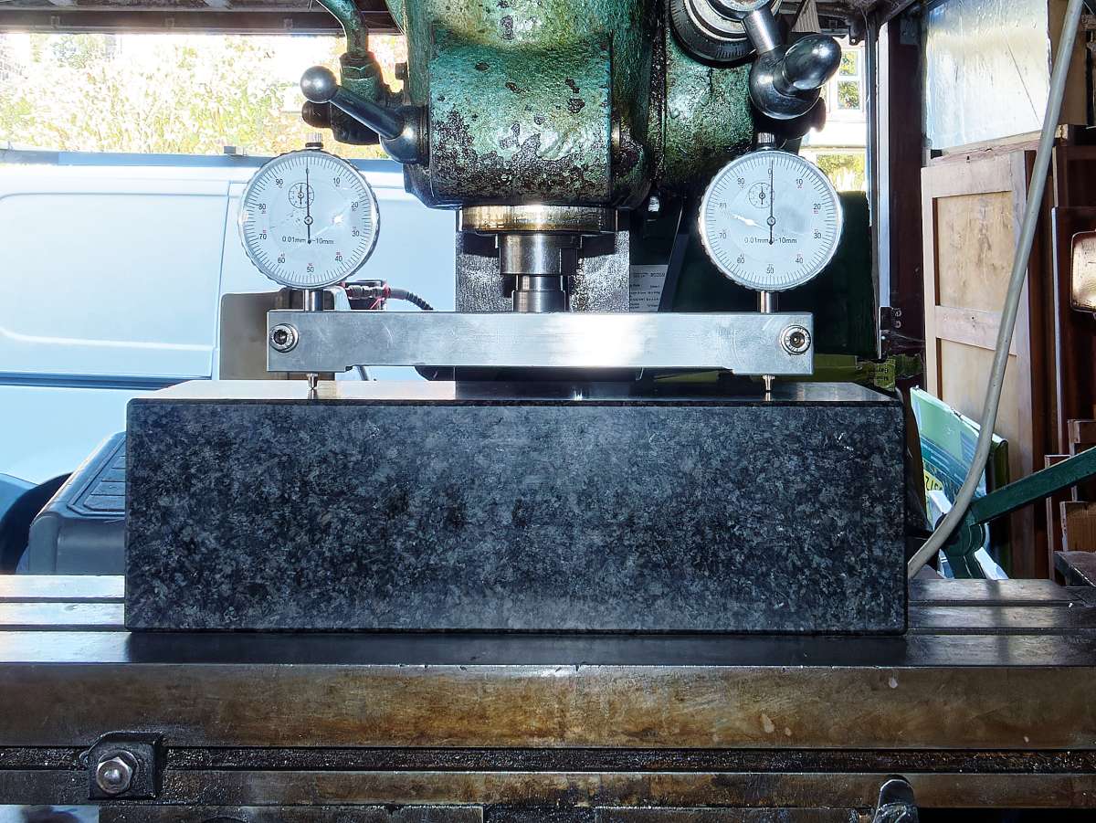

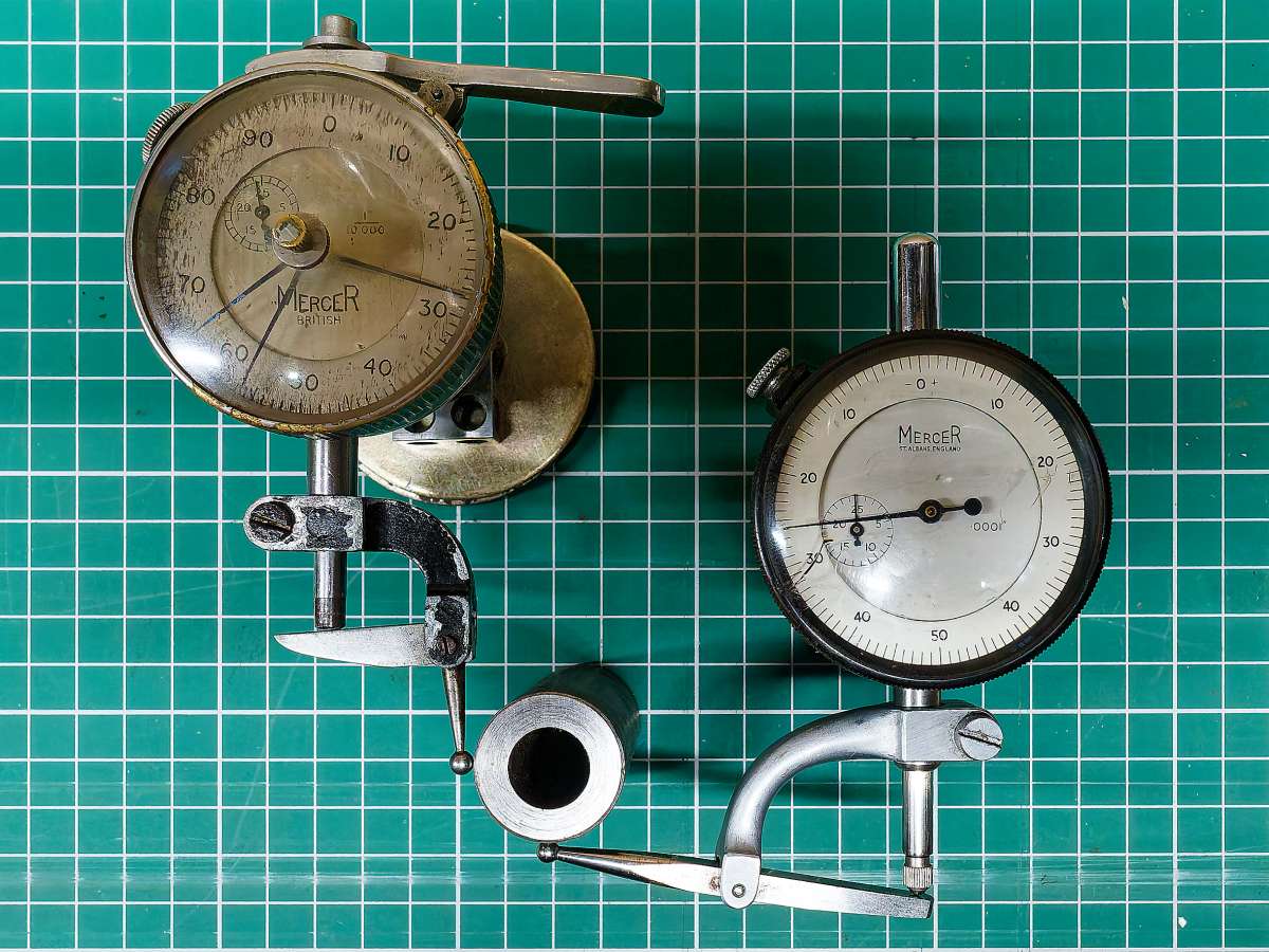

                  S9270091_DxO-Flickr
                  There’s more than one way to skin a cat, though no felines were hurt whilst setting this quick lash-up from some of my more tatty examples.
                  E6260032_DxO-Flickr
                  In spite of their appearance, both these clocks work fine, one has a very light action, the other needs a fair push, and thus a very rigid mounting; the lever attachments are available in straight and right angled varieties.
                  Beware wobbly levers in second hand DTIs though.

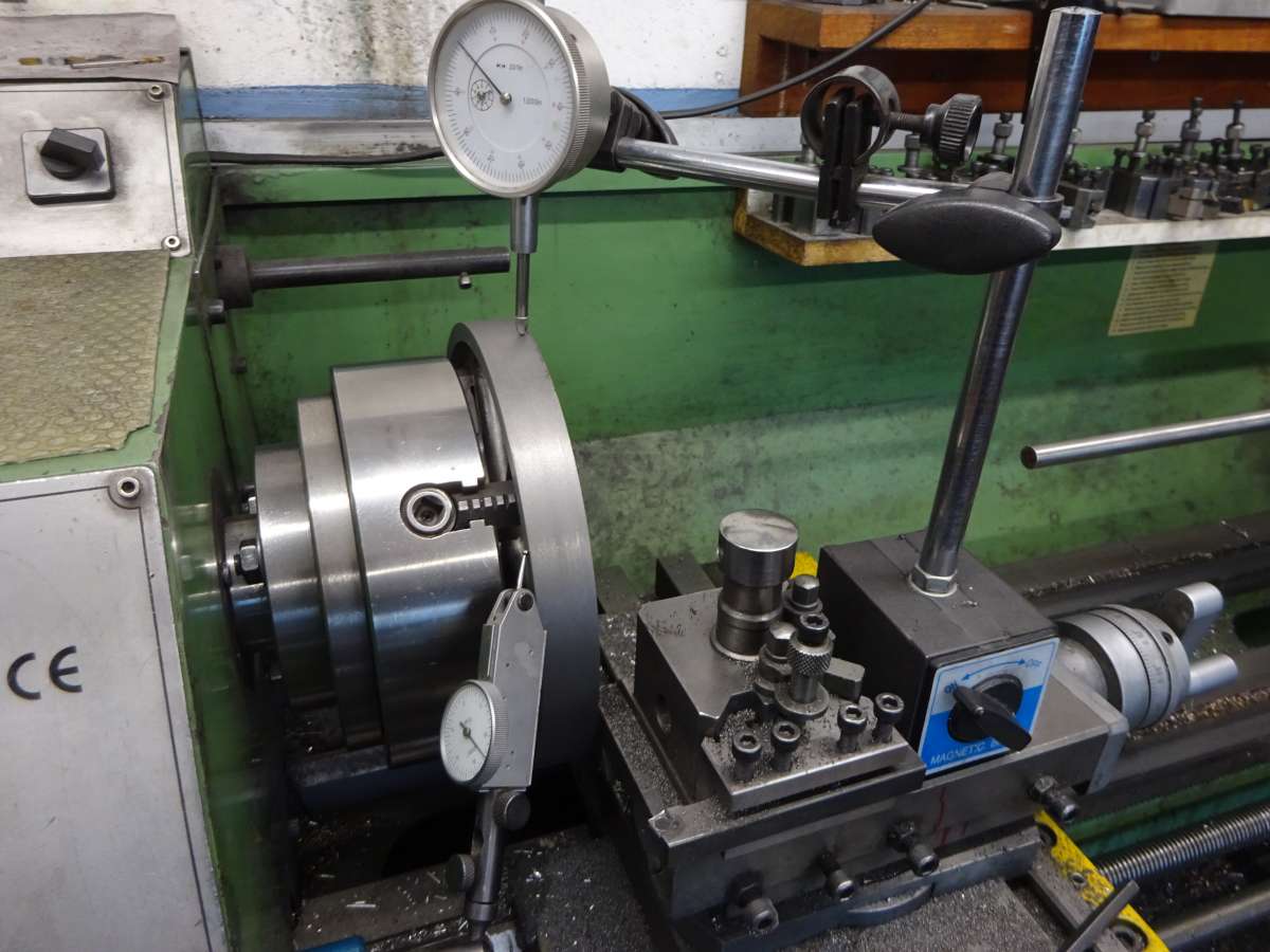

                              I suppose anyone having difficulty deciding which of the two to get due to funds will be looking at the far eastern ones rather than a £200 name brand one. The time one will last is really based on amount of use so one in a commercial enviroment may see a lot more use than a hobby workshop.
                              My main use of the plunger is setting the 4-jaw. Either setting a ctr mark/hole to minimal runout but also if it is an eccentric that I am turning I find the larger range of a plunger can be used to set the work to give the actual eccentric movement. this is why the plunger one lives with it’s mag base stuck to the headstock.
                              Sometimes it is just nice to have both

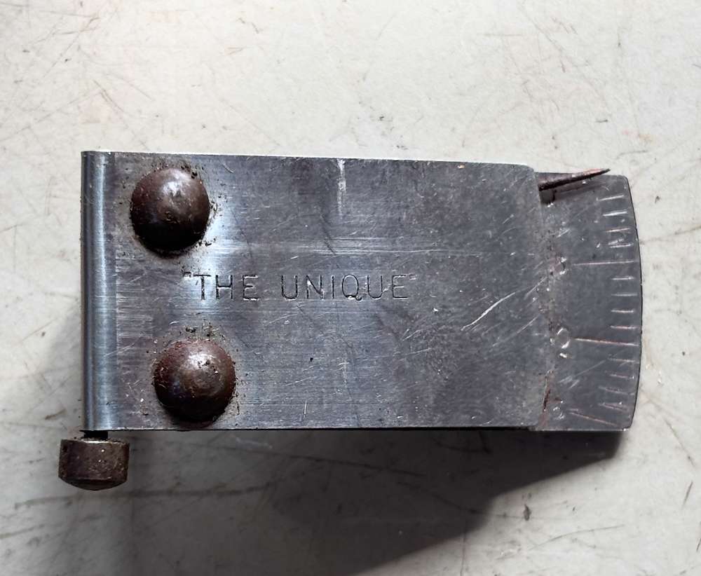

                                                    Unique Indicator R
                                                    My starter that came in the box of bits with a “2 packs of Players and 3 beers” Portass “S” lathe.
                                                    2 bob back in the day I think.
                                                    Calibrations are 1 thou. I checked it and got a tenth or less error over the middle 5 thou. Not quite so good at the ends but still well within useful.
