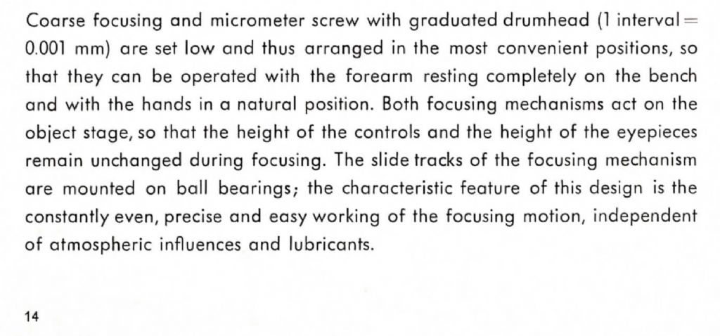

            Many of the decent optical microscopes from the middle years of the last century have focusing mechanisms graduated in one micron divisions … your stated requirement therefore seems relatively trivial, Joe

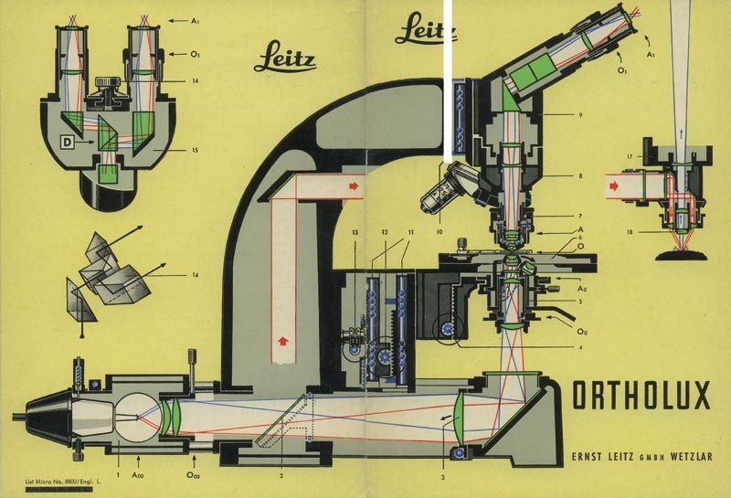

                      I have a scruffy old Leitz Ortholux stand [just the bare mechanicals] which, if you can arrange collection, is yours for free. It is filthy dirty but I have just tried the fine focus mechanism and it works very smoothly.
                      Please contact me by message or eMail if I can help … but don’t dismiss the idea too quickly: it really would be the easy answer.

                                    Posted by Michael Gilligan on 01/04/2022 10:56:58:
                                    In all seriousness, Joe
                                    Thank You for your Kind offer Michael. I would really like to take you up on it, but shipping tween Nam and the World is so expensive – Unless by 'mail' and a lot of that sort of mail parcel is simply 'lost' in Johannesburg – So I tend to only use Fedex/DHL air ship – a 1kg parcel from London to me is around 120 BP…
                                    Thank You…
                                    Joe

                                                As I said earlier, Howard … In the context of Joe’s requirement, the measurement is trivial and can be easily achieved with seventy year old mechanisms.
                                                It is perhaps not intuitively obvious, but: whilst measuring a metre to +/- half a micron may be difficult, measuring a millimetre to to +/- half a micron is easy.
                                                Edit: __ This is the model of instrument whose basic stand I was offering to Joe
