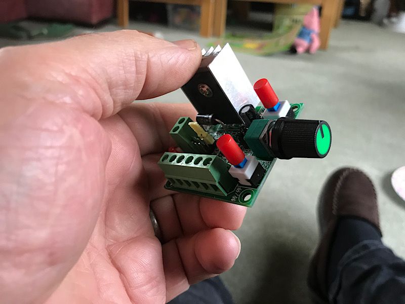

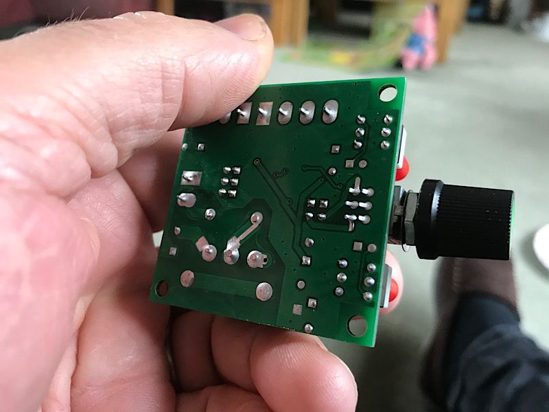

      How do people desolder components?
      i have a circuit board with a couple of small switches that i want to remove and place remotely…so not wanting to use the removed switches..
      the board is double sided
      the switches have 6 wires all told on a 8mm square grid
      how best to go about it?
      I’ve got a solder sucker and desoldering tape but never had much luck with using either

          This is the board in question as you can see the switches are hard to the board

                        It’s double sided with very small tracks and it’s a dpco switch

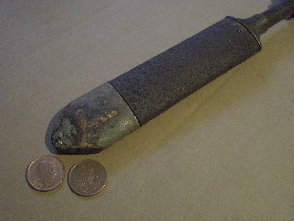

                                Like many things in engineering desoldering is counter-intuitive.
                                To start with use a proper soldering iron at a good temperature. My Weller iron is 80W and I run at 360°C. Forget solder suckers and braid for desoldering. It doesn't look like the switch leads can be cut to start with. First add solder in two beads down both sides, each covering three pins. Then melt one bead and push on the switch, it should tilt slightly. By melting alternating sides you can work the switch out far enough to get one side completely out, or at least cut the leads on one side. A high wattage iron helps as you want to go in, melt the solder and be out again in a few seconds. A low power iron that takes ages to heat up is useless. Although not relevant in this case a multilayer board with internal planes will need even more heat to melt the solder quickly. Once the leads are seperated it is simple to remove them one by one.
                                After the switches are removed you can clean up the board. Solder braid is great for surface mount pads, but isn't that useful for thru hole. To clean up with a solder sucker add solder until the hole is full. Then melt the solder and suck! Solder suckers are ineffective at cleaning partially filled holes as it isn't always easy to get the solder properly melted. Filling the hole first makes it easy to melt all the solder.

                                                It's not just temperature but the amount of heat. I'd guess that one is 250W so plenty big enough! I've used one that size once to solder copper busbars, carrying several hundred amps, in an inverter.
                                                I've recently acquired it's baby brother, a Weller 100W iron from an ex-colleague who was closing down his acoustics and vibration consultancy.

                                                      Yes i did manage it eventually
                                                      I’ve been messing about with electronics since the early 70’s full subscriber to practical electronics for all the 70’s then on to a degree in electrical and electronic eng
                                                      i’ve got irons from 10watts to 200 watts
                                                      but suddenly i find modern boards so difficult with smc and double sided boards…I never thought I’d get to the stage where i cant read a resistor colour code now i can hardly see them (smc that is)
                                                      anyway the switches were slightly strange in construction (flipped from side to side) the tracks were extremely fine <0.5mm and where the pad was connected to a large mass on one side it was very difficult getting heat in to both sides at once
                                                      I’d destroyed the switches but carefully metering the contacts enabled me to trace the wiring sense of them and soldered in flying leads along to panel mounted switches
                                                      after all this the circuit still works (surprise)
                                                      Its a stepper motor driver controller for a camera slide rail I’ve made up fro video use…but the way those switches are mounted and used made it impossible to mount in a case.
