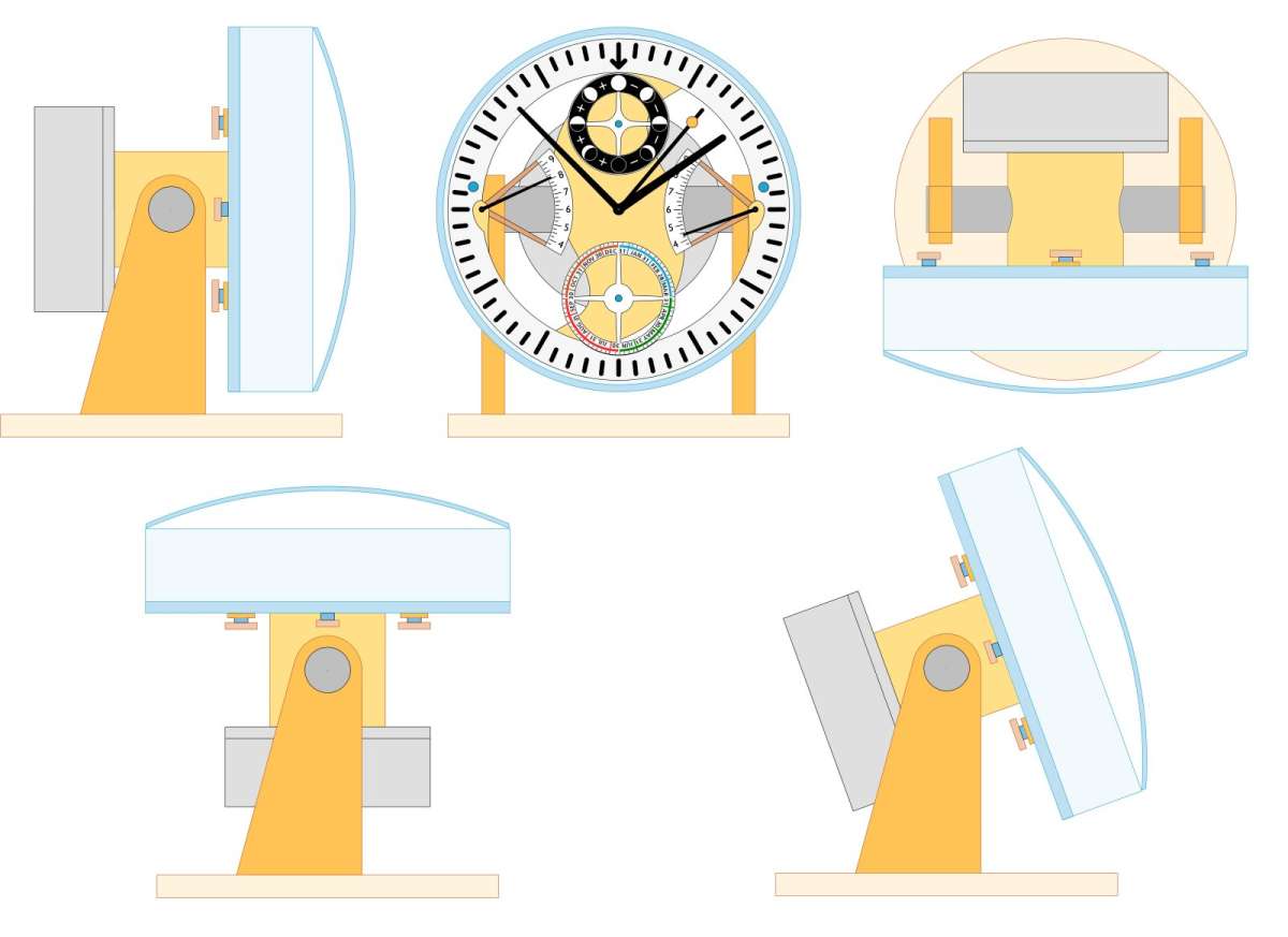

      I wanted to make a clock of my own design during my retirement. I had a good idea of what I wanted – a desk/table clock with a few complications.

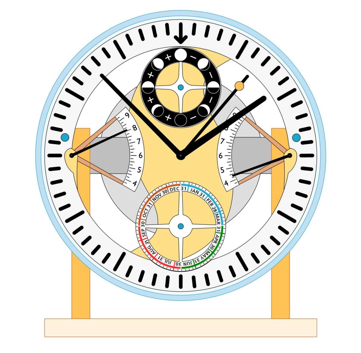

      This is the general layout-
      View 1
      Central hour, minute and local solar noon hands. There’s a moonphase at the top and annual calendar at the bottom. Sunrise on the left and sunset on the right. The sunrise/sunset quadrants can be manually set, from the back of the clock, for GMT and BST.
      The dial section will be in a glass and clear acrylic case and the whole thing supported on a gimbal arrangement.
      Here are some drawings. For scale, the dial is 150mm diameter.
      View 2

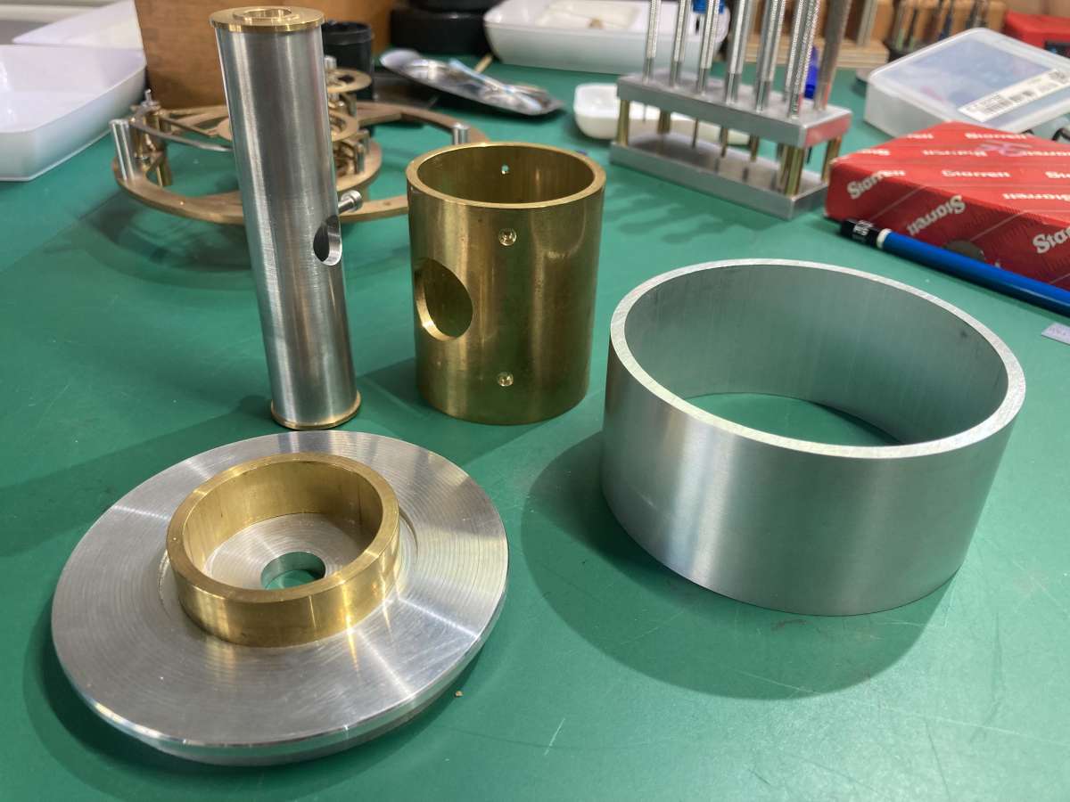

      The movement lives in the cylinder at the back and drives the wheel train via a shaft that turns every 12 hours.
      The whole design is inspired by Jodrell Bank radio telescope which I used to pass a lot as a kid.

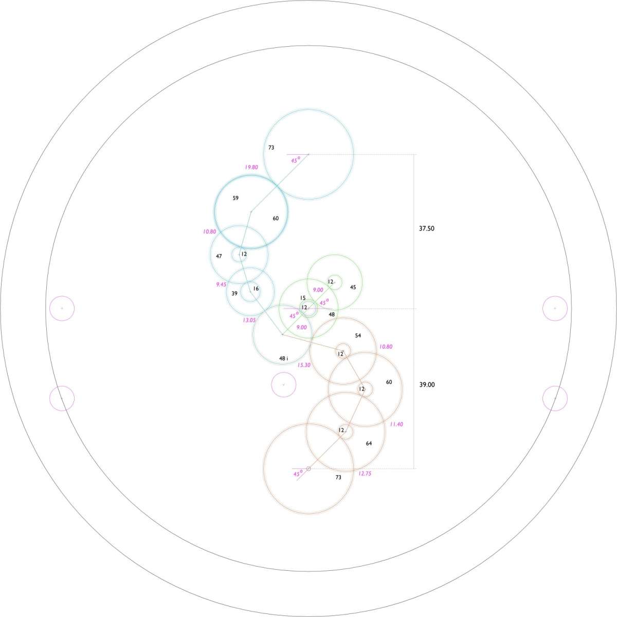

          This is the wheel train-
          Wheel Train 1
          It is driven by the hour hand shaft from the movement. The motion work is in green, lunar train in blue and annual train in brown. Black digits are tooth numbers and pink are theoretical depthing dimensions.
          All gearing throughout the clock is Mod 0.3 involute.
          The reason for the long gear train for the moonphase is not a case of chasing accuracy. It’s because I’ve tried to balance the length and shape with the annual train for a symmetrical effect. Note that both train terminate on the same size wheel – 73 teeth.

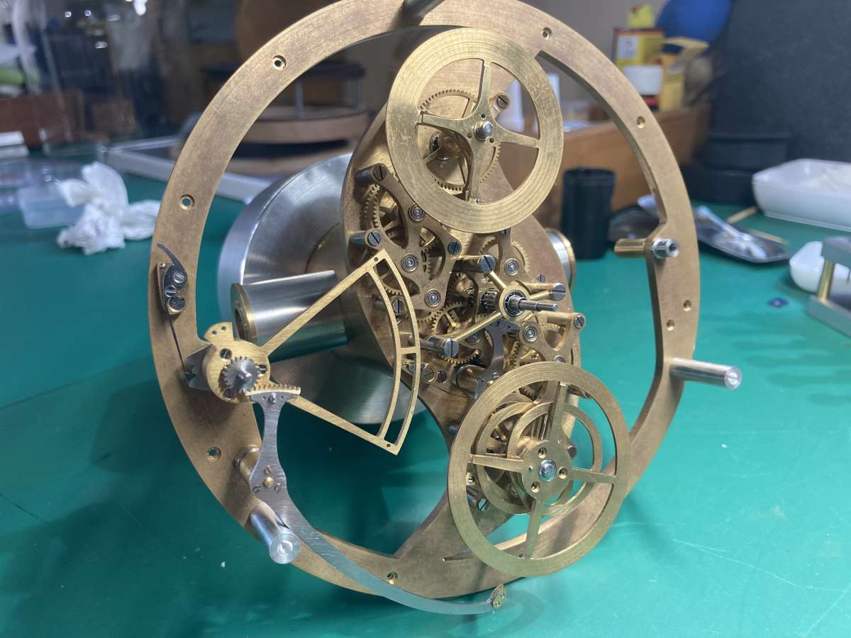

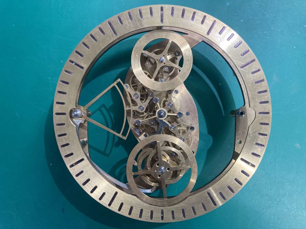

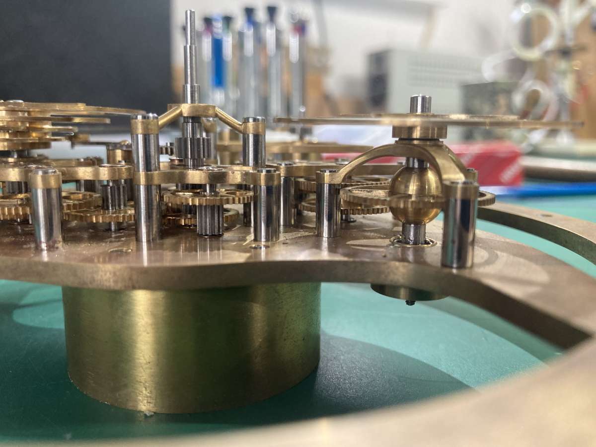

            And here is where I am so far-
            IMG_1230
            I’ve made and tested nearly all the mechanical parts. I need to make a return spring for the sunrise cam follower and a few bits and pieces before installing the sunset side.
            IMG_1227
            IMG_1235
            Steve

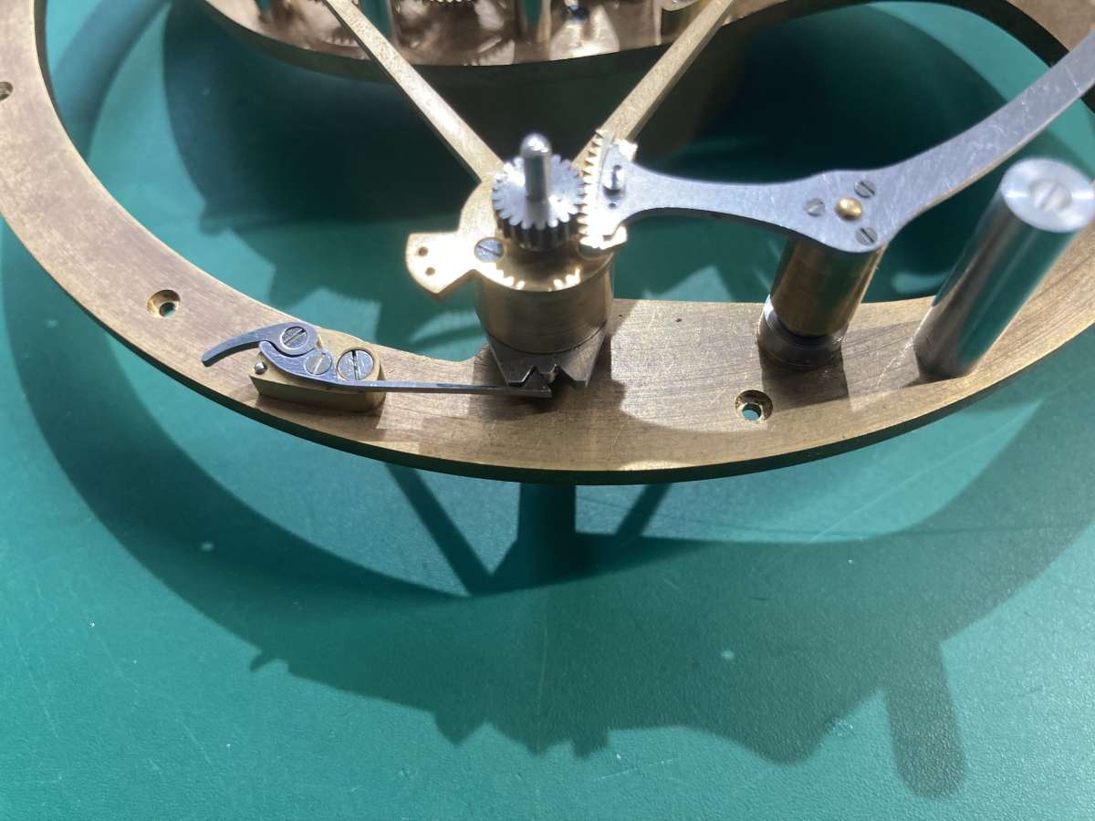

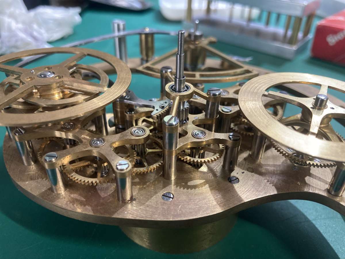

              The GMT/BST selector spring. Tension can be adjusted for a satifying click.
              IMG_1215

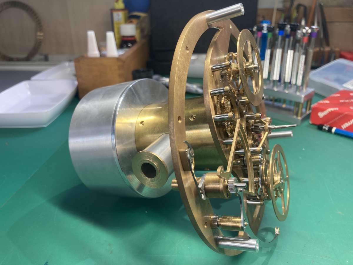

              All pivots run in ballrace bearings at both ends mounted in bronze bushings (chatons?). The cam follower run in bearings too. They must be over 30 in the clock, I’ve not really counted.
              IMG_1217
              And a side view with moonphase on the right.
              IMG_1219
              And with the dial. Apologies for photo quality.
              IMG_1222

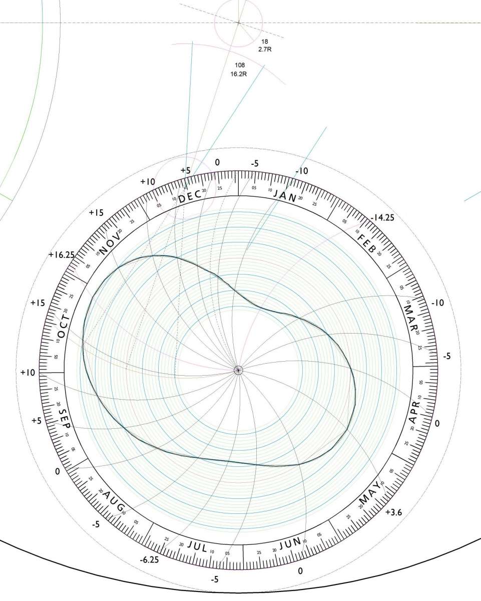

                Very nice Steve!  I was meaning to ask how you computed and formed the cams?

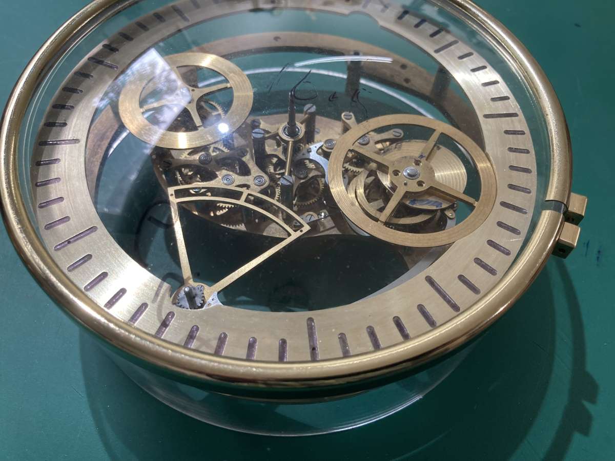

                  With glass, bezel and case.

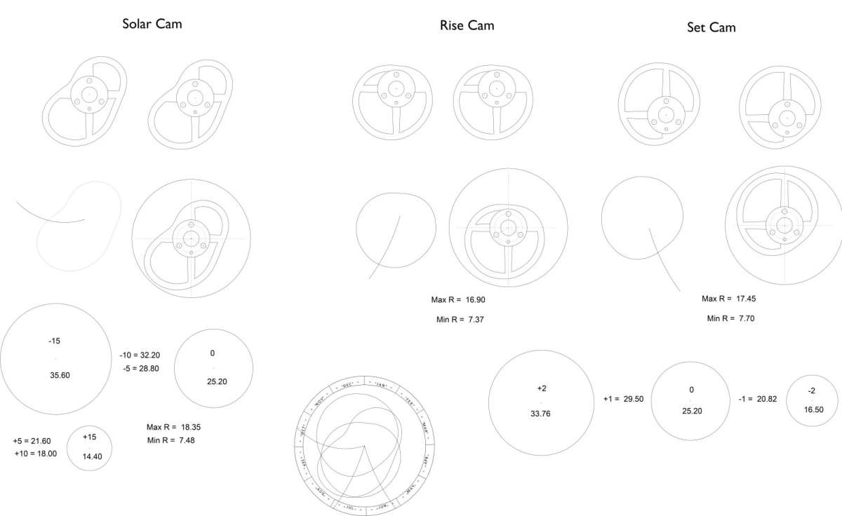

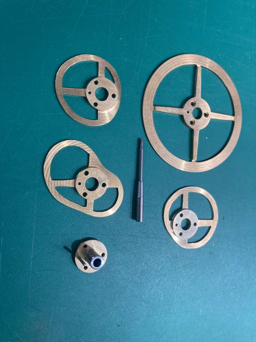

                    As far as the cams go, here is how I plotted the EoT cam. The numbers on the perimeter are the EoT deviation, offset to take into account of the follower position relative to the dial. The others were done in a similar manner.
                    EoT train layout 5
                    Once I was happy with the plot, they were printed to size for stencils and filing guides. I also made some circular calibration gauges as all 3 cams have the same “zero” or index diameter, if that makes sense.
                    Stencils are stuck to 2mm brass sheet and very lightly prick-punched a tad over size. Cut out with piercing saw then file to shape before facing and turning to profile. The cams themselves are 0.8mm thick and the boss is 1.8mm.
                    Cam Stack 03 print
                    After that, They are tested on the clock using temporary hands with light filing to get things right.
                    Then they are crossed out.
                    IMG_1211
