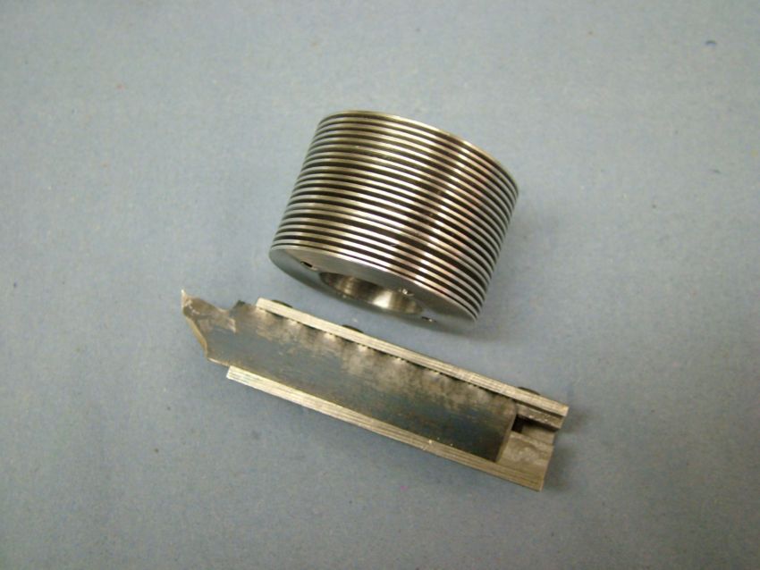

              I made one for doing some deep fins on a cylinder head. I don't have any dimensions to hand but this is what it looked like. The blade was clamped by small cap head screws, the holder then held in a Dickson Quick Change Tool Holder as normal
              It's quite a while back but I think I hand ground the end of a slot drill to give the slight angle (dovetail) on both lips which worked well enough to give a good grip on the blade.
              Hope that's of help

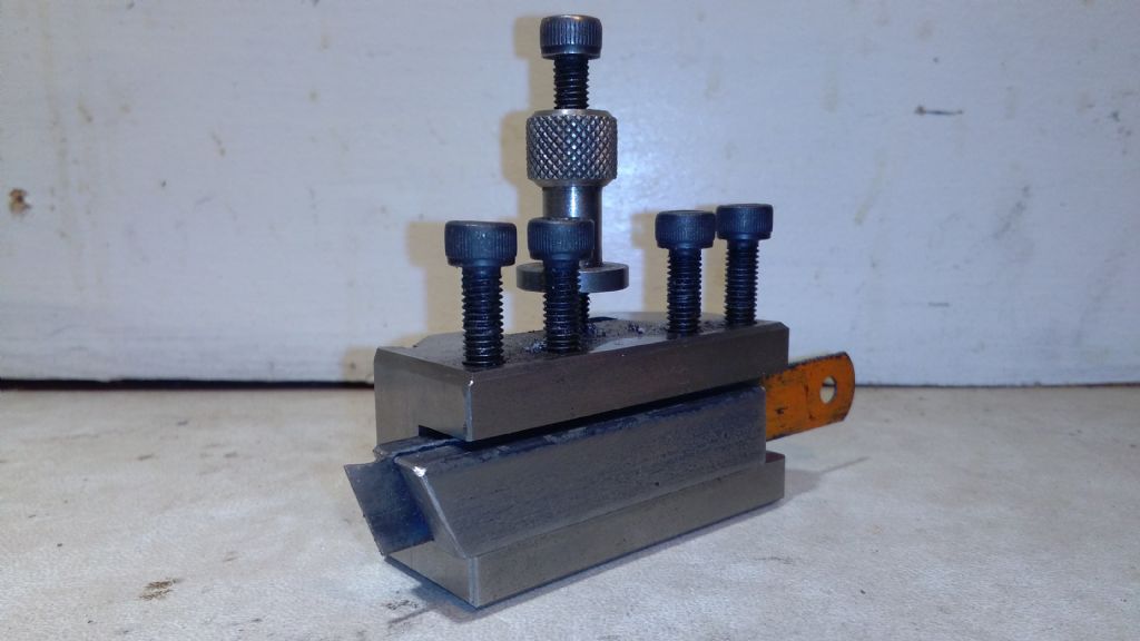

                  Here's my home made holder. Made from 1" x 1/8" and 1" x 3/16" BMS held together by 4 x 4 BA csk. skt. head screws.
                  The blade sits across the 2 lower screws. I use it a lot for small stuff including steel.
                  It will easily part 1/2" dia. brass.Sharpened in seconds of course.po holder.jpg

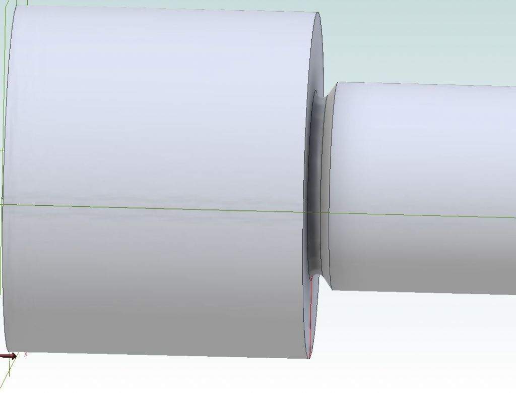

                      Must admit that for the purpose of undercuts that the OP wants to do I've taken to using a DCMT or DCGT insert to do both the initial turning and then the undercut which saves having to change tools and also gives a nice rounded fillet to the root of the undercut which should be a lot stronger than a square cut one.
                      undercut.jpg.

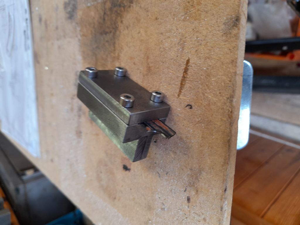

                                What a good idea. After reading this I have made my version. As someone who struggles with wider parting tools I found this easy to use. Think I will alter it to change the screws to countersunk heads to get closer to the chuck jaws. Sorry if the picture is wrong way round.20220801_122719.jpg
                                GeoffT
                                Edited By JasonB on 01/08/2022 19:07:37
