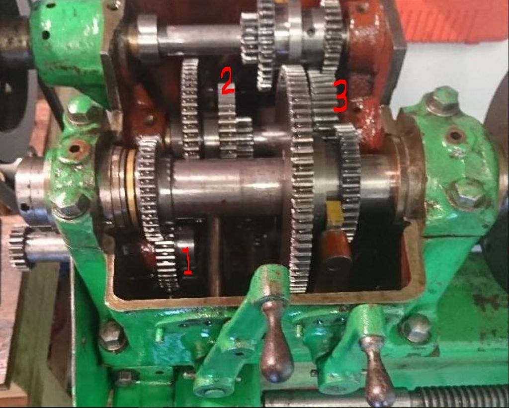

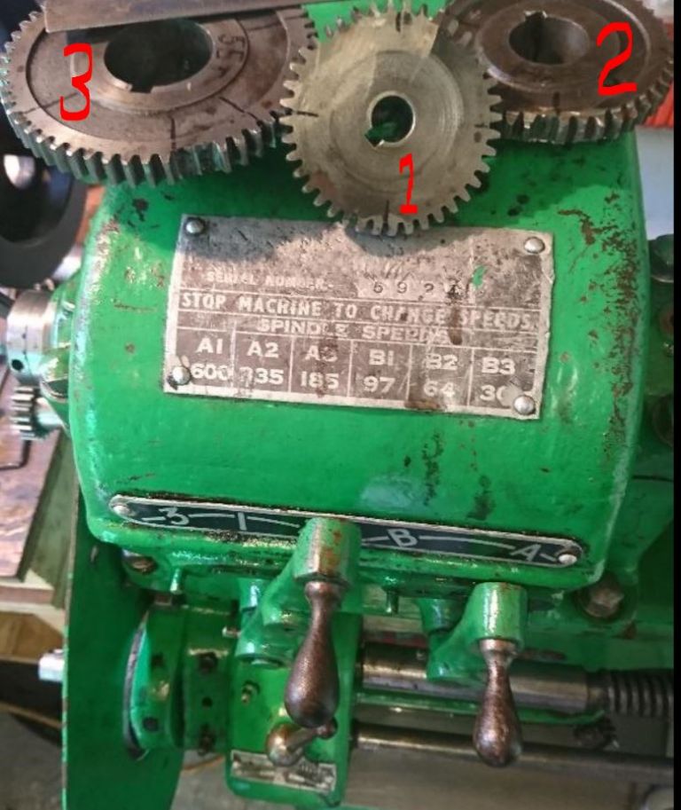

            Thanks Thor. Here are the three new gears in position and the 3 gears I removed.
            Correcting an error about Gear 1 in my "essay" above… I said the back gears are 14DP.. this should say "16DP to match the back gears.." i.e all back gears are 16DP on this lathe, including the driver and driven within the box. The rest of the gears in the box, all those related to the 6 speeds of the Chuck.. Are 14DP.
            HPC gears are 20 degrees pressure angle. I took a gamble on the original box being 20 degrees, which it appears to be. I can't be absolutely sure but putting the gears back-to-back reveals the tooth form is, as best I can tell, the same. I hope this helps someone.

              Hi Brian,
              Thanks for the photos, the old gears doesn't look good. Another old lathe saved I guess.
