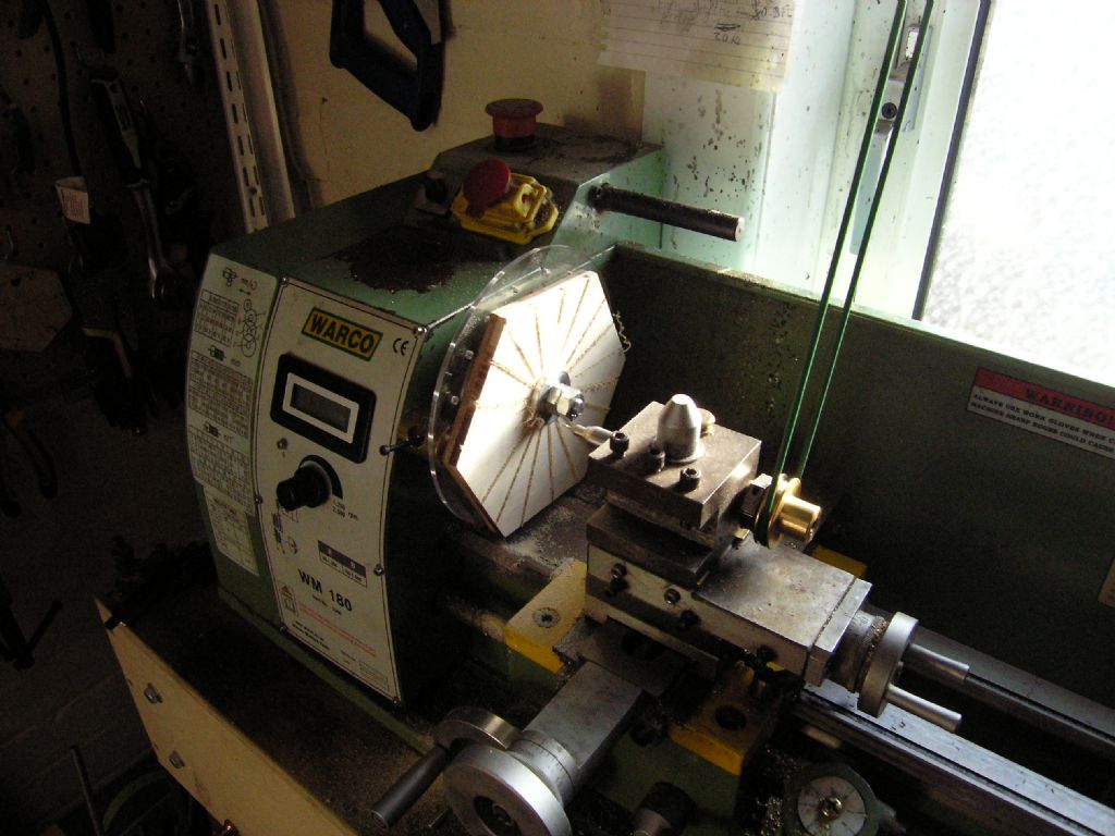

                        Here is a fun image of one of those tasks
