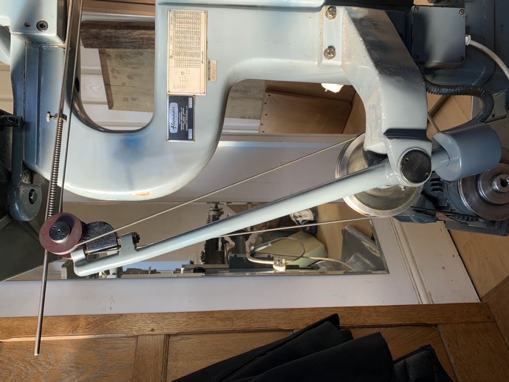

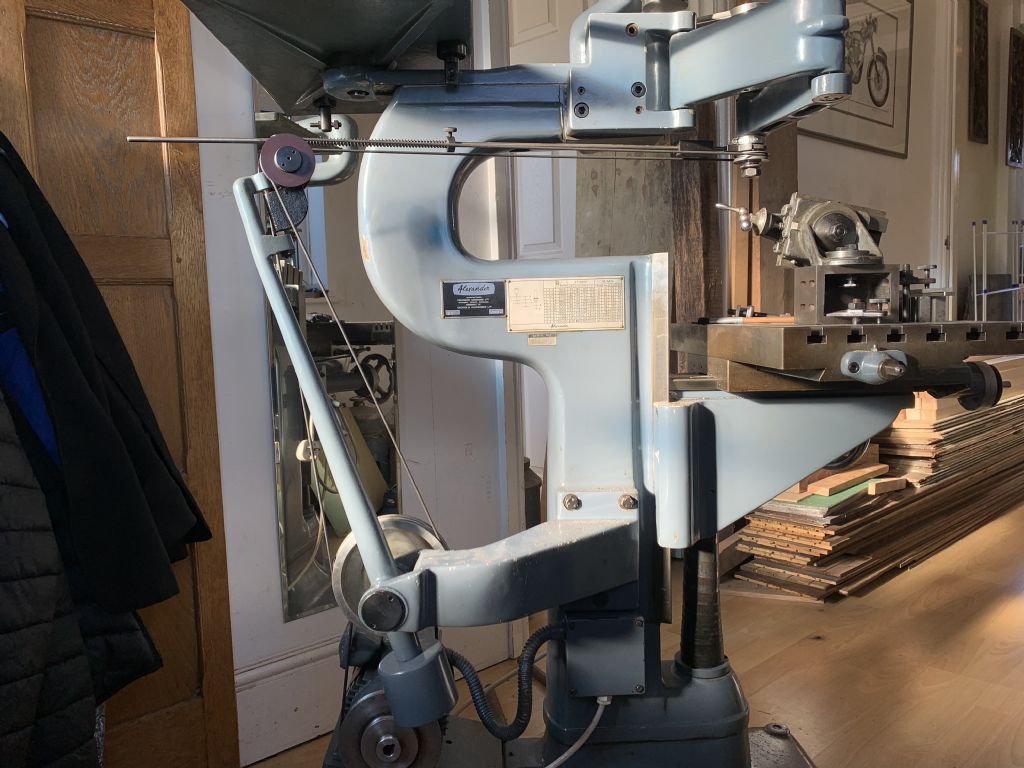

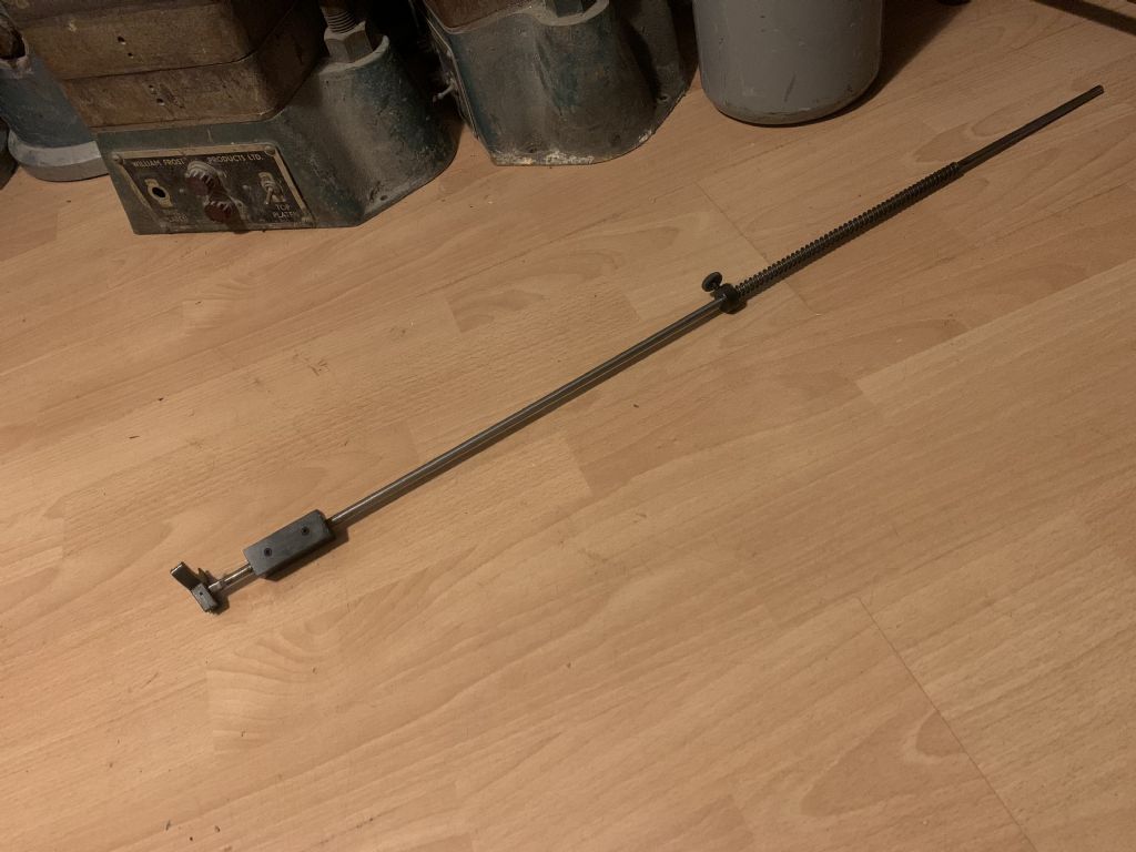

              Not a Deckel but I am the owner of an Alexander 2c engraver, which uses a very similar drive belt tension arrangement to a Deckel: 3f190626-a9b2-4df2-a1d1-23b78920782f.jpeg
              It is a very simple yet effective set up, basically the counterbalanced arm pivots on the bottom pulley spindle. The top pulleys are pivoting on the top of the arm. These pulleys are in turn connected to the spindle via a spring loaded rod, what actually provides the belt tension. I hope that helps, the most important part to me is the arm pivoting on the bottom pulley. Any other query’s I can try to answer, I can get machine out if you require a side on picture.
              (I do apologise for the orientation of the pictures)
              William.

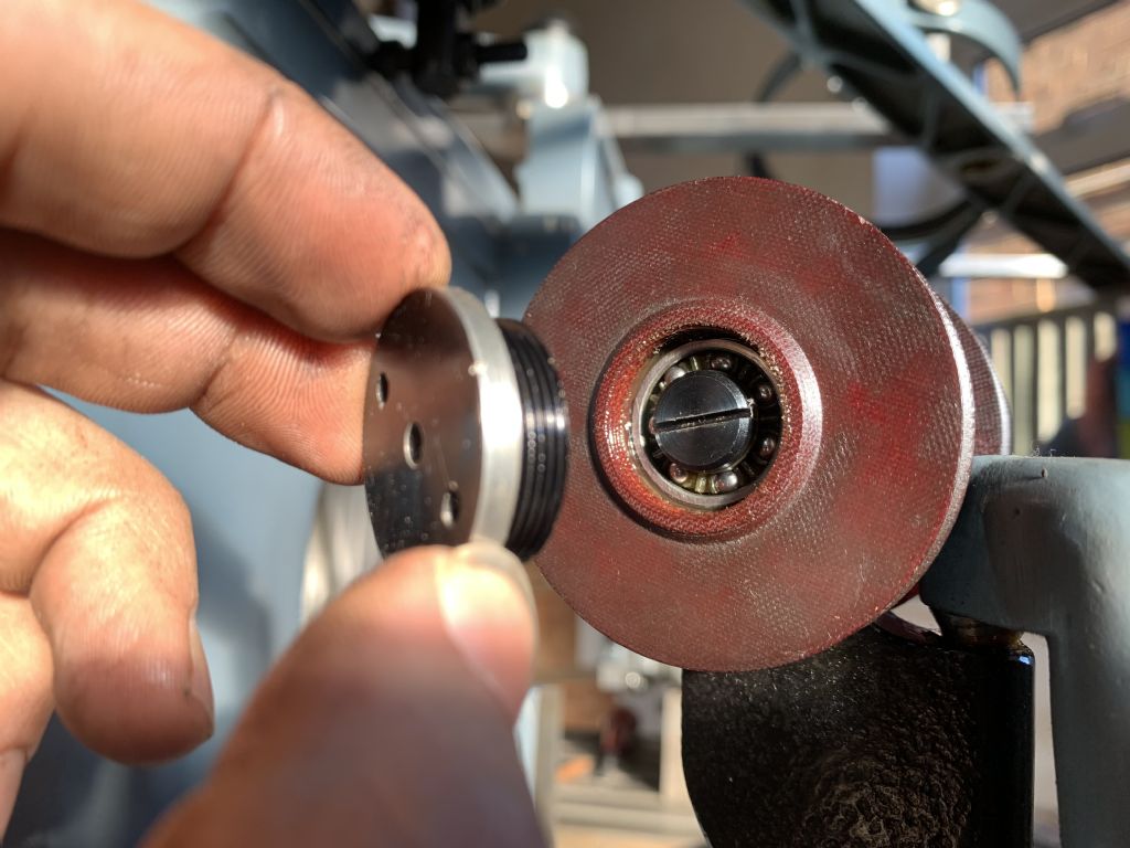

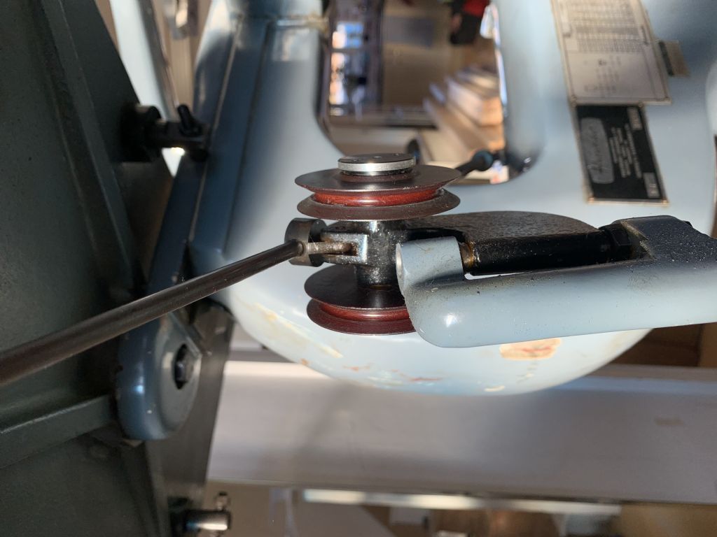

                Wow! Great your Alexander 2c engraver looks similar to Deckel. Possible to dismental/ take photo the twin pulleys with swivel plate separately/3rd photo? The primary function of the plate is to swivel left and right but not up and down movements?

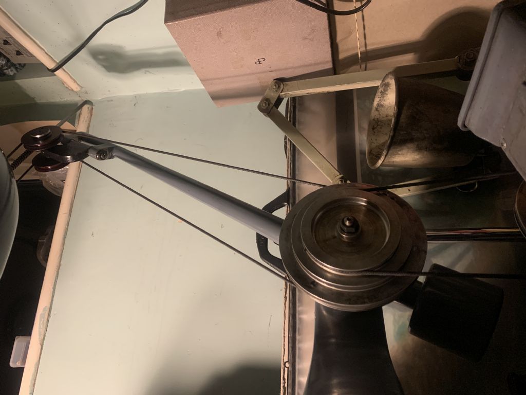

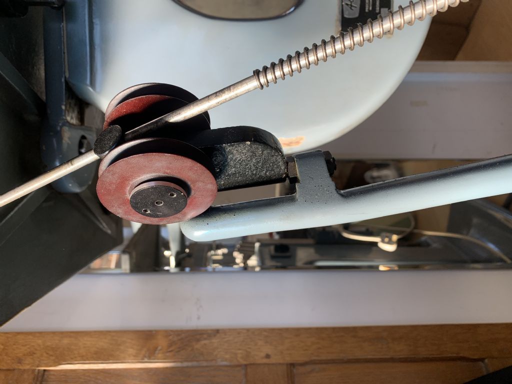

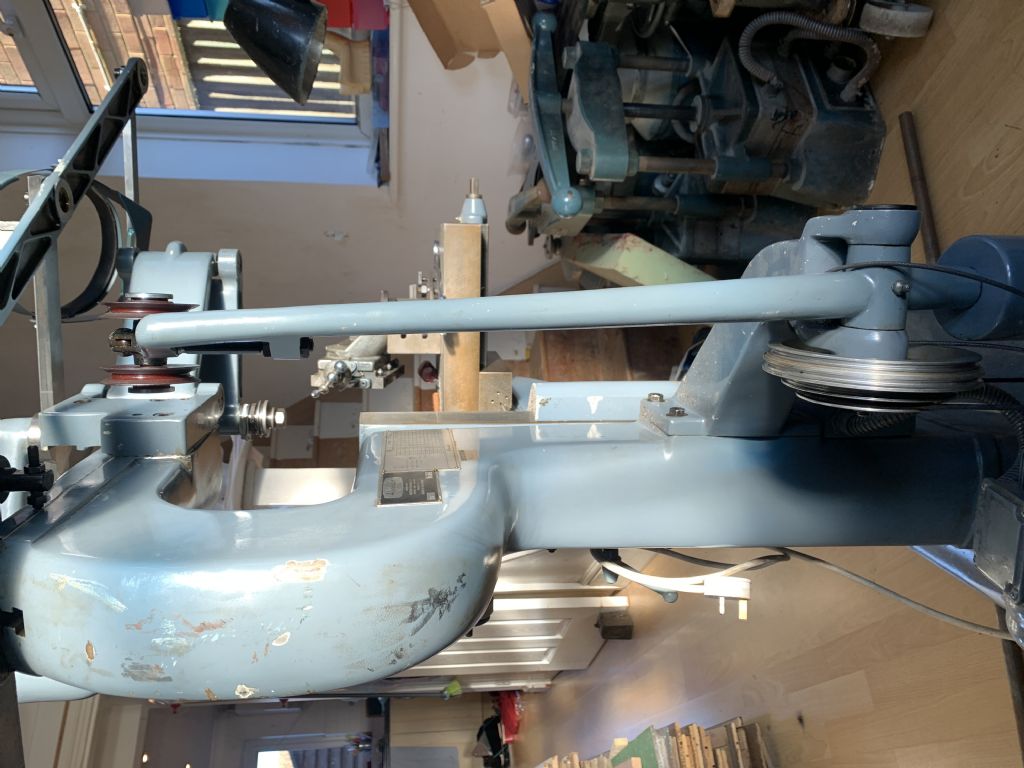

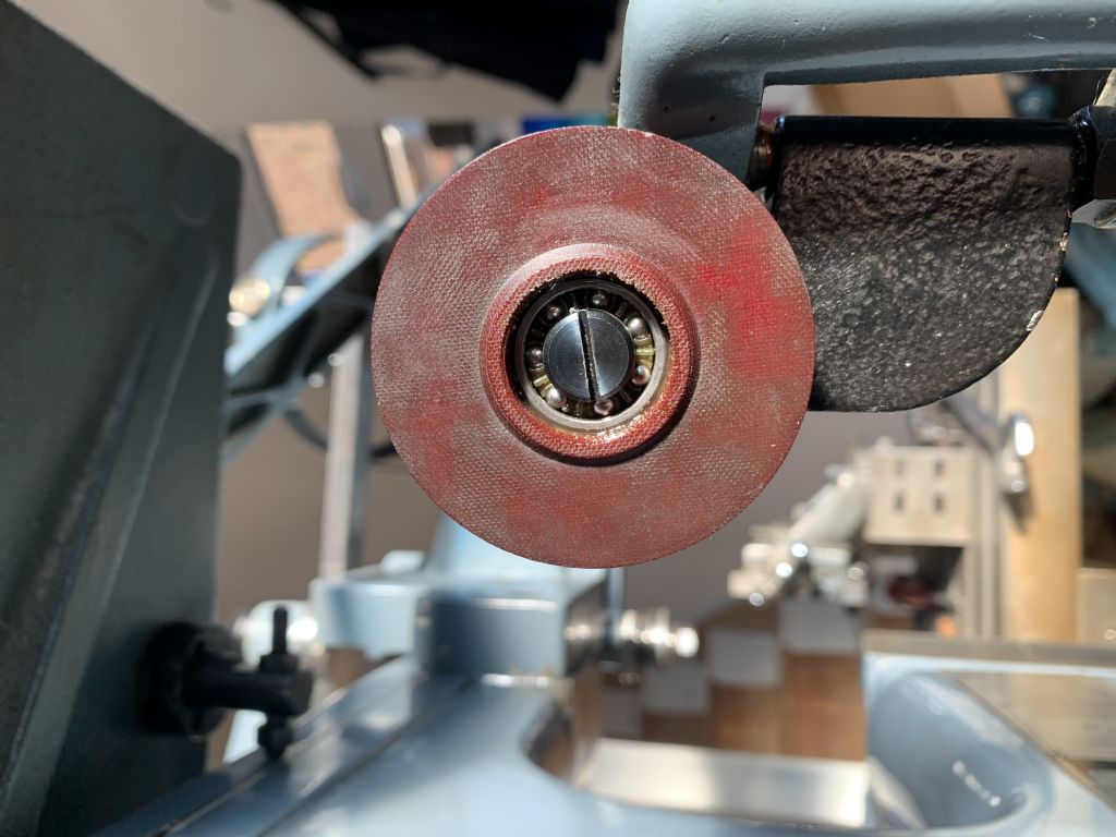

                  The following pictures are of the top jockey wheels, as you thought these swing left to right basically between centres! these do all the work changing direction of the belt.
                  Up and down is only about 1/2" on the "quill"/spindle down feed so the belt just rolls around these jockey wheels
                  The counter balance on the end of the pole I cant say it really does much to the motion, I not have noticed it anyway. the pole swings backward without the belt so It doesn't seem to do much.
