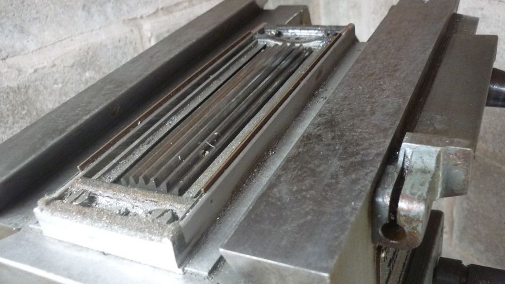

            p1290047.jpgHi Nathan , Got any photos of the machine. I just recently bought an Alexander and im busy trying to find my way around it (what everything does) as its a massive upgrade from a chinese mini mill i have.
            The Alexander is probably very similar. I too am ditching the massive 2 speed 440v only 3PH motor. I have no way of powering it and i dont even know if it works. Im going to use a 2 HP motor with an inverter at 240v 3 PH.
            Even the bracket holding the motor on the alexander weighs around 1/2 the weight of my mini mill.
            Im busy taking bits off it but still not sure what im doing !smiley
            Heres a photo of mine after removing the horizontal headstock is it similar to yours?

                  The article in the MEW # 243 relates to me getting a static converter "tuned" up for the 440V 2 speed motor. I kept the motor bracket, but dumped my motor cover, it increased the depth of the machine by at least 4" as I do not intend to hose the machine down.
                  Frank
