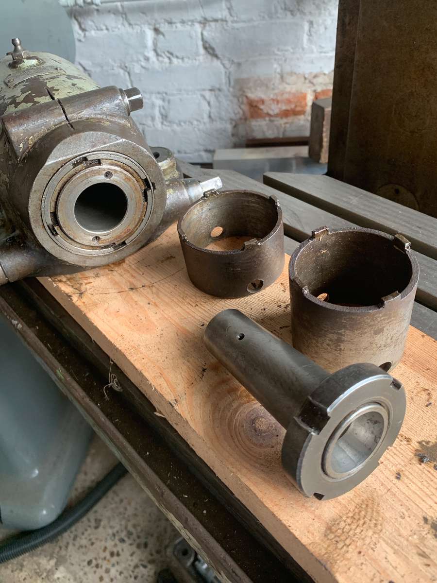

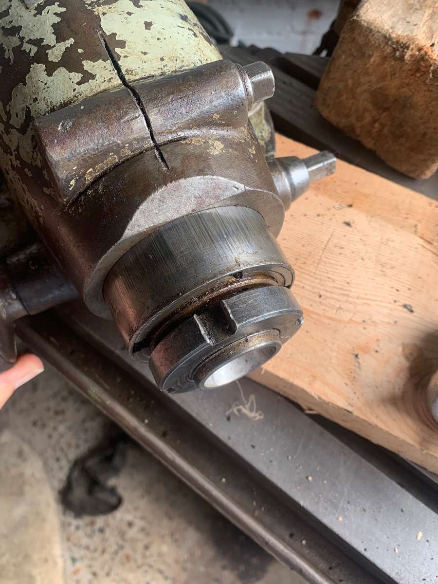

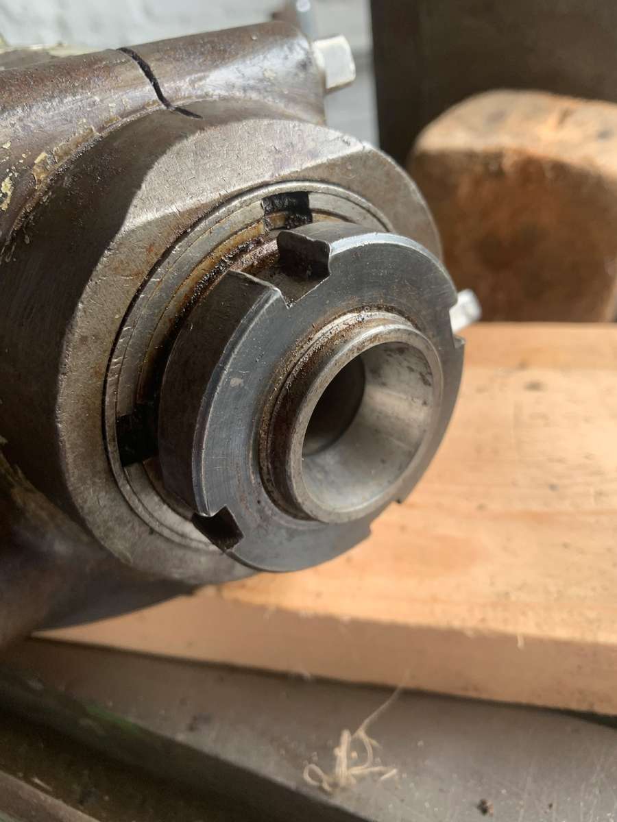

      Hello all,
      I am finally able to start looking at the Deckel FP1 I bought a couple of years ago. It’s serial number is 11462, which from memory makes it a 1939 MK1 model.
      I have removed the front section from the vertical head, to get a better look at the spindle. It appears to be different to the images I see in the internet and different to the horizontal spindle.

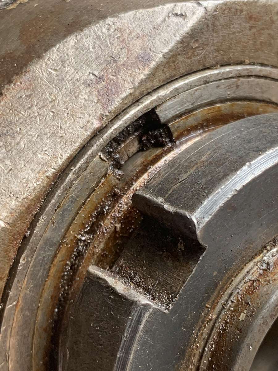

      In the centre is the U2 collet, which has a very abused castellated nut. Then on the outside are two more castellated nuts, one inside the other. The mill came with two spanner heads – on matches the inner collet and the other the outer of the two rings. I can get the outer ring to turn, but not the collet one – mainly due to the damage to the collet.
      Any thoughts on what is going on here? I had expect a MT4 – although I know that the collets can be a nightmare to remove.
      Images below – all and any advice very welcome.
      Thanks,
      James

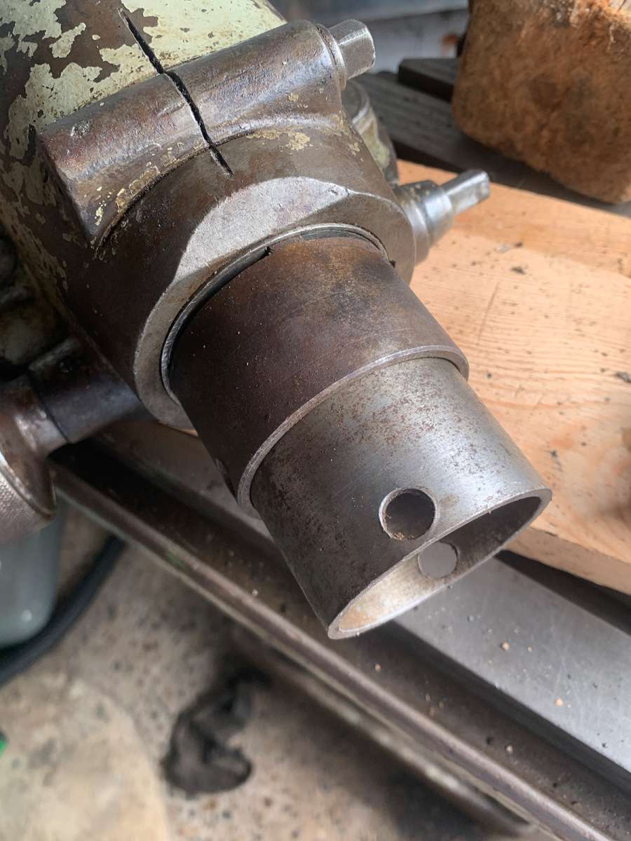

        Coming at it with a bit more intent I fairly easily managed to get the collet out of the spindle.
        Now that smaller castellated spanner fits inside the smaller of the rings. I am guessing that these two provide adjustment for the spindle.
        Collet Removed
