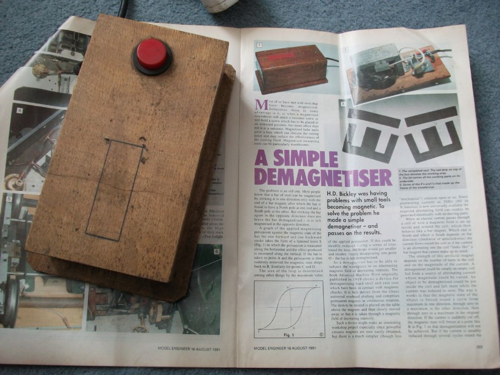

                    I made this unit from the drawings in Model engineer
                    designed by H.D. Bickley
                    Vol 167 no 3903 16 August-5 September 1991.
                    It works very well for small workshop items.

                                  I made this one from the same ME article as John.  I used a power transformer that came from a Peavey guitar amp that had come in for repair. I had replaced it as the thermal fuse in the primary had opened. It had sat around on the floor of the shop  for a number of years as I couldn't make myself throw it out.  I wired the two secondary windings in series (80 and 30 volts) to the power cord (120 volt supply).  Note the two wood strips where I milled slots in the laminations to break the flux lines in the core, milled down til there was about 1/16" of the laminations left. Works great, de-magnetizes even the largest wrenches in a few seconds, also quite successfully  de-magnetized the 4" 3 jaw lathe chuck. The thin Bakelite sheet glued to the top stops the items to be de-magnetized from sticking to the laminations.
