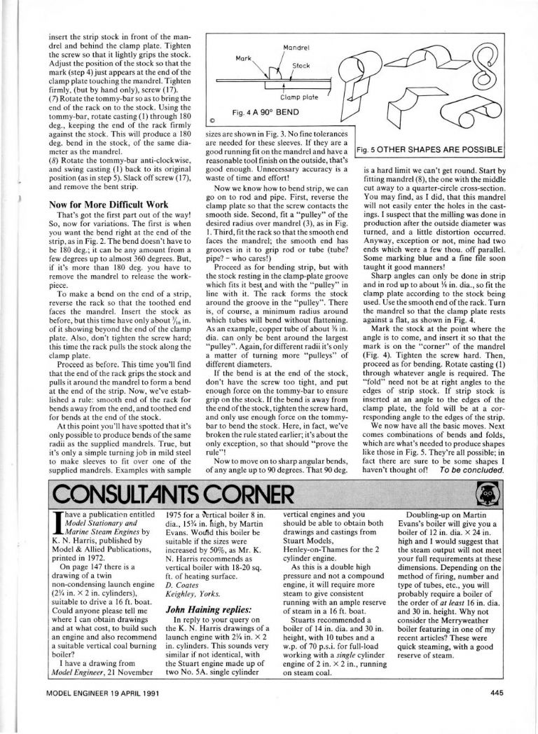

                          If Ady (or anyone else) can email me hi-res scans of the two articles I'll put them up as an 'official article' with a 'rights reserved notice' so no one has to flaunt the copyright.
                          [email protected]

                            All the articles are in my album here
                            My email is a joke and doesn't allow attachments, the articles are in 3895 and 3897
                            #168412
                              Thanks to Gary and Ady1 the full article is HERE
