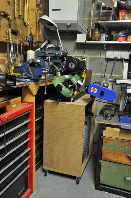

          I've got one, works fine. I've got a bit of a space issue which is why I went for this one. I don't use the stand, I made a wheeled box for it to sit on and I've got my shop vac hiding in the box.

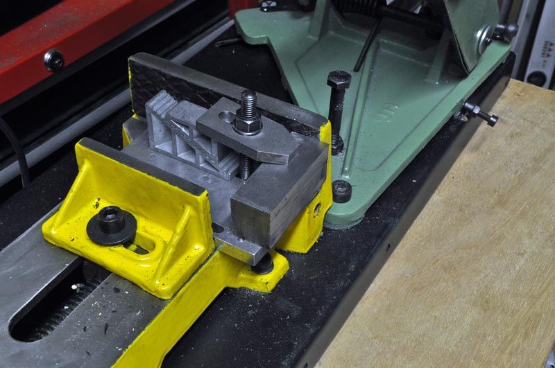

          I lashed up a simple jig to help hold smaller bits than the vice can cope with

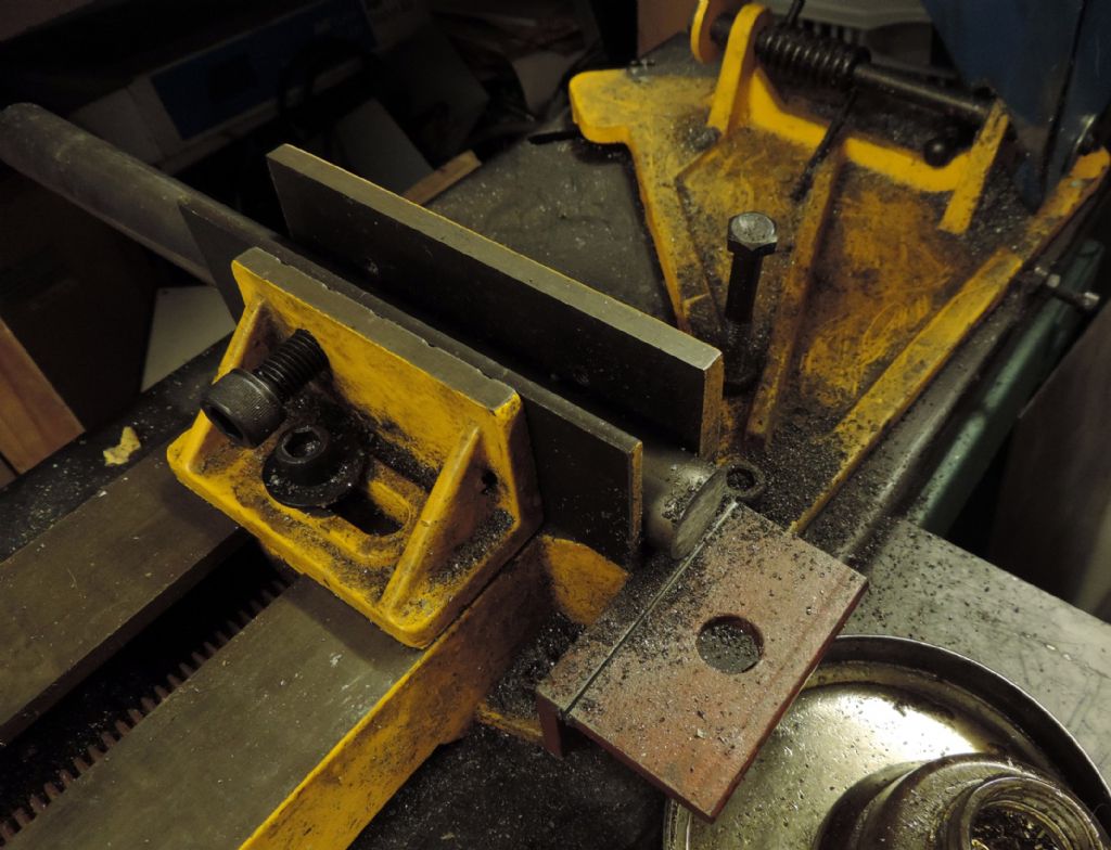

            If you take the plate off the stationary jaw of the vice and fit it to the moving jaw (it doesn't actually do anything other than use up space in the original position except allegedly provide 'better grip' with that chunky diamond pattern) then the vice will hold much shorter stock and closer to the blade. It also adds about 1/4" to the capacity.
            Other mods:
            Fit a bit of angle iron to the bottom of the vice to help support overhanging stock – let the saw cut it's own shallow runout groove in the angle by temporarily increasing the DOC by a mm or two.
            Drill the moving jaw at the far end M10 or M12 and fit a nice long machine screw. use this to balance the grip of the vice when holding short stock.
            can you tell I like to use every last bit of a bar?

                  In case anyone else wants to try these mods but isn't sure what I mean… here's a pic!
                  Shame my saw isn't as nice and clean as Rod's.
