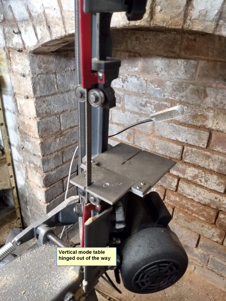

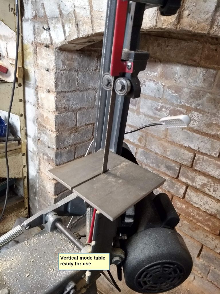

                            Gary Wooding
                              @garywooding25363
                              +1 for the humble 6×4 bandsaw. I got mine quite a few years ago and it's done everything I've asked of it. I made and added a hinged vertical table so I can use the saw in the standard horizontal mode, or, by simply hinging the table down, can use it with the saw vertically.

                                        Posted by Gary Wooding on 13/11/2021 17:54:39:
                                        Looks very interesting.

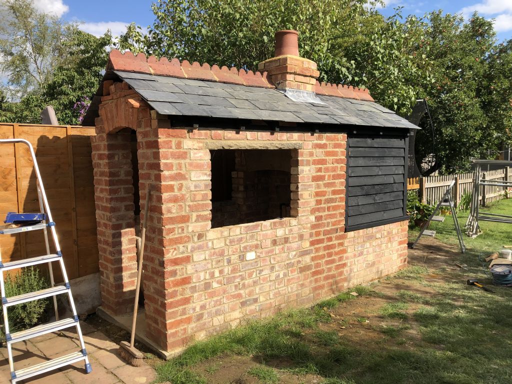

                                        ega
                                          @ega
                                          Steve355:
                                          Love the palace and not the least bit surprised that your saw blade is worn out.
                                          #571194

                                            Steve355
                                              @steve355
                                              Posted by ega on 14/11/2021 00:03:32:
                                              Steve355:
                                              Thanks.,I just had to ge that one in 😎 Never laid a brick in my life when I started, never wanted to lay another by the time I’d finished. That was the summer of brickwork, then I had a year learning woodwork, now I’m having a go at metalwork. All good interesting stuff.
                                              #571198
