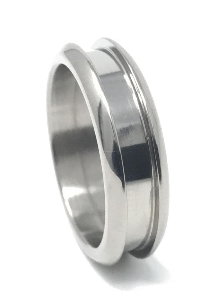

                              Okay, have managed to get a photo of something similar to what I am planning to create.
                              This is actually a two piece titanium ring base with screw thread to connect the one side flange but gives a visual representation of the sort of thing.
                              At this point, I stress the point I am not looking to work with titanium nor create screw threads, but to create this as a one piece item in stainless. On some designs there would be two inset channels rather than one, but hopefully you guys will see what I need to machine.

                                  Will for something like that you would also need a parting tool I suggest insert type or combined parting/grooving to cut the central recess which I assume is filled with resin or other metals. The advantage of the combined tool is that you can also get half round ended inserts which leave a nice internal fillet
                                  The convex outer edges could simply be shaped with a file held against the work as it rotates after a few roughing cuts to remove the excess. You could also grind up an HSS tool with a concave cutting edge that would do the job and may be better if you have a number of similar rings to make.
                                  I would tend to do most of teh external shaping while still on the end of a solid bar, then drill and bore to size before parting off (use same parting tool as above) Then mount on your mandrel for final finishing and polishing.
                                  #431344

                                      Thanks Jason. The angles at the top edge of the ring going from the inset outwards are just regular bevels, it is the reflections off the material that makes them look rounded. There is also a tiny bevel on the edge of the inner surface of the ring to prevent the ring edge digging into the finger.
                                      At the moment my thought is to buy a small set of insert tools, preferably with a boring tool and insert, but also get some HSS blanks to create my own tooling as well. Whilst many of you guys have perhaps decades of experience and can create tools for any job imaginable, for those of us new to lathe turning, it is a little more challenging. With my CNC mills, I buy stock cutting bits and if they get broken just buy some more, but I appreciate that lathes are a whole different ball game and it is possible to create some really bespoke tools.
                                      I do take on board all of the comments that people have made and have gained a lot of insight from this thread. You guys are incredibly helpful and I appreciate the time that all of you take to help newbies like myself.
