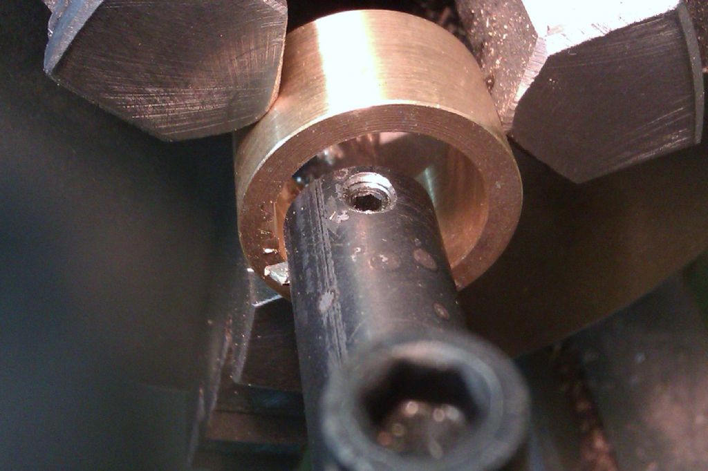

                  If you can draw out the gear profile then grind a tool to that shape and use the planing method in the lathe, you don't need the straking tool it can be done by using the carrage handwheel, the setup would be similar to this
                  The other way is to make a broach similar to a spline broach which is pushed through a ring cutting the teeth as it goes

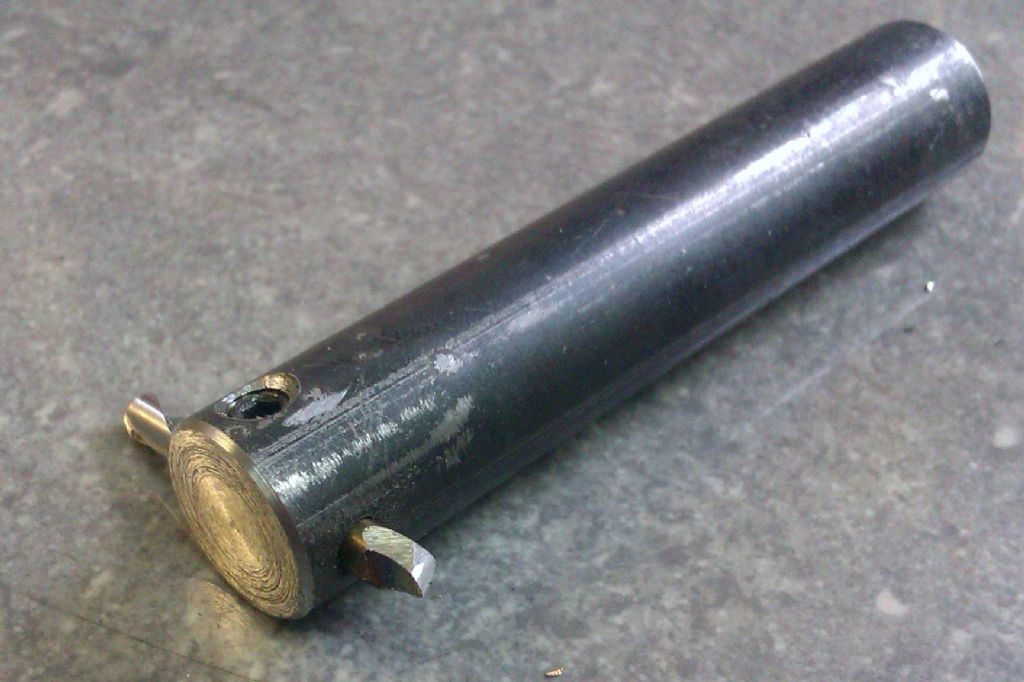

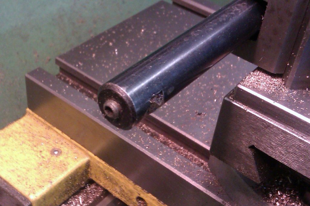

                          Becky, the tooling is quite easy to make. You just need a short length of bar say 1/2" dia, cross drill the end say 1/8" to take a HSS tool bit or even a broken centre drill and at right angles to that hole drill and tap for a grub screw.
                          The screw can alternatively come in from the end
                          You then just need to have a way to index the work for the number of teeth you require, move the carrage back and forth feeding in say 0.005" at a time until the tooth gap is formed, rotate round to the next one and repeat. These three took me about 60secs.
                          I notice from your album you do a lot of work in Aluminium, I would suggest brass for the gear as its easy to work, those ones needed hardly any effort to cut. You just need to grind the end of the cutting tool to match a printed out profile of your gears.
                          You can also use the same method to cut keyways if you do't have a suitable broach, just grind up a square ended tool
