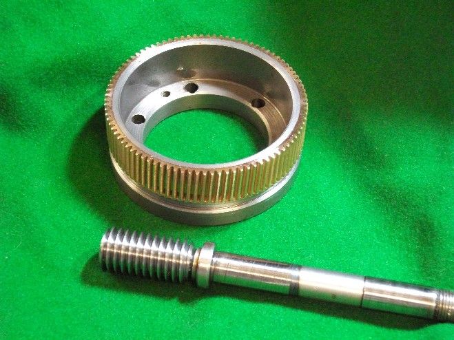

                                        Looking though Ivan Law's book gears and gear cutting on page 97 and the adjacent pages
                                        provides some explanations on the pitch of worms.
                                        It would not be of any use to be able to cut a worm exactly the pitch to suit the CP of the gear
                                        (assuming that this is to mesh with a spur gear) since the worm has to be set over at an angle
                                        in order to mesh with the gear.He does make the point that if the helix angle is low about 3 deg the
                                        difference can be ignored.
                                        However by adjusting the helix angle in this case to 6.9 deg the figures work out to the 3.165 mm
                                        or .1246 inches .
                                        As described in the book dividing the circular pitch by the cosine of the helix angle of the
                                        worm to obtain the new pitch CP 3.14 mm or .1237 inch divided by cos 6.9 deg = .1246 in
                                        or 3.1649 mm ,at these figures the worm would be .328 inch PCD , .407 inch OD .
                                        It just depends if you can live with the 7 deg set over and the root diameter of about .240 inch .
                                        I don't screw cut worms anymore , i mill them the finish is much better along with a cnc system
                                        the pitch can be adjusted over many teeth and along with the control with rotation any size or
                                        pitch can be achieved ,the same basic parameters need to be observed in respect of lead
                                        helix angle and pcd.
                                        Here is a 1 module worm and hobbed gear at 90 to 1.
