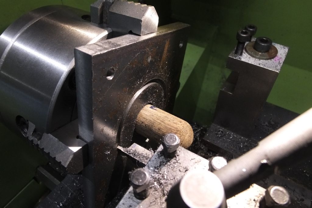

      Hi All, I am trying to cut out a 60mm diameter hole out of a piece of 12mm mild steel plate.
      The piece is set up in the 4 jaw chuck on my WM250 lathe and I have ground an HSS tool to cut a slot.
      The problem is the tool starts to cut but then digs in and stalls the lathe.
      I have tried grinding different angles on the tool cutting edges and adjusted the tool height but have not managed to solve the problem.
      Any ideas anyone?
      Perhaps a trepanning tool might be the answer?
      Many thanks for any suggestions – Chris.

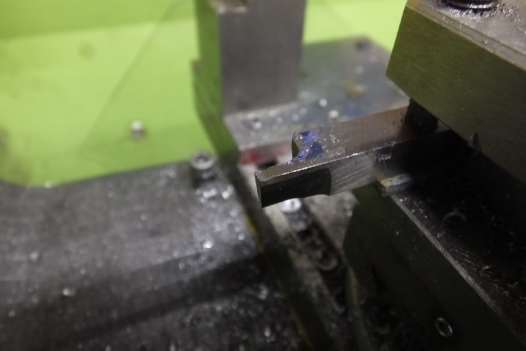

          You should be using a trepanning tool with a radius on the front to clear O.D curvature, & some side clearance too… hence your 'digs in & stalls the lathe' scenario. there was a thread not too long a go about trepanning some thin material, with an accompanying sketch of the tool, can't locate it at the mo'… maybe another member could point you in the right direction…
          George.
          #200266

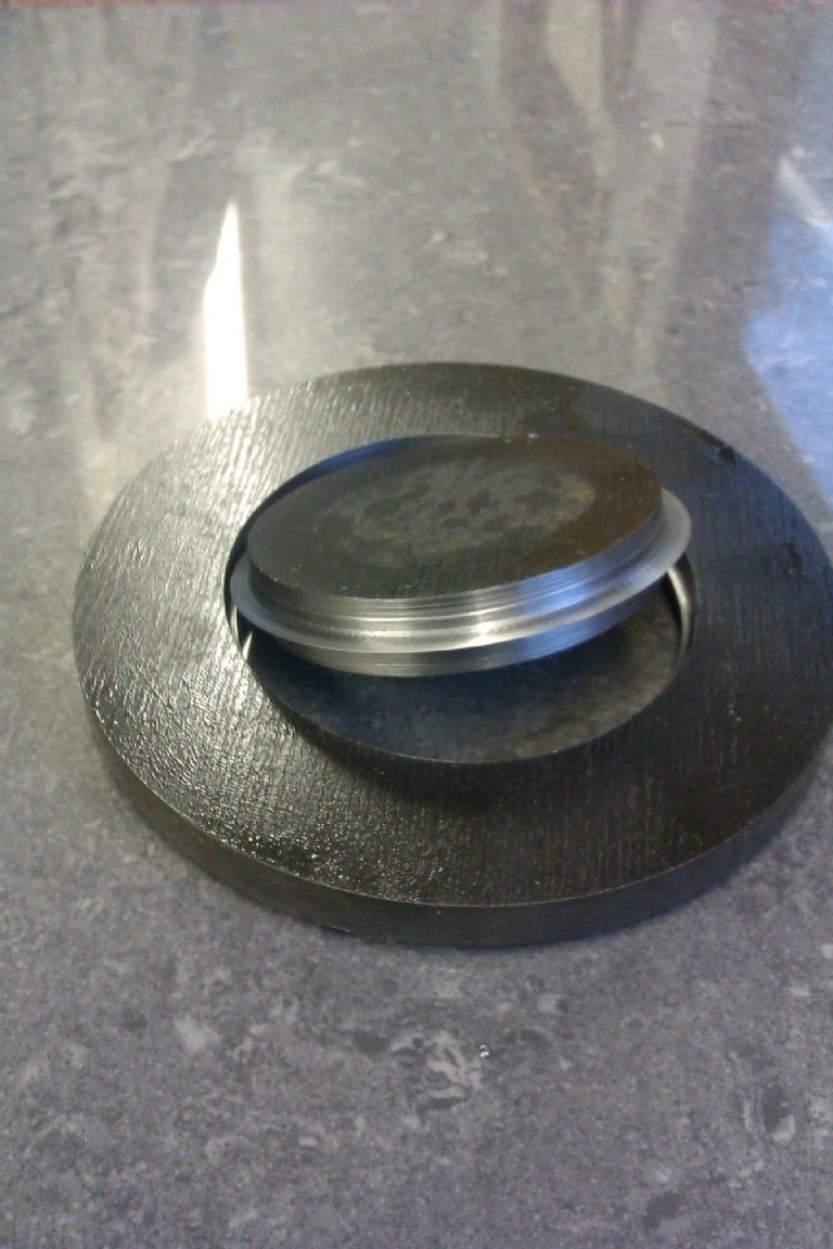

            Make the tool a bit narrower with a rounded tip and move it say 0.050 across the work and back while slowly advancing the cut. Go 6mm from each side. This way you have less tool in contact with teh work and no risk of teh sides rubbing.
            This is a similar size hole in 10mm plate
            The safest way is to actually stop a few thou short of half way and then just hit teh middle and it will open up like a bean tin, no waste piece to fly about and catch something on teh lathe

              That's about as demanding a cut as you can expect any lathe to make. I think your tool need sharper corners and relief right up to the outside cutting edge – it's whole profile needs to be able to fit inside the slot being cut.

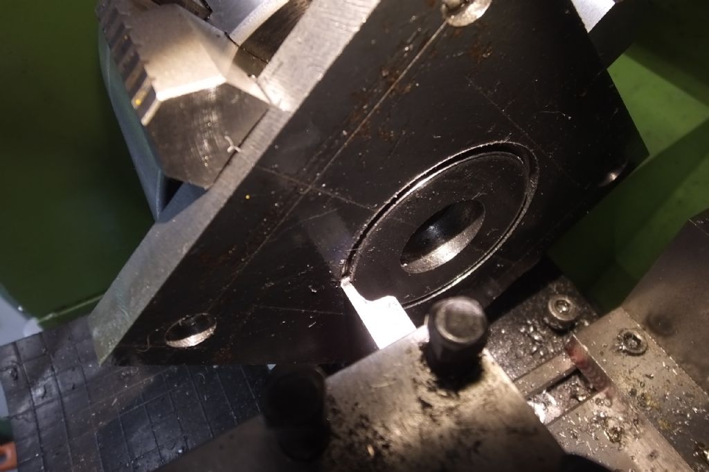

                    I use a tool something like this but cutting tool length and narrower with and increased angle on the end so that the point can be plunged into the work.
                    it can be used to "face and bore" through material. I've not tried it on anything of your size but it's what I would use.
                    Looking at the shot you posted I think I can see signs of the tool rubbing on the outer edge. You need a rad on that side of the tool that is smaller than the diameter of the hole you will be left with.

                        I would take a cut at the max dia using a tool similar to a parting off tool, about 1/8" wide until it becomes uncomfortable then withdraw and move the tool inwards towards the centre approx.. 1/8" and machine to the same depth then withdraw and move back to the outer dia and continue using this method until I could not proceed with this tool ,then change to a thinner tool and continue as before.

                            John W1 – "Looking at the shot you posted I think I can see signs of the tool rubbing on the outer edge." –
                            I have radiused that edge but my hand grinding technique is pretty poor and you can probably see signs of my own inadequacies in that department.

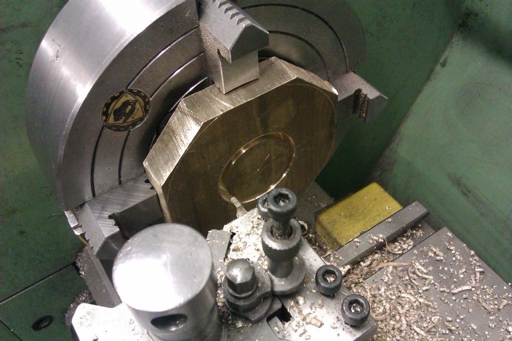

                                Found the other photo I was looking for, this is 5/8" bronze. You can see that as well as curving the outside edge of teh tool I have a radiused end and that the kerf is wider than the tool where I move it back and forth across the cut. Not quite so easy to see is the width of the tool narrows slightly as it gets towards the main square body to the sides are less likely to rub. Click image to see it larger

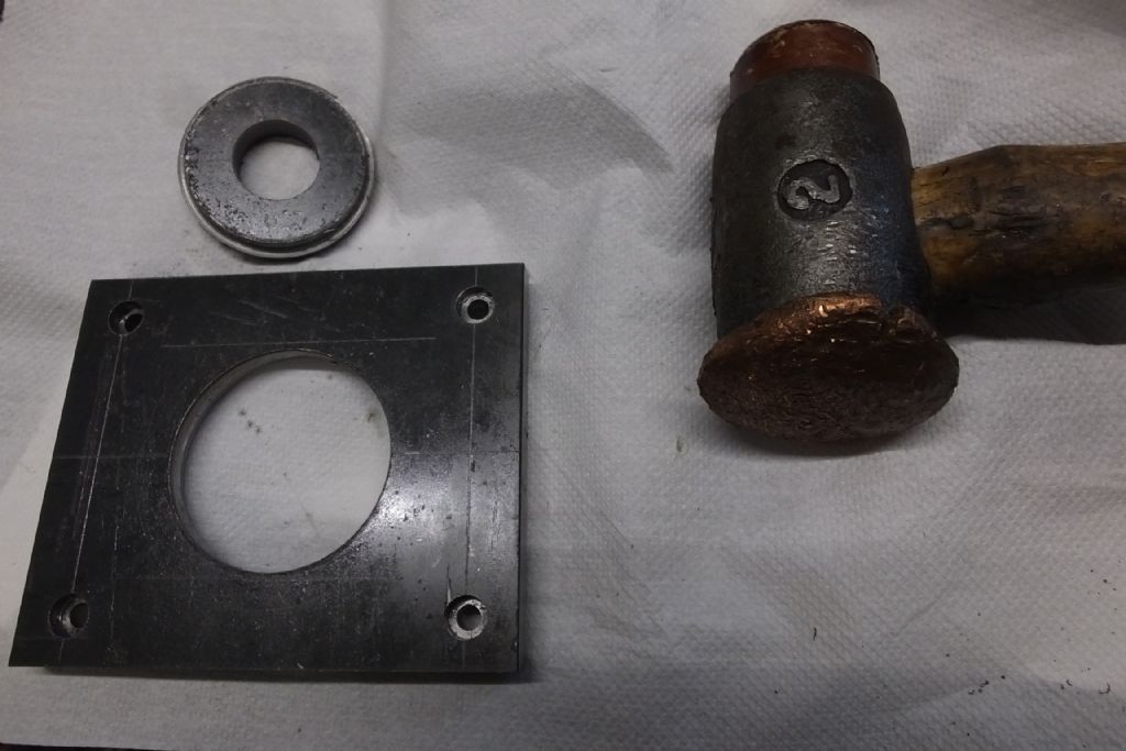

                                            There you go, it works!
                                            Thanks to all for the suggestions.
