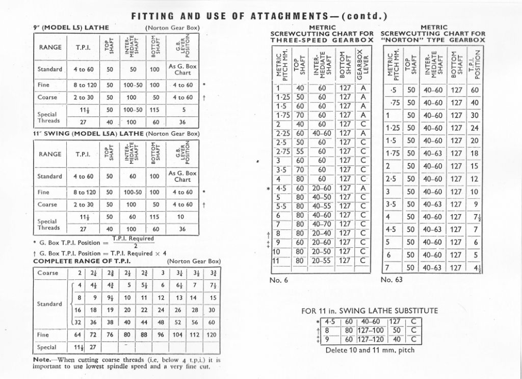

My calculation was for a straight through 1:1 which is most likely B which now being a 4tpi screw would give a cut of 7tpi, if so A would give half the rotation so that will be 14tpi and C will give double or 3.5tpi
I assumed 40T spindle so
1:2 lever position 0.5 x 0.571 x 0.25 = 0.071 = 14tpi
1:1 lever position 1 x 0.571 x 0.25 = 0.143 = 7tpi
2:1 lever position 2 x 0.571 x 0.25 = 0.286 = 3.5tpi
If a 20T spindle
1:2 lever position 0.5 x 0.286 x 0.25 = 0.071 = 28tpi
1:1 lever position 1 x 0..286 x 0.25 = 0.143 = 14tpi
2:1 lever position 2 x 0.286 x 0.25 = 0.286 = 7tpi
Fizzy, can you post a picture of whats left of your chart just to be sure
