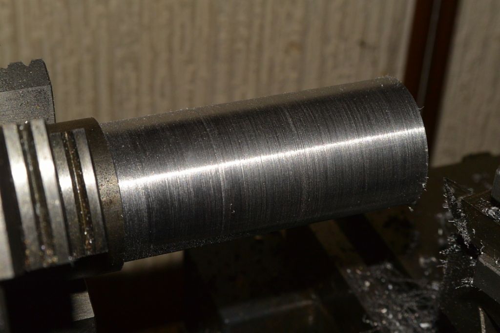

      I don't usually bother trying a lathe with a loose cross slide but did for a change. It's a piece of ordinary 1 1/4 dia mild steel.
      With a roughing tool lathe as received. Loose as usual.
      Same tool after the both the cross and compound were set to be a little firm at the handle. Much more even tearing now.
      Then a quick run over with a micro polished TCGT 11mm indexable tip
      surprise No the work hasn't turned in the chuck by the way. It's down to how I put work in it.
      4 similar sized cuts.

          I always now have the cross slide nipped up unless I am using it for a short taper.
          Much improved general performance on the lightweight lathes that us hobbyists often use. – Especially noticeable when parting off.

                I just have the compound slide a bit tighter than the cross slide and find I can still get an even feed with it. Some might find it too tight though.
                The tips are TCGT 110204 ALU AK10 from apt carbide. They are micro polished rather than coated, Think you will find that they are listed for aluminium and finishing stainless. They do several similar tips but bear in mind the bearings on the lathe do seem to be perfectly adjusted. That can make a big difference all on it's own. The cross slide was tending to move around during a cut initially and the roughing tool I used only has a very tiny tip rad.
                I've used these previously which will also give a good finish but find that the coating wears off and hope that the micro polishing extends the life.
                I prefer V nosed tools when they can be used as they will cut both ways, work up to a shoulder and face but the only holders I have found for them is as above in the 10mm 3/8" cheap sets. The ones i have use hex grub screws which are a complete pain compared with torx. APT look like they have some but they turned out to be for 16mm tips.

                                The tool needs to be angled suitably for maximum performance Lynne. In other words when bar turning in the normal direction the tool should be angled towards the chuck. This is to reduce the effective depth of cut. I don't usually rotate it by 30 degrees so that the cutting edge is square to the work as it would be if a bar turning tool was being used.
                                I'd say I generally angle it around 1/2 of that and also use it just pointing forwards.
                                To face a shoulder it needs to be rotated more than 30 degrees towards the shoulder and also when facing the end of the work. The tip rad if I remember correctly is 0.7mm so when a shoulder is faced it can be plunged into the work to remove the radius that would be left avoiding having to fit a grooving tool of some sort most of the time.
                                The basic shape is a very old idea that was often ground on HSS toolbits but with a more acute V. Usually called a general purpose bit – the one to use for a mix of things. These will even cut both ways even though rake is negative going in one direction. It isn't on the indexed inserts.
                                The only penalty really is facing – it can be difficult to get the tool edge anywhere near square to the cut when facing the end of work so only a little can be faced off per pass unless the tool is reversed in the holder. They also don't seem to like facing from the centre out. A common trick on larger lathes to get nice shiny ends. Due to the cutting edge angle to work the depth of cut is increased rather a lot so the extra force takes out play in the machine.

                                    It's mostly down to be able to set the gibs correctly Chris – on all slides that are adjustable but as I mentioned loose headstock bearings will also mess things up but usually if that is reasonable deeper cuts help and fine ones cause poor finish. What deeper means will vary according to the lathe. Faster feed can help too but there isn't much scope for adjustment on mini lathes etc.
                                    Materials vary too and in this case as it's bright drawn mild steel the often hard stringy outside has been removed. Black bar often turns better.
                                    I set the slides via the handle but really it's best to remove the lead screws, oil things up and adjust while pushing about by hand. There should be some definite resistance to movement. Not hard resistance but needing a bit of effort to move the slide. Play in the leadscrew shouldn't really matter then. Some lathes can be adjusted more loosely than others but generally they are always set too loose.
                                    I would suspect that any shape of carbide tip with the same sort of rake design on them would give the same finish. This style is also cropping up on milling cutters now. In this case I like the idea of micropolishing rather than coating as coated inserts do produce a poorer finish when the coating wears off. I'm hoping that they will last longer.
