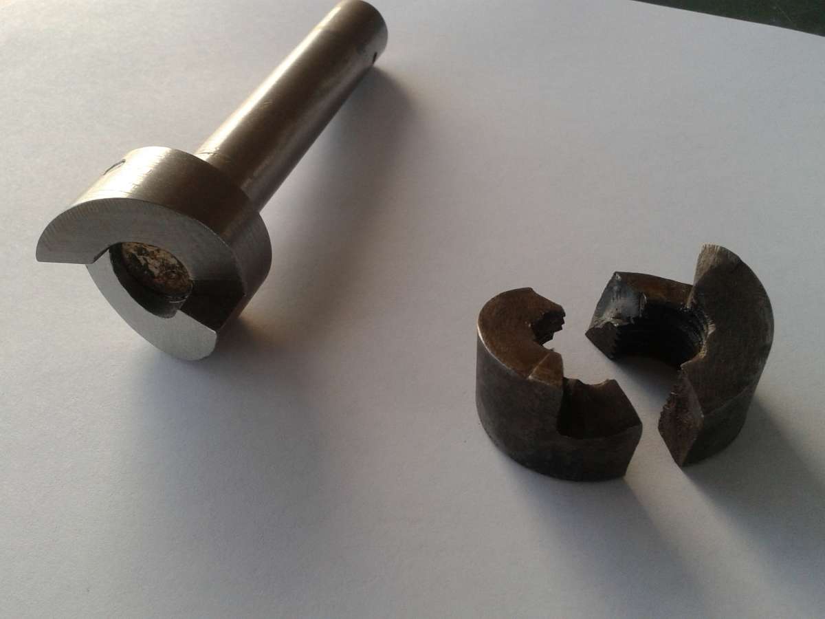

            isn’t it a job for the rotary table / dividing head which is set at the angle of the slope?  A bit of careful milling as the face of the slope is perpendicular to tilted axis. This is one I made for the start dog of a vintage car.

            Hopper
              @hopper
              Yes machining it as one flat face like that is much simpler than dividing head geared to the table travel. It won’t be a true helix, but neither is the filed version so it will work just fine for this application. Looks like a nice job there too.

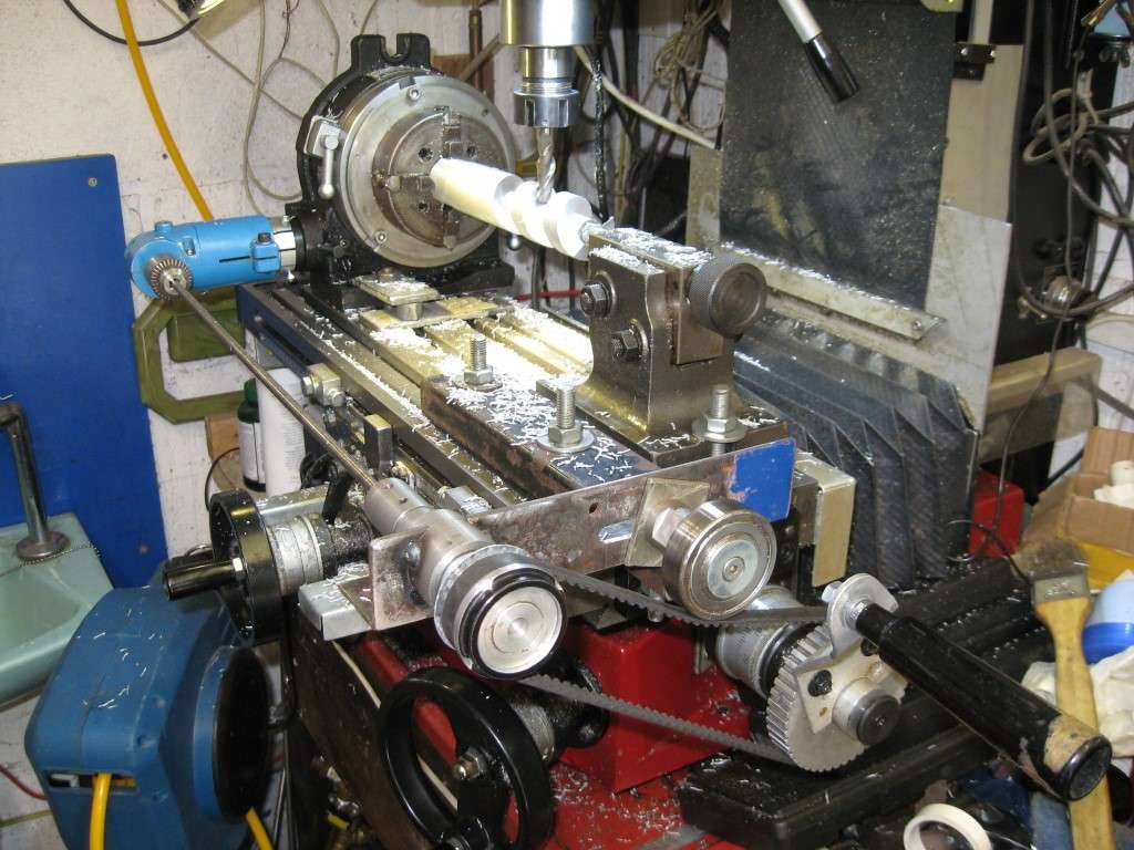

                  You could a setup like this that I used to cut a helix.
                  IMG_1615 (Medium)
                  The right angle drive was for a drill.  You just need to work out the gearing to get the correct pitch helix.

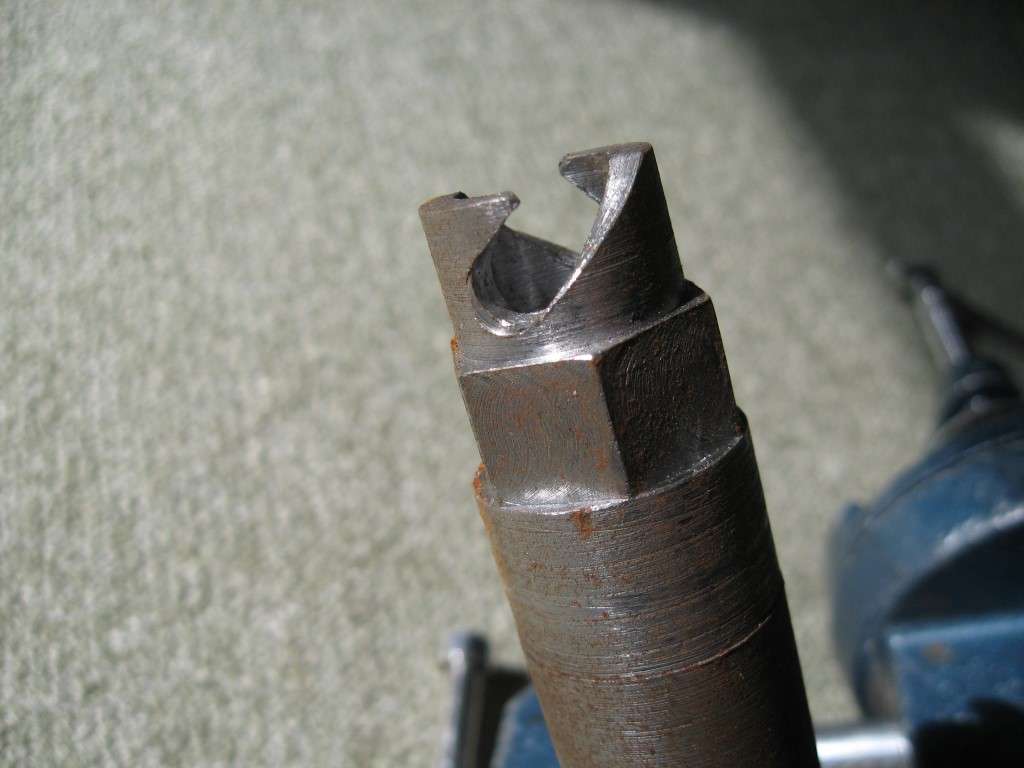

                  I also used this type of setup to make this drive dog.
                  IMG_1963 (Medium)
                  To get a sharp corner you would need to use a small diameter end mill and undercut the end slightly of finish the radiused corner with a file.

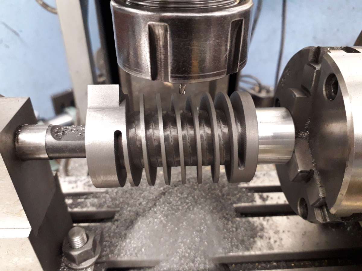

                      If it is the physical cutting then holding the work horizontally in a rotary table and doing a series of plunge cuts to calculated offsets will also produce a spiral, faccet size just depends on what increments you choose to use. You can get quite good spirals that way, a bit of needle file fettling to finish.
                      20181228_193117
                      20181229_153728

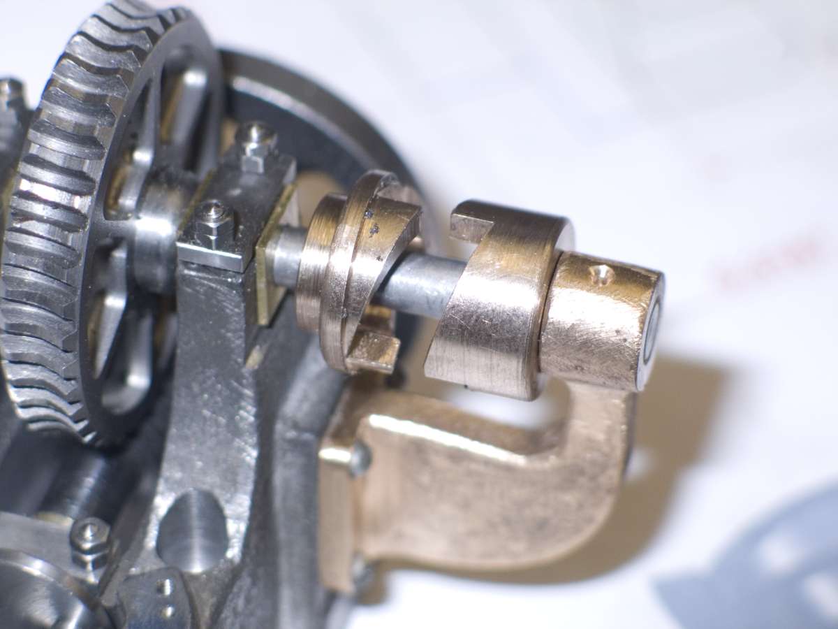

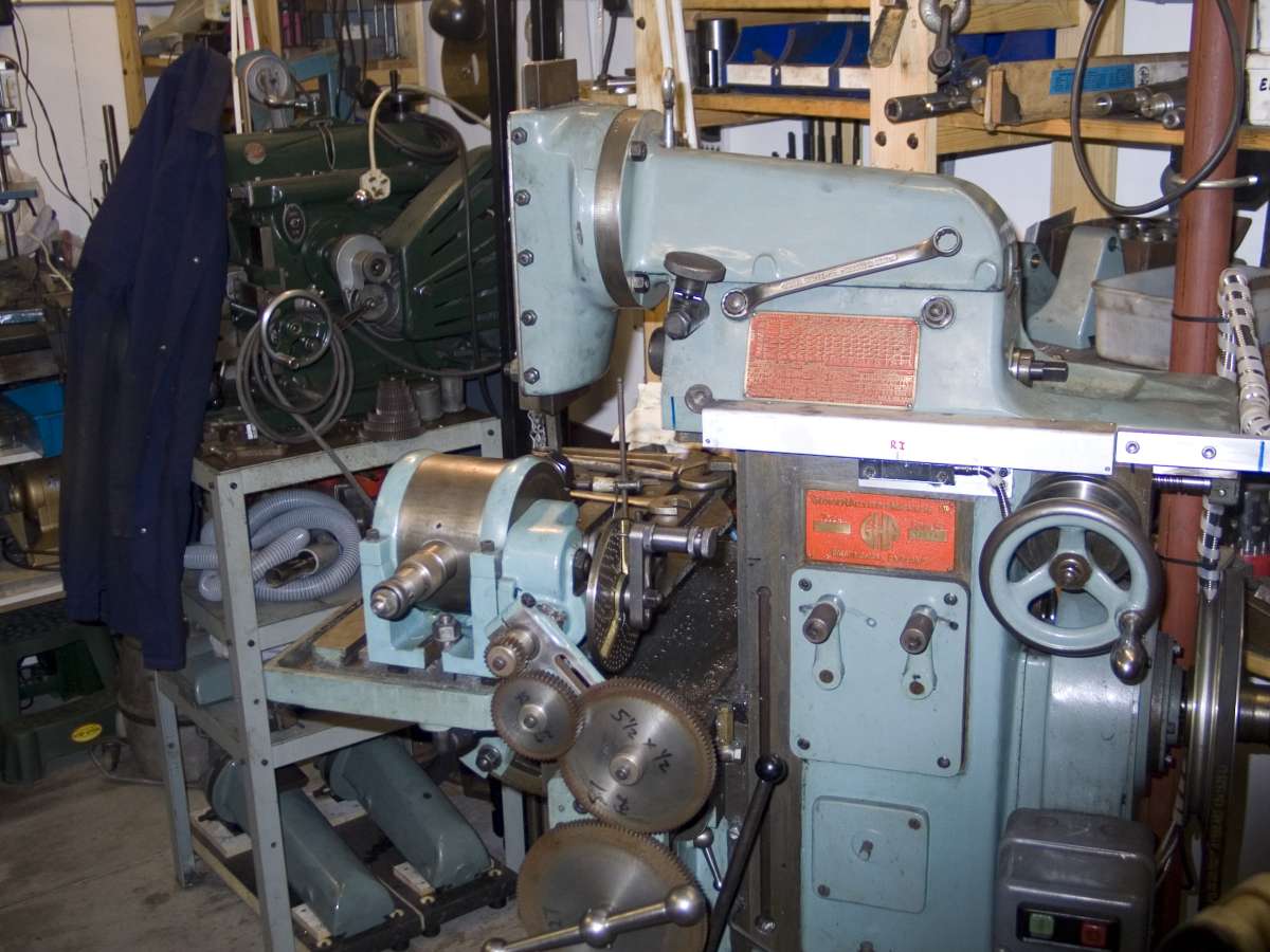

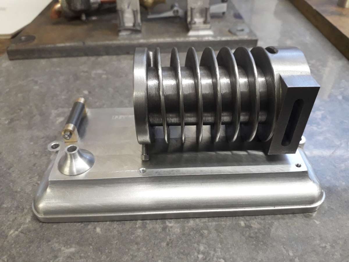

                          I made a clutch release dog with three lobes for a model barring engine.
                          I used a slotting head and geared the dividing head to the table traverse on my milling machine.
                          Barring Engine 016 14-08-16
                          Barring Engine 012 14-08-16Barring Engine 009 14-08-16

                          DC31k
                            @dc31k
                            If you could accept a bit of filing, you could do the same but with mathematical gearing instead of mechanical gearing between leadscrew and dividing head.
                            Work out the table advance per degree of revolution and proceed from there.
                            One degree of revolution is 360 divisions, so you could do the inverse – work out how many divisions of the full circle would result from 0.005″ linear steps of movement and pick a plate and hole circle to suit.

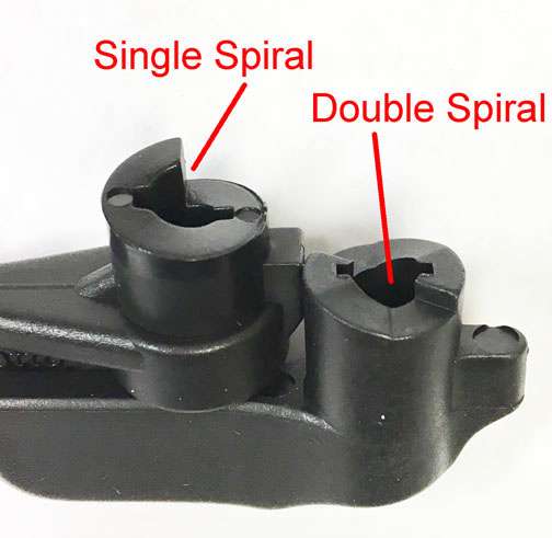

                            #745264
                            Chris Cooper
                              @chriscooper5
                              I should have mentioned that its the one on the left of the pic I want. I can get them 3D printed, but I was just curious to see if I could make one.
                              I don’t have a lot of the gear mentioned in the answers.
                              It is just a camera tripod locking lever so probably doesn’t have to be exact.
